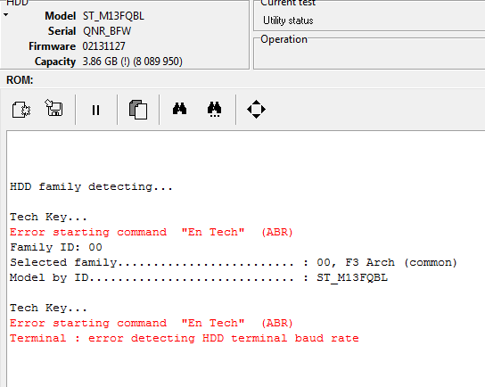

Anyone can help me fix the capacity of this HDD ?

SA can not read and ID values load from ROM. Could be heads or media damage.
