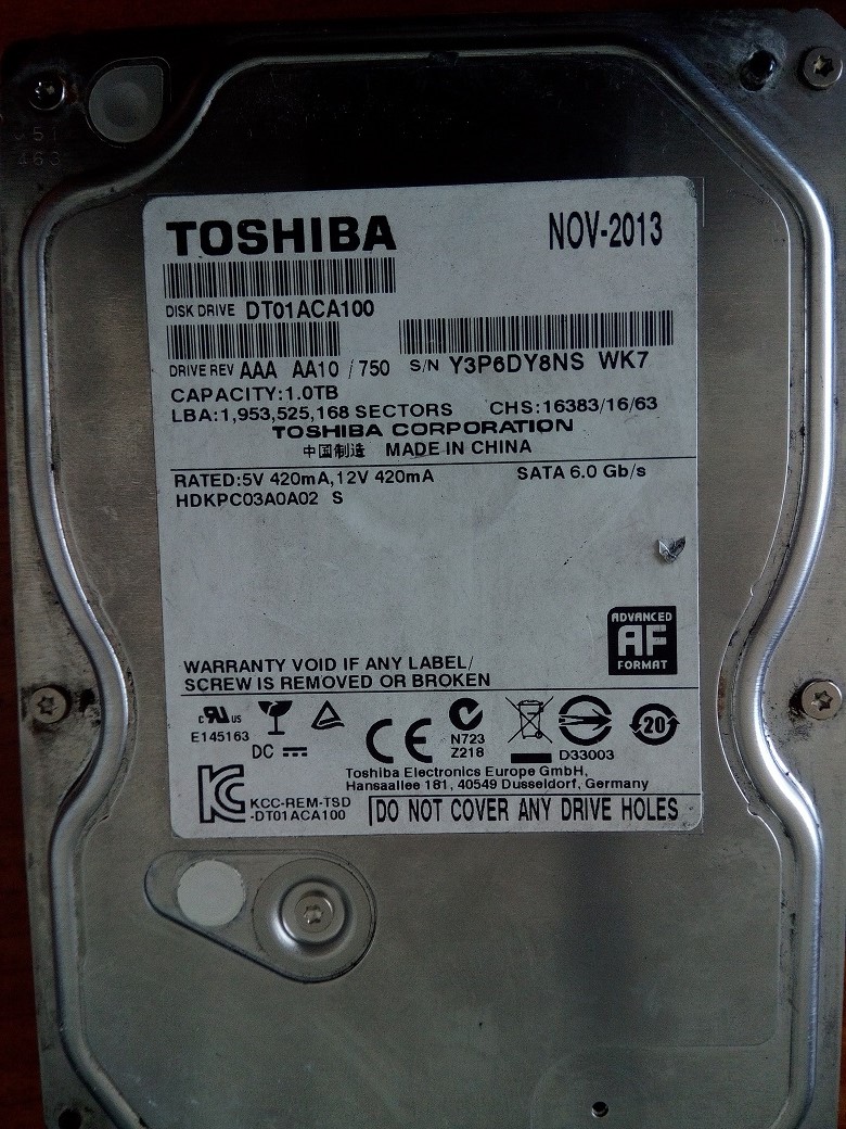

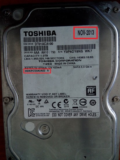

Please can I know what is a exactly method find donor HDD for this Toshiba Drive ?
 Post subject: Re: How to matching Donor HDD for Toshiba DT01ACA100
PostPosted: June 22nd, 2017, 3:53
Joined: November 26th, 2014, 11:55
Posts: 78
Location: Earth
Same model and date should be close.

Hi Hyuce,
Thanks for your reply,

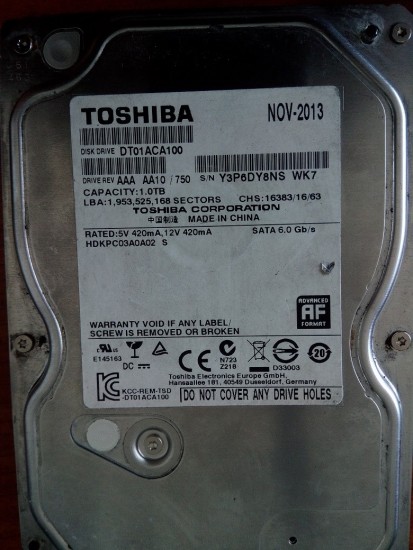

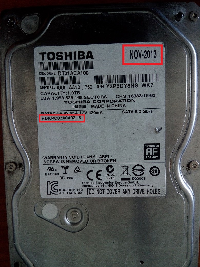

please find picture, your mention like this method ?
PostPosted: June 22nd, 2017, 4:45
Posts: 78
Location: Earth
i said model like that: "DT01ACA100"
and yes should be work!
