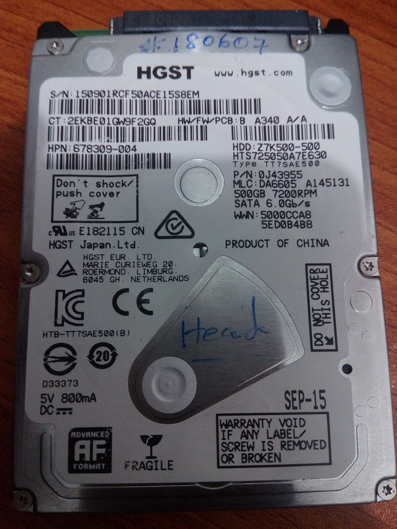

Dear Friend's,
please who can tell me correct method find donor HDD for this ?
i want doing head swap process.

Match the P/N: 0J43955 and the MLC: DA6605, then pick the closest date one you find among those.

In this case - just take the same model.

HGST ARM drives are quite forgiving, so taking Martin's advice will probably work. I just prefer to err on the side of caution and be 100% sure I'm getting a match. If you can't find same part and DCM, then just go with same part number. If you can't even find the same part number, then just go for the same model and a close date.

I would like to chose by another parameters, but in this case no need to invent the bycicle. :wink:
