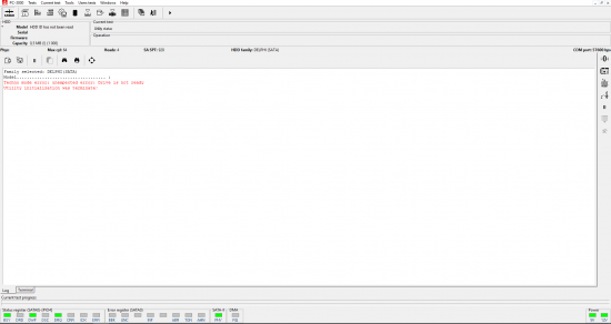

We have problem with this drive.When power on,start spin up.Then spin down,there is no unusual sound.Do you have any idea solve this problem?

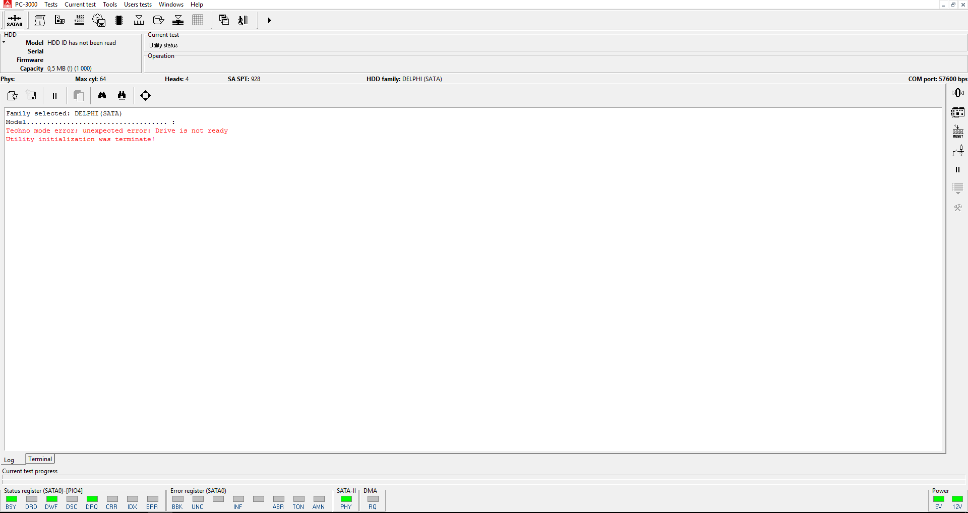

I heard unusual sound when ı tried again,today
TERMİNAL COMMANDS LİKE THİS;
SpnOk
spd: 0000 0000 0000
H: +00000
ADC: 0002
DAC: 7787
SK C: 00010F83
ENG>SRV>
SvoTbl Loaded
BD
FdtTbl Loaded
?????Sb
WriteSctLog -- buffer not valid

It would appear that you may need to retrieve the SA modules with a hotswap.
http://forum.acelaboratory.com/viewtopic.php?t=7688
http://forum.acelaboratory.com/viewtopic.php?t=8572
