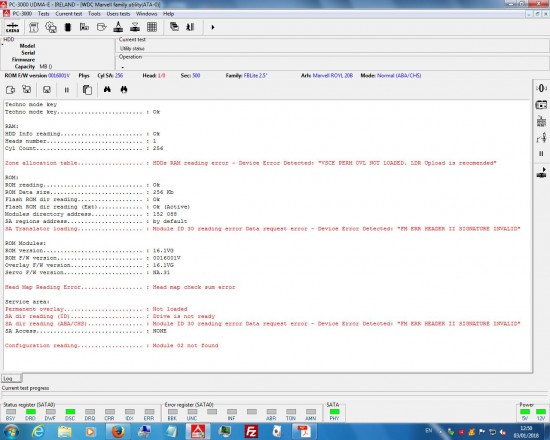

see attached screen shot - drive loaded with multiple errors - giving a msg that an LDR upload is required?

Yes, at least to test heads.
