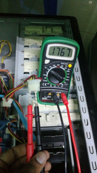

I thought maybe power supply is faulty, so took below readings
16.63V on 12V (Yellow Wire)
7.09V on 5V (Red Wire)
4.84V on 3.3V (Orange Wire)
Are these fine?

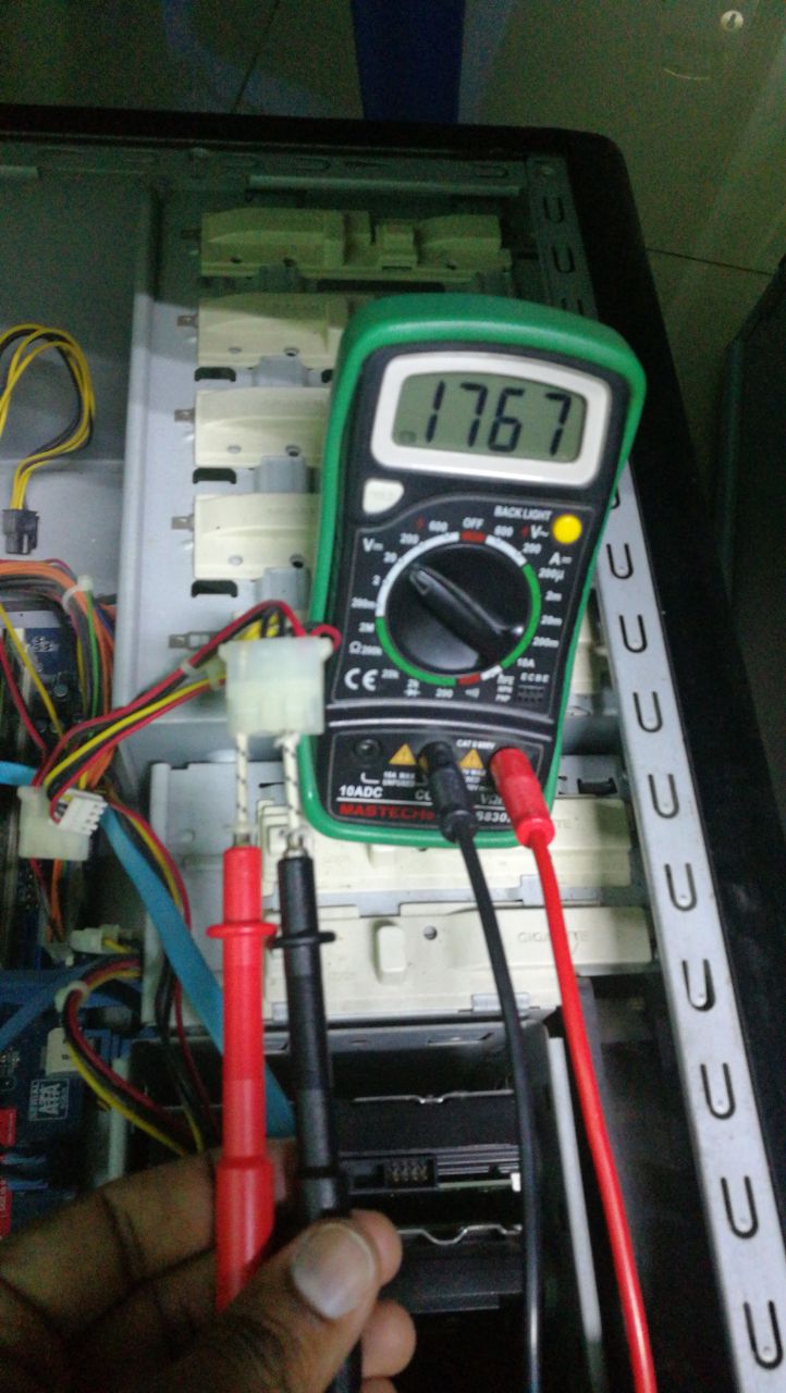

sourcerer wrote:
Are you sure you measured against ground (GND) ? All those seem to be a bit too high, but I don't have a PC3000 UDMA, so I don't know for sure. One possible reason might be that you measured against the wrong ground. Perhaps measure the power supply rails of the computer as well, and of the SATA power cable you plug into the PC3000 UDMA inside. Perhaps, the PSU of the computer has a problem? How did you wire the PC3000 up?
Ground I took of molex of PSU and different wires of same molex i measured. same molex goes to pc3k.

Murtazah wrote:
Battery of multi-meter you mean?
Yes. Batteries with low charge give wrong readings. And yours are too much wrong for the psu to be considered safe. 15V on the 12V rail would be enough for me to throw it out of the window.

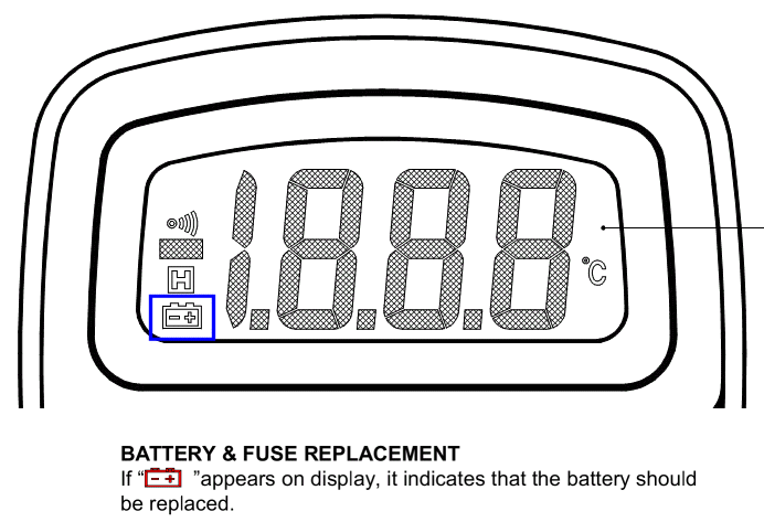

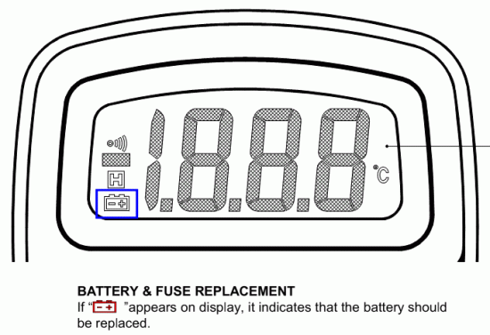

Posts: 17328
MASTECH-MS830L
https://vikiwat.com/userfiles/productimages/15047/multimetar-mas838-lcd-%282000%29-vdc-vac-adc-ohm-%C2%B0c-0.pdf

rogfanther wrote:
PSU is fine as I am getting correct readings of 12.14 and 5.12 for 12V and 5V after replacing battery of DMM.

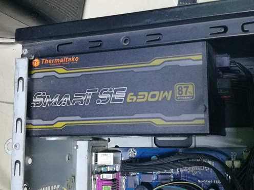

AceLab Not answering any emails or Service request. I am using below PSU, let me know if this is good?

@ Murtazah
What is the use of the PSU Brand? what is important is the Watt power
plus
I see no reason why they don`t reply really...
Anyway....the way you present the problem here is like this:
You buy a Ferrari car and you consult the next door Mechanic workshop.
