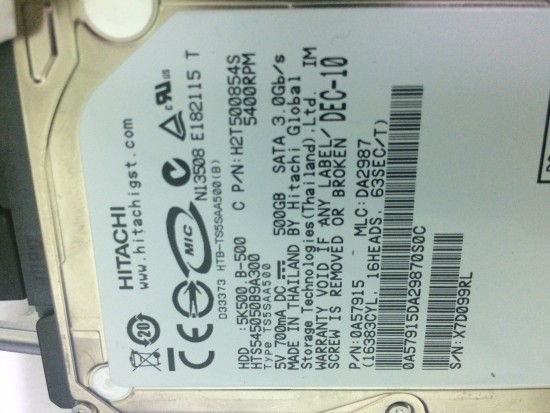

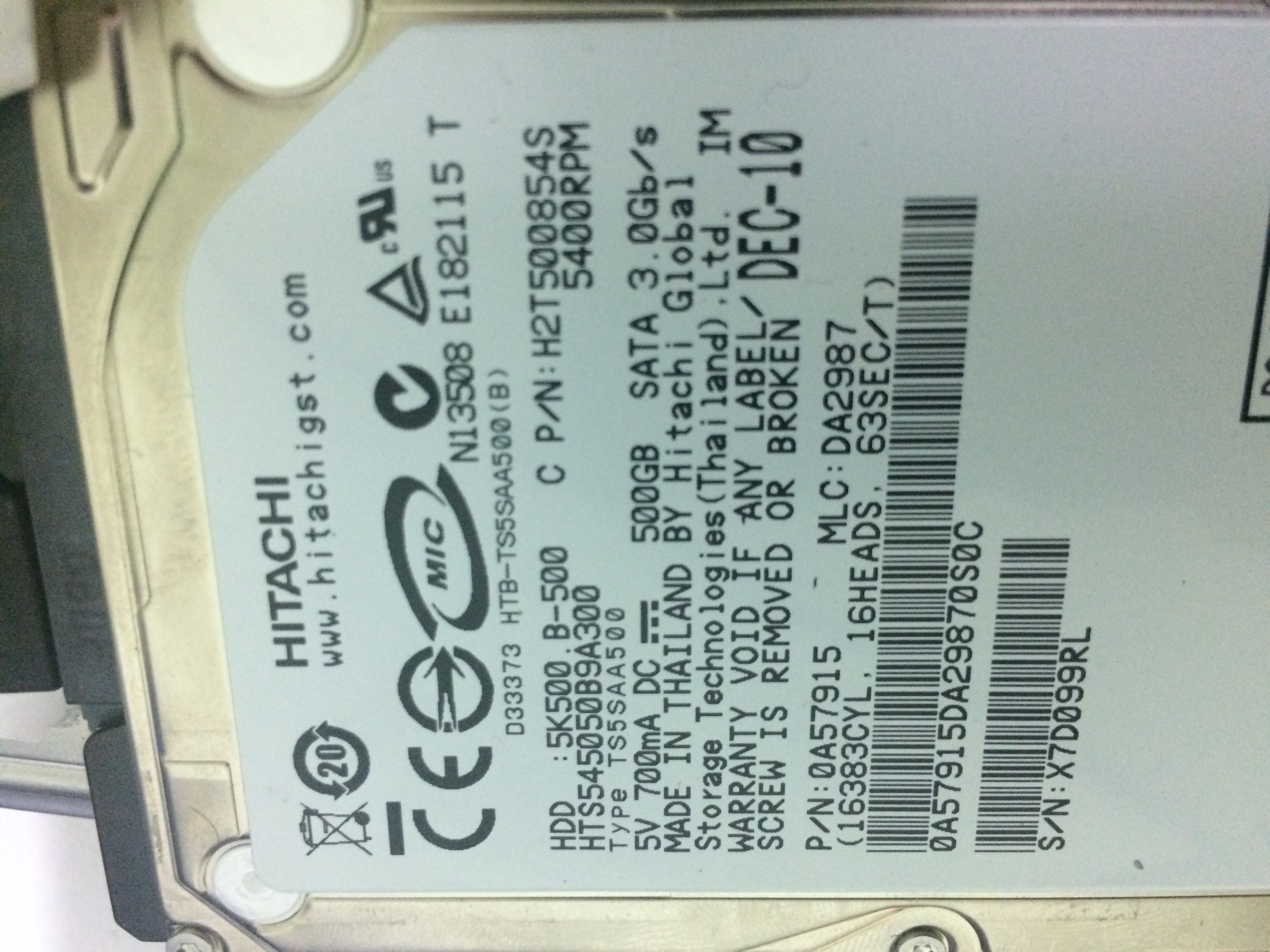

Under UDMA Lights shows in red:
- ERR
- ABR
It wont find the HDD Vendor so it wont find the family.
The HDD is spinning just fine. There is not any click or clack sound.
Please advise.
Thank you.
Best regards,

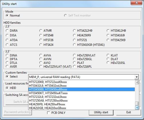

 Post subject: Re: Help: HITACHI: p/n: H2T500854S
PostPosted: April 15th, 2018, 12:52
Posts: 131
Location: Ellijay, GA
Select Hitachi-IBM and then
