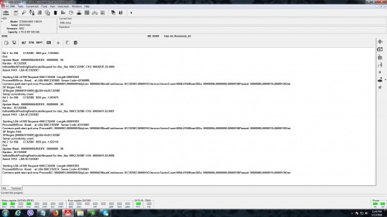

Please anyone tell me how to solve this error ? "HDD Busy"
please find attach picture.

It's a typical pending bug. Easy enough to fix by modifying system file 93.
If you can't figure it out, PM me and I can do it remotely for you. Should only take a couple minutes.

Did you try read Rom and then patched it by utility ?
next maybe you have access to service area and HDD ID
