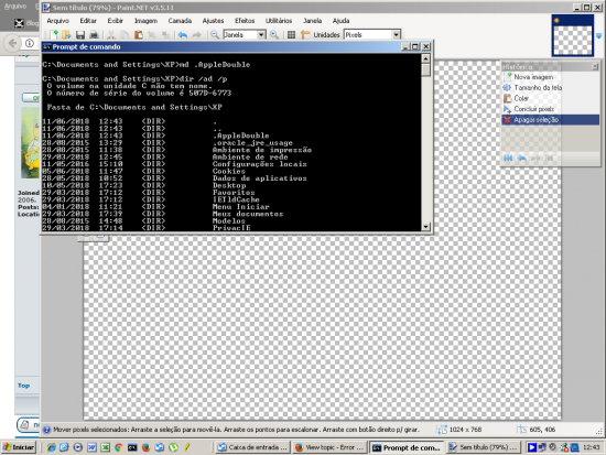

After imaging alla files and folders I try to save them.
After some good saved I start to receive this error in log window and process will interrupt:
Operation aborted
Error FS.Fill_Dir() -> Operation aborted
Operation aborted
Operation aborted
Error FS.Fill_Dir() -> Operation aborted [......]
I found the problem:
It cant create this folder ".AppleDouble"
By default, Windows doesn’t allow to create folder name starting with dot(.), because by default Windows system is considering the name starting with dot(.) as a file extension.
I haven't found a way to exclude them by saving (DE can exclude files but not folders)
Any suggestion?

Windows will allow to create files starting with a dot with no problems.
I´ve just tested with a windows XP and a windows 7 machine. Do not have a win10 machine here, but I believe it to be the same, because a lot of folders from Java, Oracle and GoogleChrome are named like that.
My first guest would be that either the folder structure is corrupt at that point, or your path has turned too long when windows try to create that additional folder. Try to recover to a shorter path or creating a SUBST´ed drive letter and restore to that.

True! ........but I didn't talk about files ......I talk about folders.
Can you create a folder with exactly this name? .AppleDouble
Is a windows limitation (win 10 also) ....not my computer error

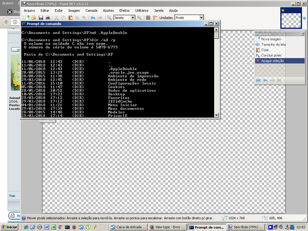

Files, folders, both.

I suppose what Spildit are observing is that using the GUI windows won´t allow to create a dot-folder. Using command prompt that limitation doesn´t exist, and I would believe some software using windows internal functions shouldn´t have problems with it ( otherwise, how would software create folders with special characters in the name ? )
By the way, that .oracle_jre_usage in my screenshot was created by java, not by me, so installed software can create those also.
