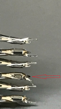

Hello I have a hard drive of my client. In PC-3000 it shows the model, SN, FW but Capacity: 3.6 gb. it blocks DRD DSC and ERR ABR
I thought there is Head's problem
HDD out of service
ST3000DM001
S / N: W1F28494
PN: 1CH166-505
FW: CC44
Date: 13296
Site Code: WU
PreampType: B4 03
Donor hard drive
ST3000DM001
S / N: W1F2QVR5
PN: 1CH166-302
FW: CC26
Date: 13377
Site Code: WU
PreampType: CC 06
I tried changing Head Donor but it's the same problem: It shows the model, SN, FW but Capacity: 3.6 gb. it blocks DRD DSC and ERR ABR
I searched the hard drive with PreampType: B4 03 on the site donordrives.com, harddrivesforsale.com, ebay but it is not diposible.
My question:
if the head is not compatible, he can not find the model ?
you can use another hard disk with other PreampType that compatible with the hard disk PreampType: B4 03 ?
Thanks in advance

Just to be sure, did you try the patient head in the donor hdd ? What were the results ?

Correct, if the preamp is not compatible, then it cannot read the firmware, which contains the drive model.
Need at least B4 more than likely.

Head 4 broke well (see photo).
It is possible to disable the Head 4 to read other head.
