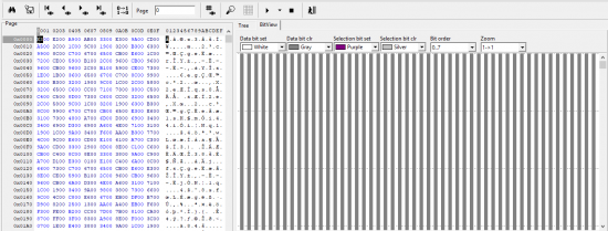

I was trying to read Sandisk SD card, the bytes at the odd position are skipped, I attached a picture that explains the issue.
NAND ID= 45CE9532
How can it be fixed?

maybe the config for the chip was wrong, or you used 8-bit config when chip is 16-bit.... or the device is refurbished/fake and has a strange byte cut, or a mix step that will fix that..
what is the hex editor you are using there?
what reader did you use and what config?
