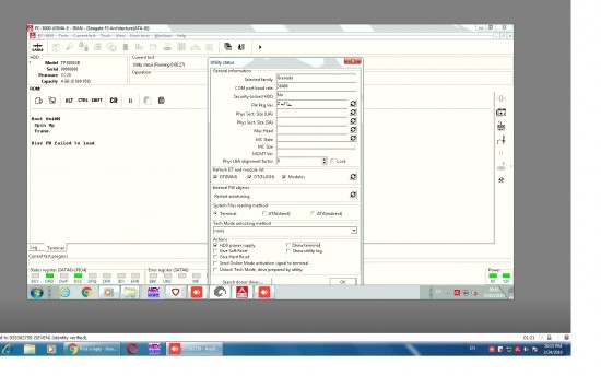

Hi to all
newly, arrived a refurbished hdd seagete 3 tb that i think some heads are weak so i want use head map but i
can access to service area
Hdd detect
Model : OOS3000G
Serial : 00000000
Firmware : ZZZZFFFF
Capacity : 3 TB (5 860 533 168)
in log
Family ID by HDD ID: 58
Selected family......................... : 58, Grenada
Model by ID............................. : OOS3000G
Loading default settings!
Use the options dialog to review and save utility settings.
Then press OK!
Family default settings loading!
Tech Key...
En Tech err! Tech state 0xFF, 0xFF010000
Detecting SA Phys Sct Size...
Can not detect SA phys secotr size by terminal!
in terminal
Then press OK!
Tech Key...
In terminal
UNLOCK ERROR!
Spin Up
SpinOK
TCC:001B
(P) SATA Reset
ASCII Diag mode
After ctrl +L
F3 T>
Overlay PartNum: 10060942
CFW PartNum: 05272014
Overlay CompileDate: 20131006
CFW CompileDate: 20140527
OverlayCompatibilityCheck failed
Unable to load Diag Cmd Processor Overlay
some command works V1,V2,...
but other command not worked
NS DATA RECOVERY
www.nsrecovery.ir

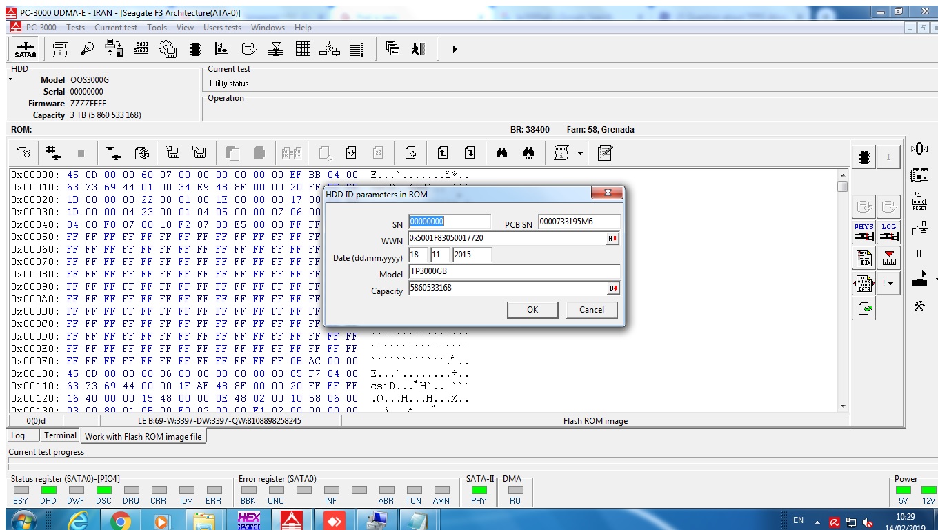

File comment: IDD after read rom

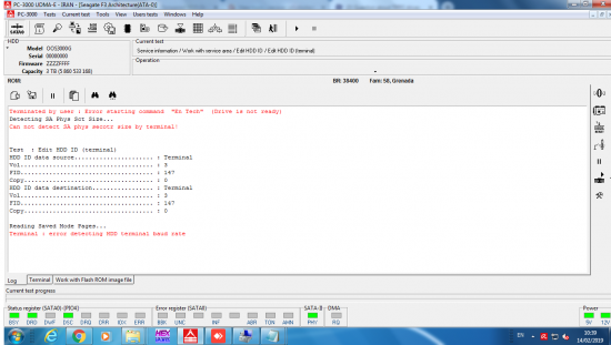

after search below link similar my problem
https://forum.acelaboratory.com/viewtopic.php?t=9668
also i tried read terminal but end with error
again
Thanks for any idea
File comment: try for read sa with terminal

Can I see it's ROM? Interesting case. Someone load an incompatible loader into it. There is a small collection. And from refarb too. Maybe something will be selected.

E123 wrote:
hamidbid
Hi E123
yes I think so
File comment: rom
ROM_00000000_37449BF1.rar [183.22 KiB]
Downloaded 1254 times
 Post subject: Re: recover refurbished drive OOS3000G or tp3000GB
PostPosted: February 14th, 2019, 15:27
Joined: September 26th, 2016, 4:26
Posts: 125
Location: Russia
Unfortunately, I do not have a loader compatible with this ROM and there is no ROM under the overlays 2013.10.06. I can only suggest that the prototype was ST3000DM001-1CH166-899. So there is no need for an unlock. It is only necessary to make compatible ROM and overlays. In this case, I can only offer a risky solution from myself: put an available seagate updateer under 1CH166 into the disk. I have version CC29.

I analyzed my refer Rom
in container segment ID 22 000100 ----030000 at both section in Rom (000000-3FFFF,40000-7FFFF)
I found
16 000040 BootFW-DIR
15 000048 General Data
0E 000248 IAP
10 000658 BootFW
03 018000 SFW
0B 02E000 Shell
00 02F100 end container
Interesting , all data in segments at two section are the same
attached all segments
22 container segment.rar [992.55 KiB]
Downloaded 1273 times
NS DATA RECOVERY
www.nsrecovery.ir

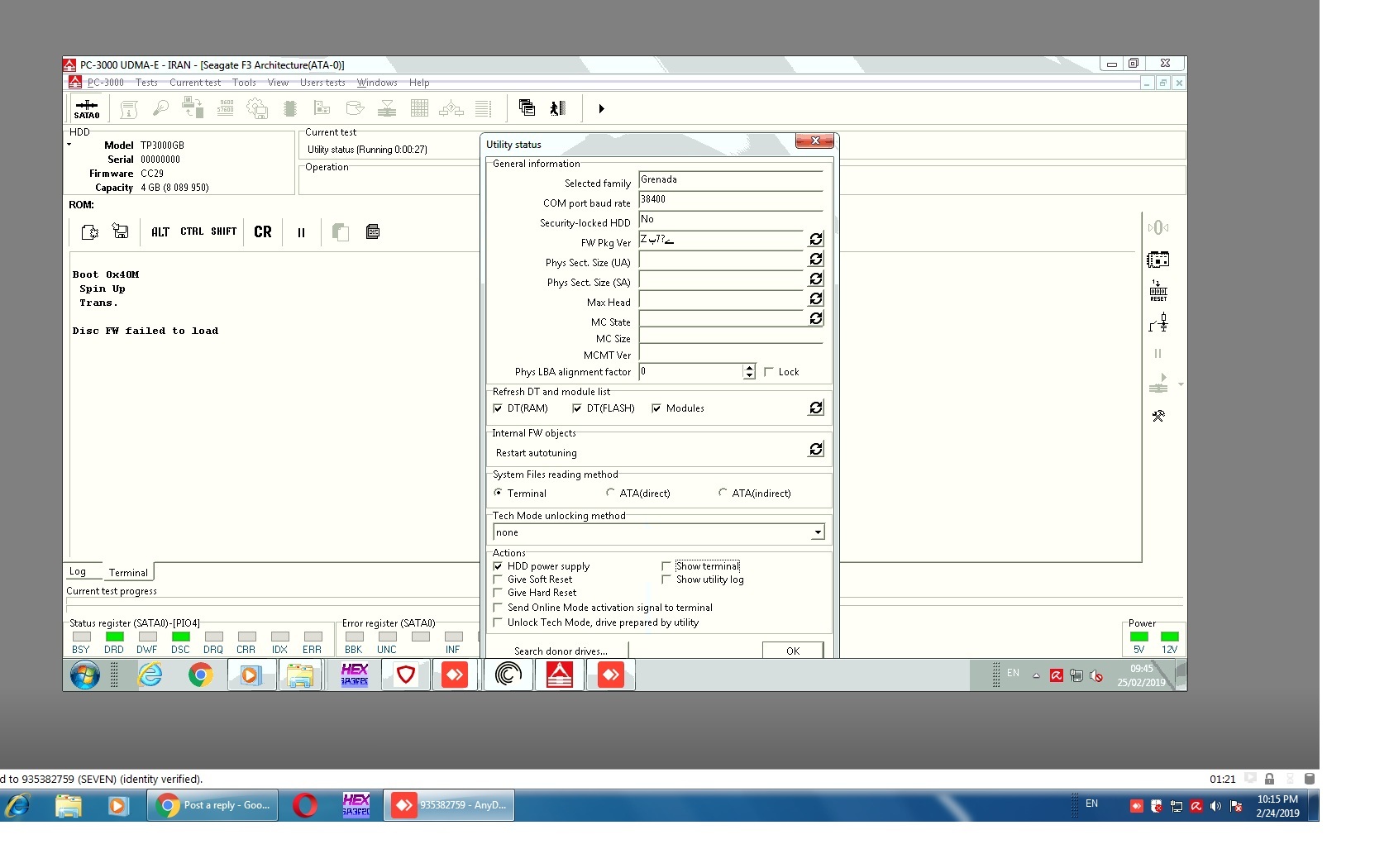

I wrote Rom with terminal after power on
got this message in terminal
Boot 0x40M
Spin Up
Trans.
Disc FW failed to load
after that I used from loader it didn't worked
again wrote refer Rom to Pcb but again got the same message
I changed PCB but again the same message!!? :?:
what happened for Hard disk?
How can I do?

In your screenshot, the disk has readiness in the ATA registers. Download CC29 loader by ATA. If the ABRT or ERR fails to appear in the registers, use the module "CFW_DISK" from the CC29 loader. This is your 3D loader for MRT. Use the virtual load in MRT.
For dates: do not pay attention. This is me for myself - to identify different versions of the same firmware.
