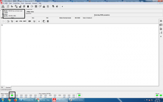

Hello experts.
greeting of the day.
I am facing the issue while using pc3000 "hdd id has not been read, capacity is .49mb(1000)"
and the status is showing DWF
please help[ me to solve this issue so that i can recover my data.

You need to fix whatever is wrong with the hard drive. There's no push-button solution here. I'd start by replacing the PCB and see if that helps. Could be heads, media damage, or any number of other causes. We'd need a lot more information to even attempt to help you.

Spildit wrote:
Full model of your Seagate HDD ?
Most likely it will be a F3 Arch drive and NOT a ST-10 / U5 so you might be using the wrong PC-3000 utility ...
model: Seagate
s/n: 9TX110YJ
ST3320310CS

Spildit wrote:
F3 Arch drive....
Baud rate of 9600 is for older ST-10 ... It will NOT display terminal log on F3 ARCH. You have wrong settings and you are using wrong utility ....
Then give me the solution for this..

rohitdharan wrote:
Spildit wrote:
F3 Arch drive....
Choose F3 Architecture (Garbo family?), baud rate = 38400bps
