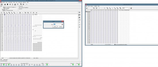

I used to recover data from SD cards with problems via SD->SATA adapter. Now i got a microSD card, Sandisk 200GB. It gets DRD DSC. I can read sectors in "sector edit". But in DE whatever option i use i get all the sectors black. I remember that i used "do not use hardware retries" in the past for SD cards, but this one has more than 300 000 000 LBA so this option doesn't work.
Any idea what am i missing now? It works fine on every other card i tried - 4-8GB.

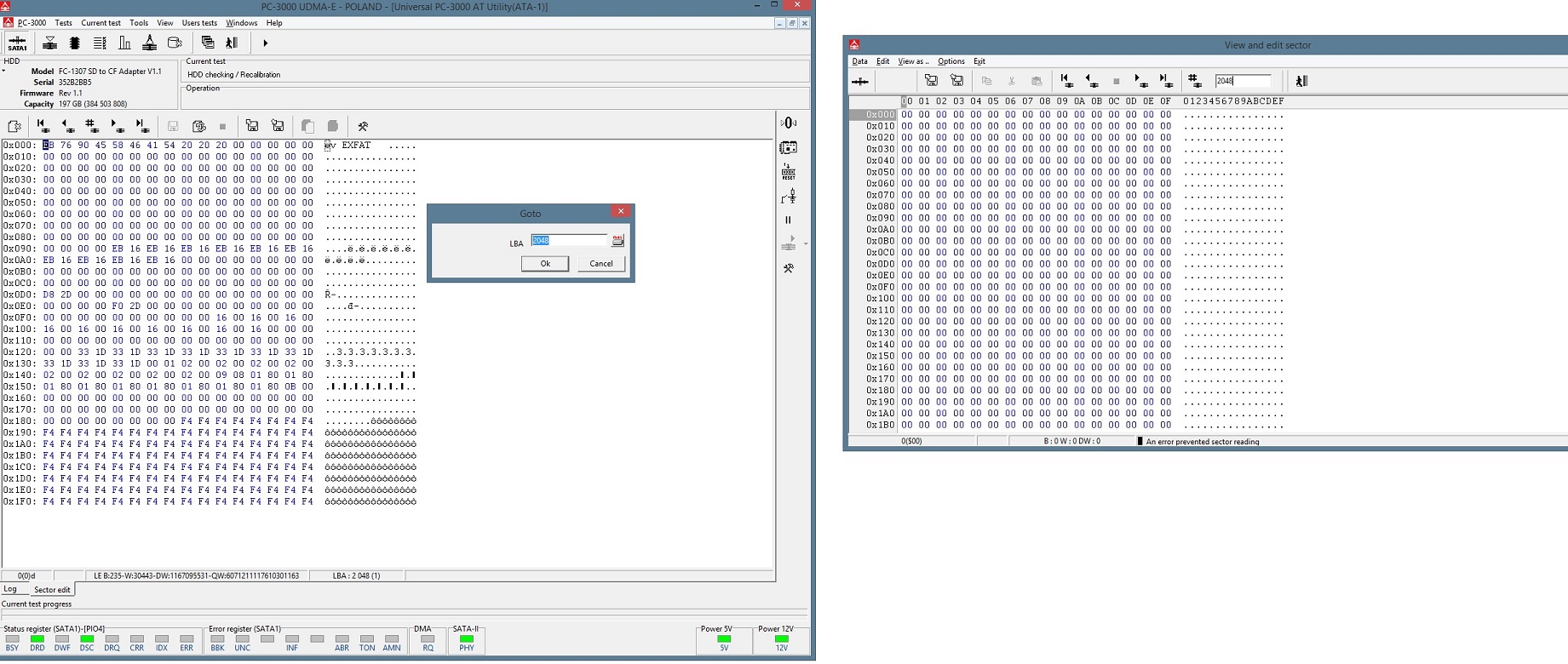

Here's a picture. On the left - via utility. On the right - DE.
I remember that using "do not use hardware retries" made the only good results in the past. But this option doesn't work with LBA> 268435455. Mine has 384 503 808.
Just checked - other cards read in every "command to read" option. Just results are different. This card does not read at all in DE.
