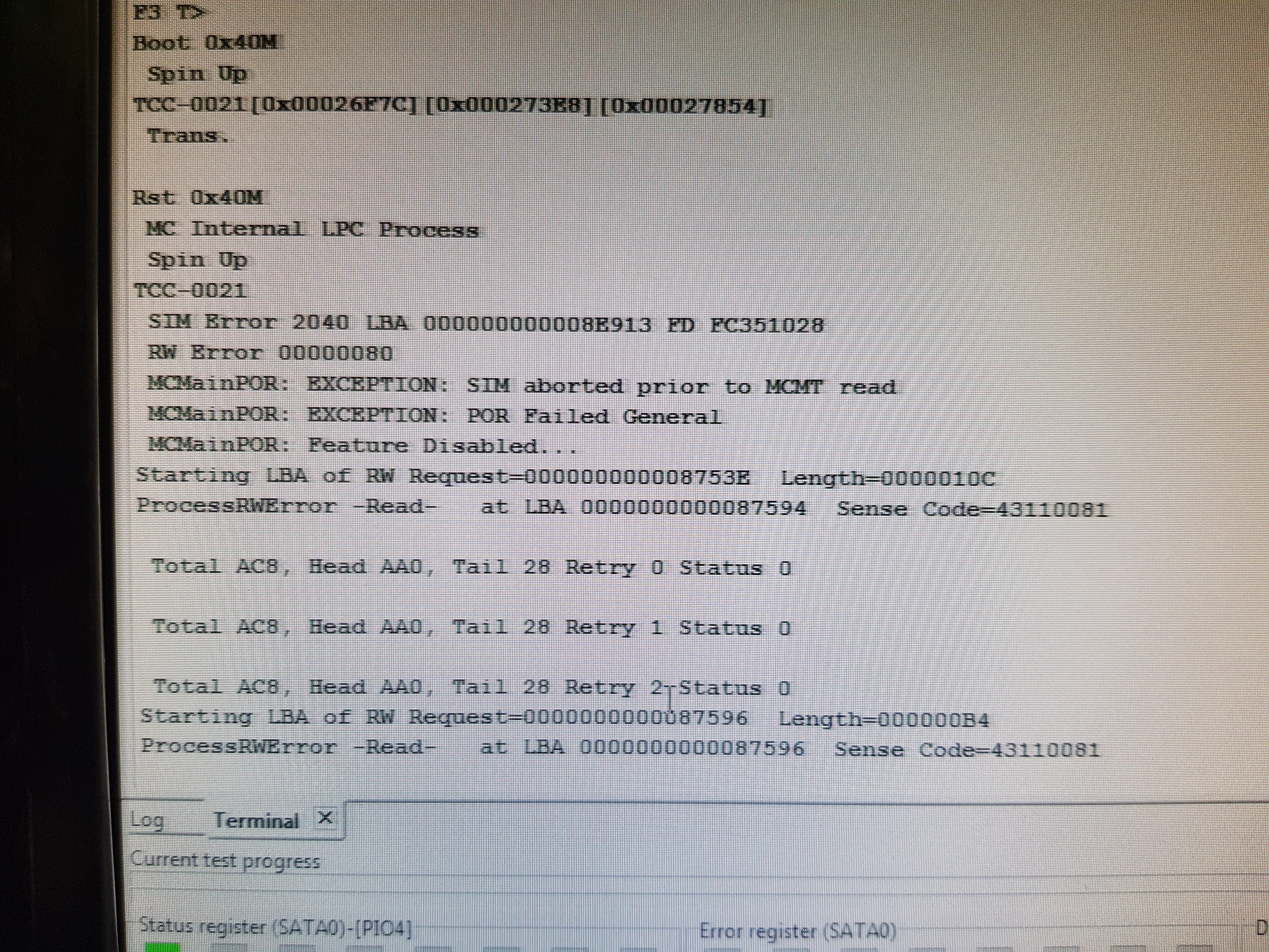

Hello world!
I've a problem with a ST2000DM001 CC4B 9YN164-500 (fam- 59 grenada)
- stays on BSY state and is not auto-recognized from F3 Utility (LED BSY , PHY )
- doesn't make clicking noise or bad sound
- In log, see pic
- have terminal access and spin up,
I've a very newbie, it's my 2nd recovery with pc3000 udma card. Can someone help me, please?
File comment: LOG

Do you have terminal access? F3 T>

Yes, I've. With ctrl-z I enter without any problems.

Have you done any of the standard F3 tests as recommended by Ace Labs?
At the moment you are not giving us enough information to be able to help you.

Looks like translator is incorrect, maybe one system head cannot write
