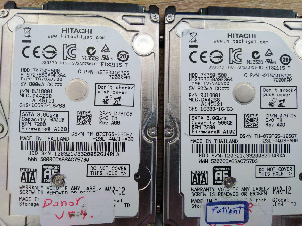

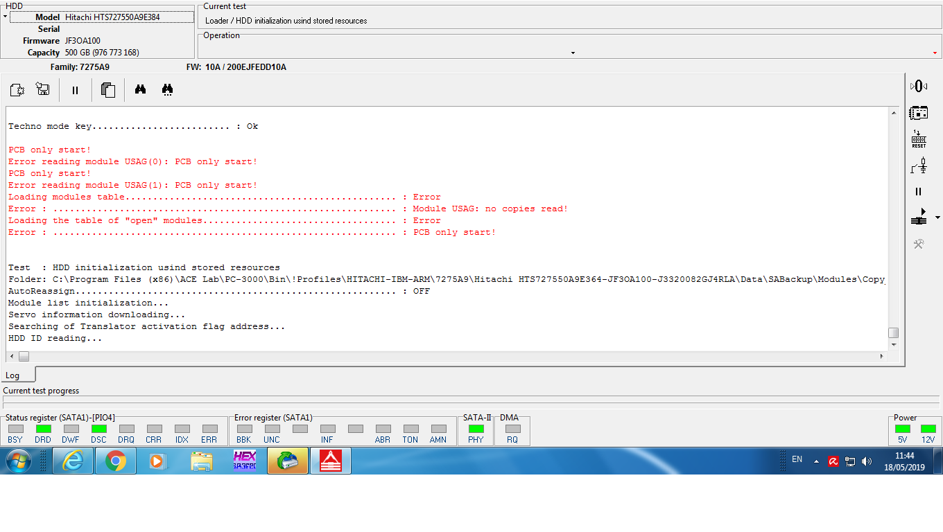

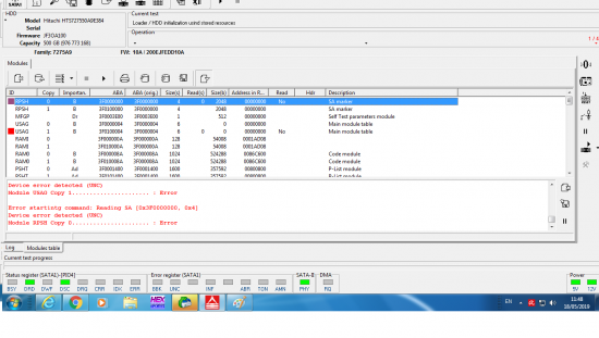

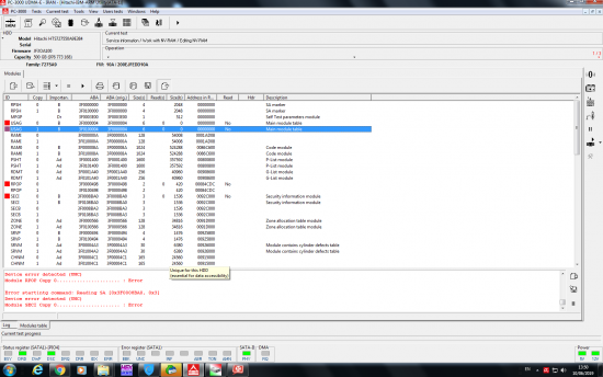

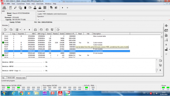

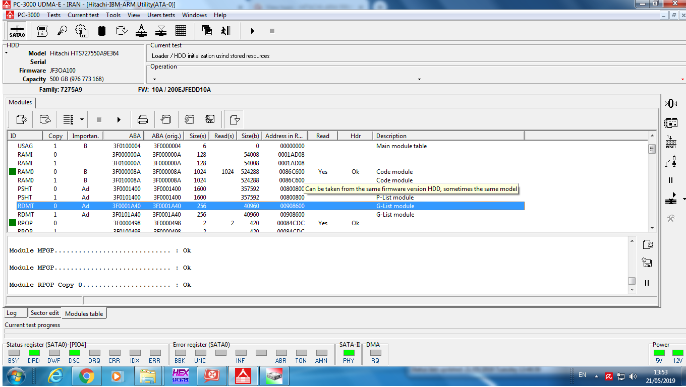

Hi Guys,
I have a hdd HTS727550A9E364 hitachi-ibm-arm model
sound normal but not detect
File comment: first picture
File comment: second pic
after restart

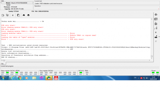

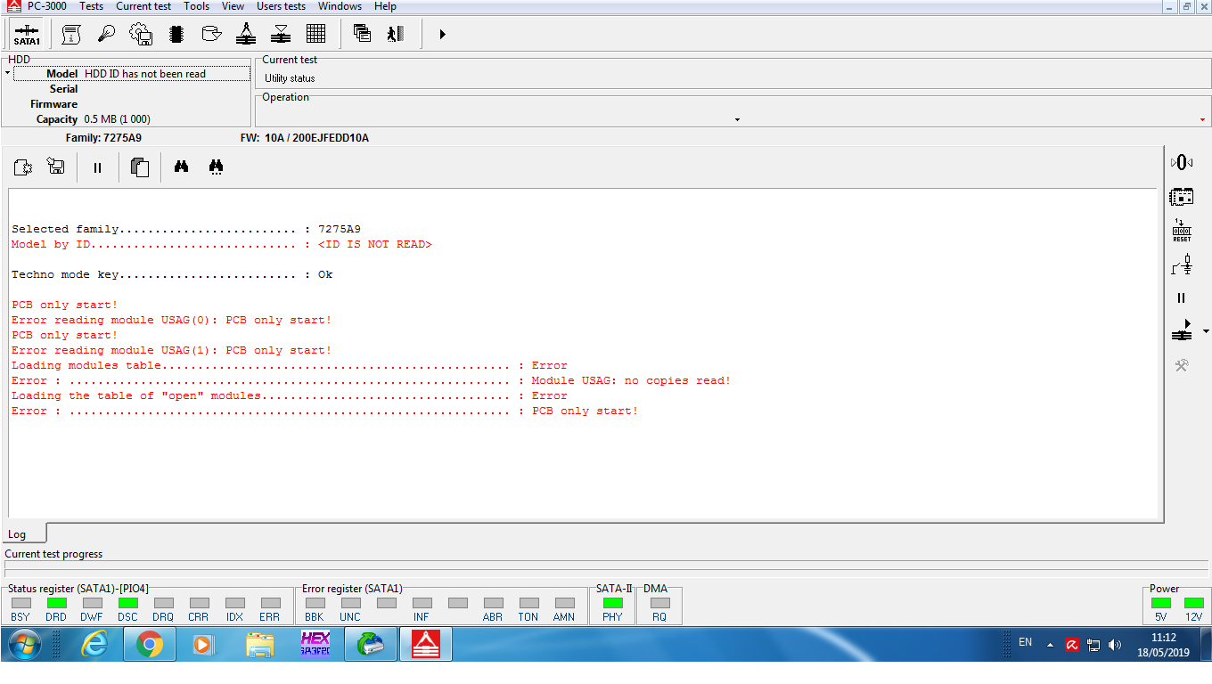

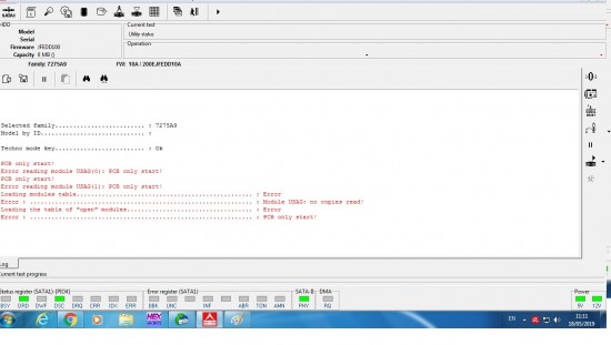

I find another working Hdd with same details
donor hdd
HTS727550A9E364
p/n:H2T50001672S
mlc:DA4268
head 4 , head map 00 01 02 03
and patient hdd
HTS727550A9E364
p/n:H2T50001672S
mlc:DA4268

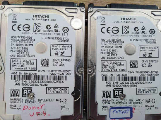

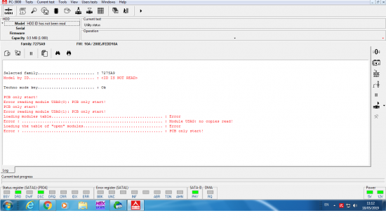

I start test
1. PCB swap result the both pcbs are working
2. swap heads estimate the all heads are working both patient and donor ( after swap heads : donor hdd working all heads with patient heads and patient hdd with donor heads the same result )
3. using from resource store from donor
after that Hdd detect and access to sa but can't read any sector from sa or lba

Well you screenshots shows very clear whats wrong " USAG no copies read"
List of modules can´t be read from SA, you need to fix that.

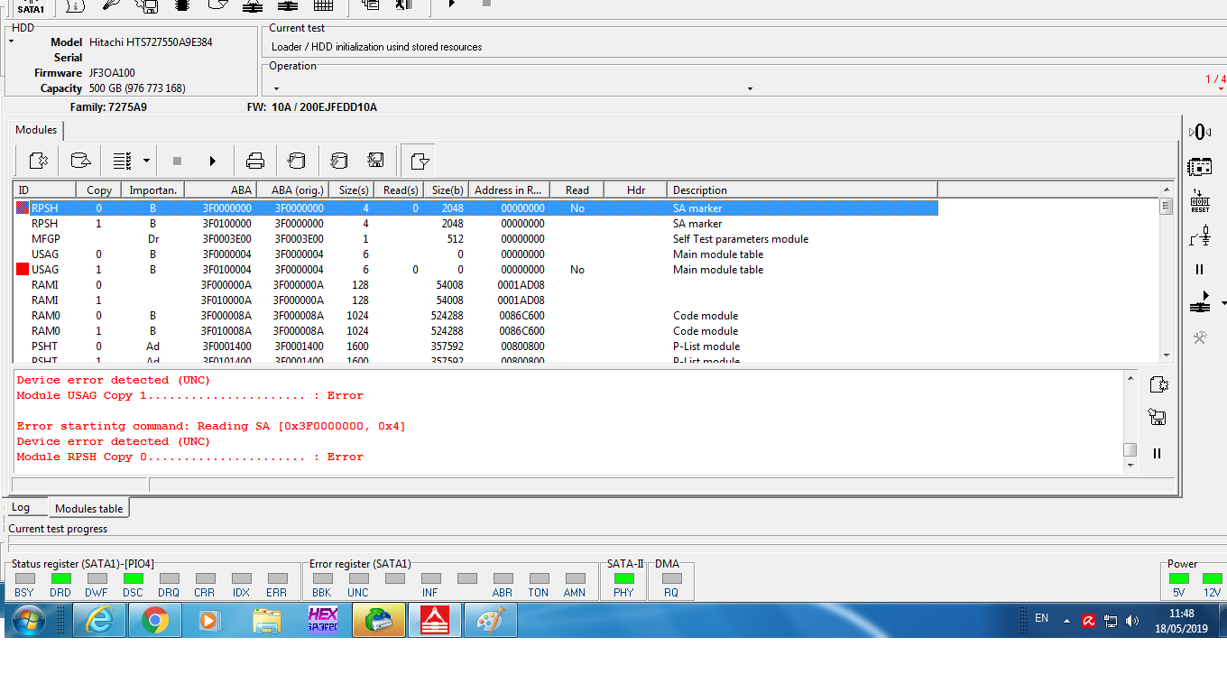

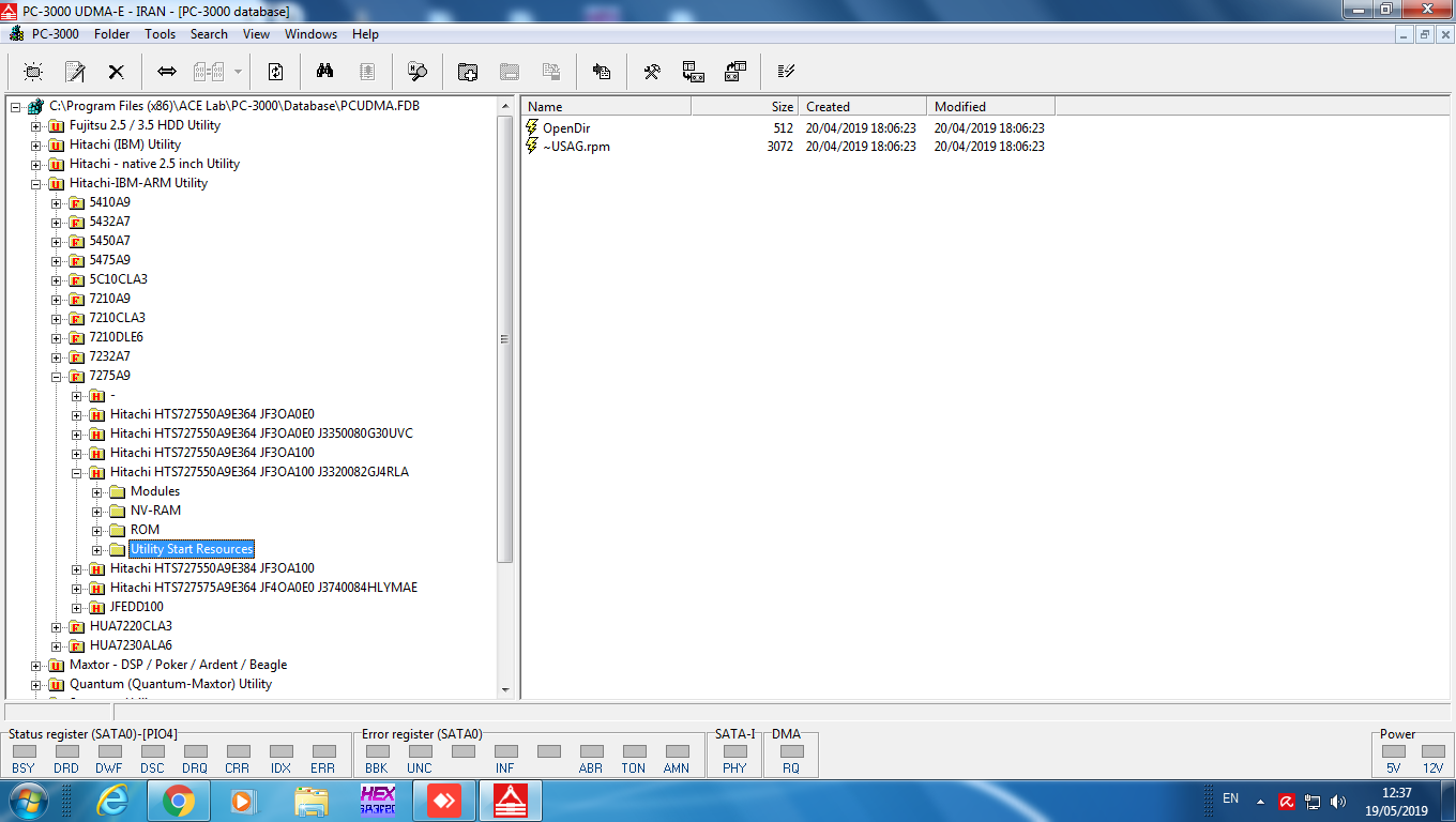

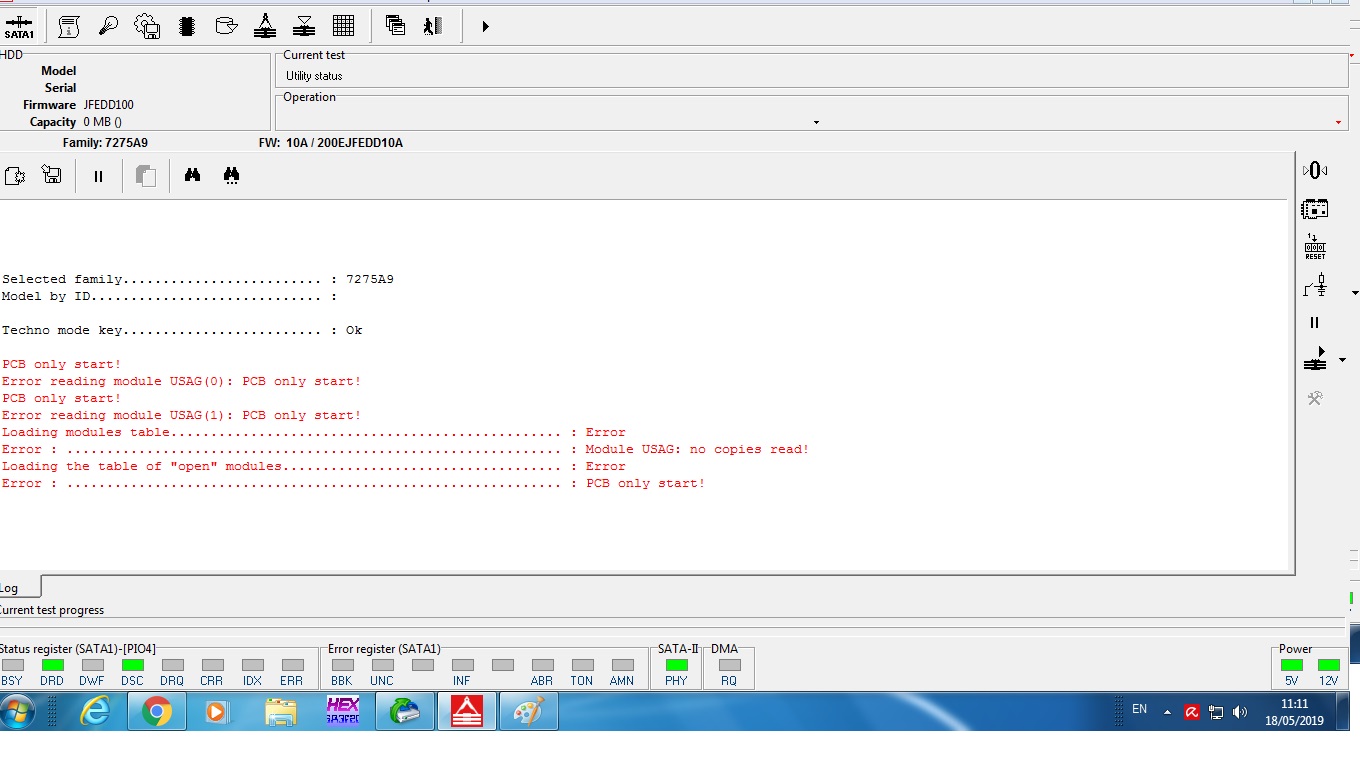

Spildit wrote:
Thats because it's ARM and you need to load a loader so that you can write the USAG again .... When you can write USAG the drive will know the location of other modules.
Thanks Spildit
but the resource store is not the same loader due to I tested that before ( 3. using from resource store from donor
after that Hdd detect and access to sa but can't read any sector from sa or lba )
and if is that something else how I can create that because pc3000-udma did n't have option for create that
and in folder utility start resource

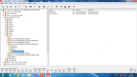

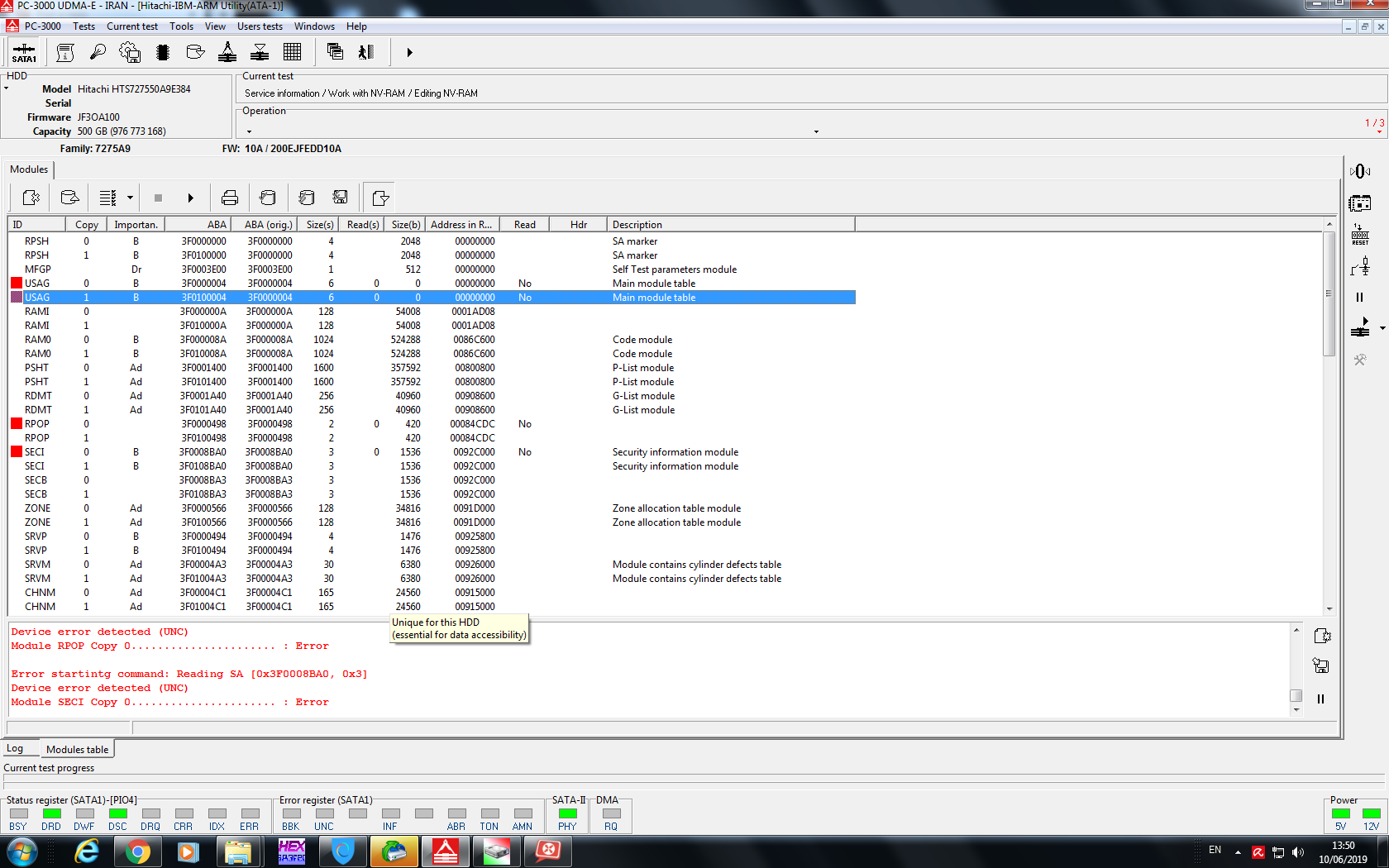

In my working Hdd (donor hdd )
1. I wrote 00 to USAG modules (copy 0,1)
2. after re power hard drive did't detect
3. I used from using restore resource then I can access to SA even data surface (I have had backup from modules)
result in pc3000 don't need to create loader it can be used from modules automate

in continues for more description
if I use from HDD initialization usind stored resources with working hdd only when we have only usag module
Test : HDD initialization usind stored resources
Folder: C:\Program Files (x86)\ACE Lab\PC-3000\Bin\!Profiles\HITACHI-IBM-ARM\7275A9\Hitachi HTS727550A9E364-JF3OA100-J3320082GJ4RLA 1\Data\SABackup\Utility Start Resources
AutoReassign.......................................................... : OFF
Module list initialization...
Module is not loaded: RAMI
Module is not loaded: RAM0
Module is not loaded: CHNM
Module is not loaded: ZONE
Module is not loaded: RPOP
Module is not loaded: IDNT
Module is not loaded: FEAT
Module is not loaded: CNFG
Module is not loaded: SRVP
Module is not loaded: SRVM
Module is not loaded: SECI
Module is not loaded: SECB
Module is not loaded: RPSP
Module is not loaded: ABLP
Module is not loaded: PSHT
Module is not loaded: RDMT
Servo information downloading...
Searching of Translator activation flag address...
HDD ID reading...
after that I don't have access to sa and lba but after all these modules copied in folder Utility Start Resources do test again this time I have access to sa and lba
Now my problem this is some modules are A modules and are unique then I shouldn't use for patient hard disk drive while I don't access to sa modules in patient Hdd
Would you mind ,giving any idea?

it seems something go wrong :D
I tested with other family of working Arm Hitachi drive ,
1. I wrote 00 to the first of USAG modules (copy 0,1)
3. I used from using restore resource with same firmware (from other hdd with the sames model and the same fw)
vow :o
hdd detected and I accessed to sa ( read and wrote ) but i dint have surface ( duo to A modules in loader )
I find that my problem is in other place , maybe head or nv-ram,...
