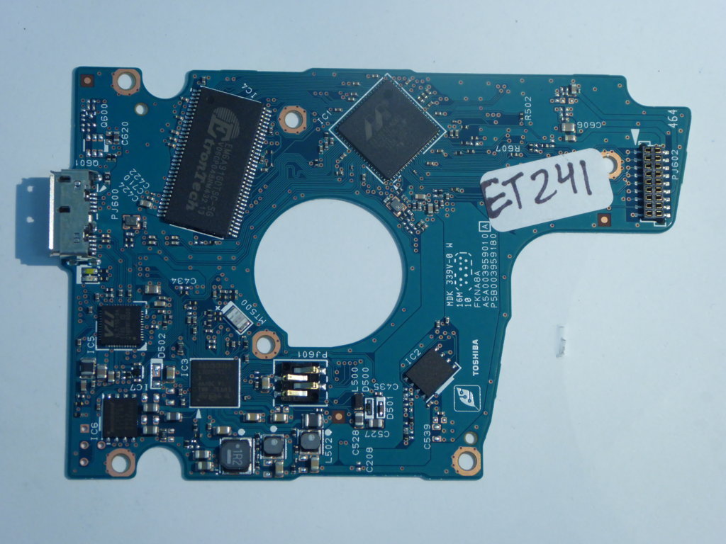

Hi
need to transfer the ROM from G3959A USB to G3918A SATA
in G3959A which one is the ROM IC6 or IC2?

LostDataSa wrote:
Hi
IC2

Hi there,
I know this thread is old. If it's better to open a new discussion, please let me know.
I want to transfer the firmware/ROM/BIOS from a broken G3959A board to a new G3959A board.
IC6 is a Wibond 25x20CL, which seems to be the one to be flashed.
Has someone tried it?
Thanks a lot!

IC2 is associated with the MCU, whereas IC6 is associated with the USB-SATA bridge.

Thanks for clarifying it, very useful!
