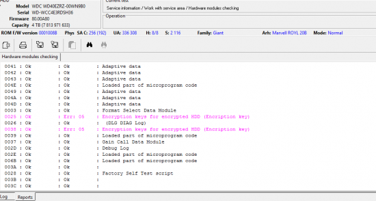

Transferred the u2 ROM on the Enclosure PCB , but the data is not getting de-crypted.

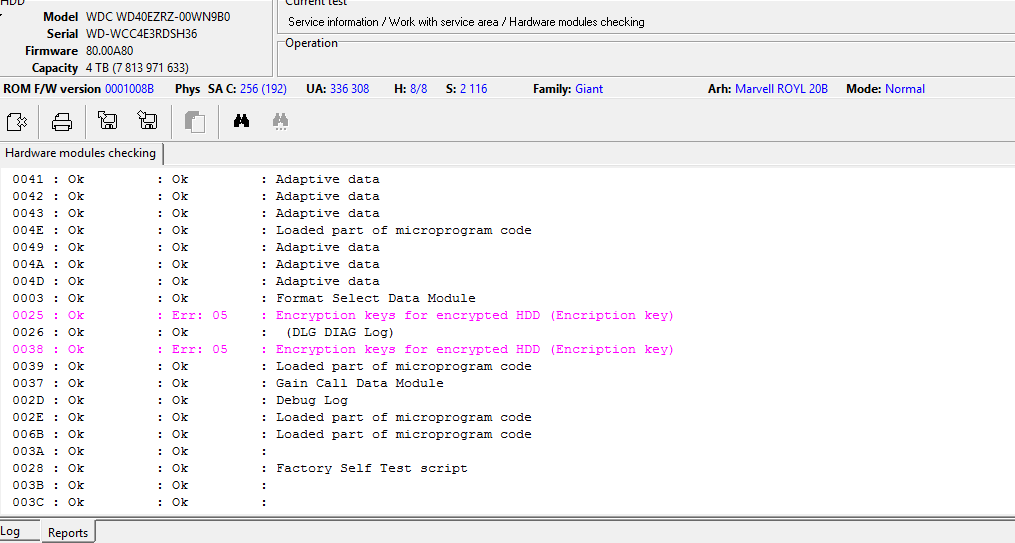

So tried using PC3000 utility to decrypt ,but it is not finding the key....
Modules checking in SA reports errors in modules 25 and 38 (modules are read properly)
checked the modules with another similar working encrypted drive , but do not know how to continue further
attaching the mods (donor and patient)..
Any idea how to proceed would be great
P.S.(surprisingly / confusingly..... PC 3000 did find the encyption keys from sa of the working(donor) encrypted drive , but the data was still not getting decrypted)

Could we see modules 02h, 124h and 127h?
attached the modules along with a snap of the modules checking report

Your drive appears to be a SED.
Module 02
00000860                    00 00 00 00 00 00 01

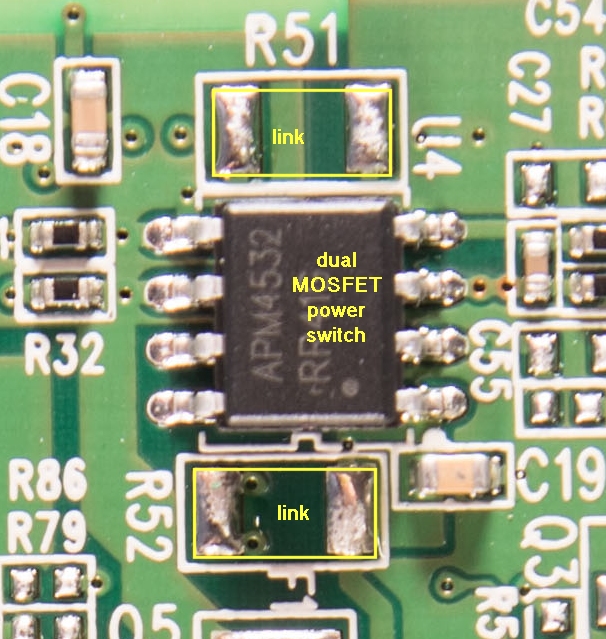

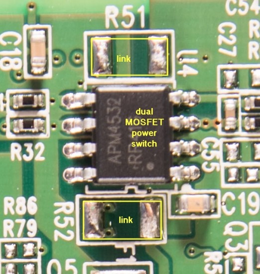

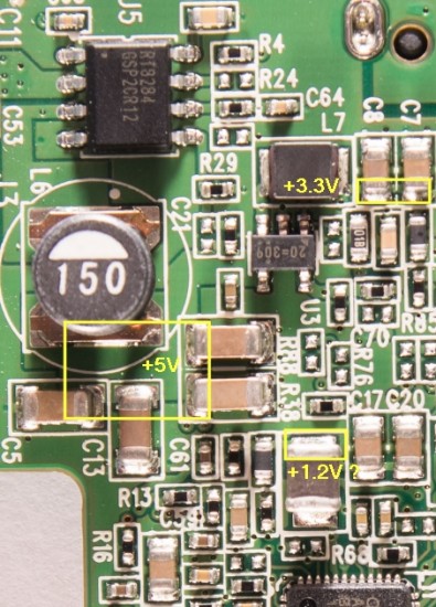

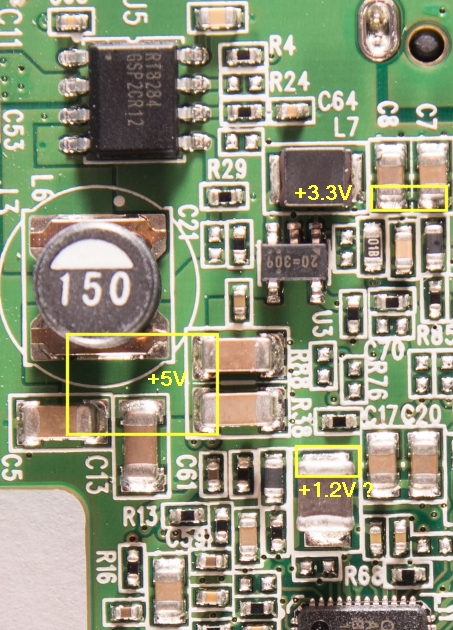

I would measure these test points on donor and patient:
The +3.3V regulator may actually be +2.5V, and the +1.2V regulator could be closer to 1V.

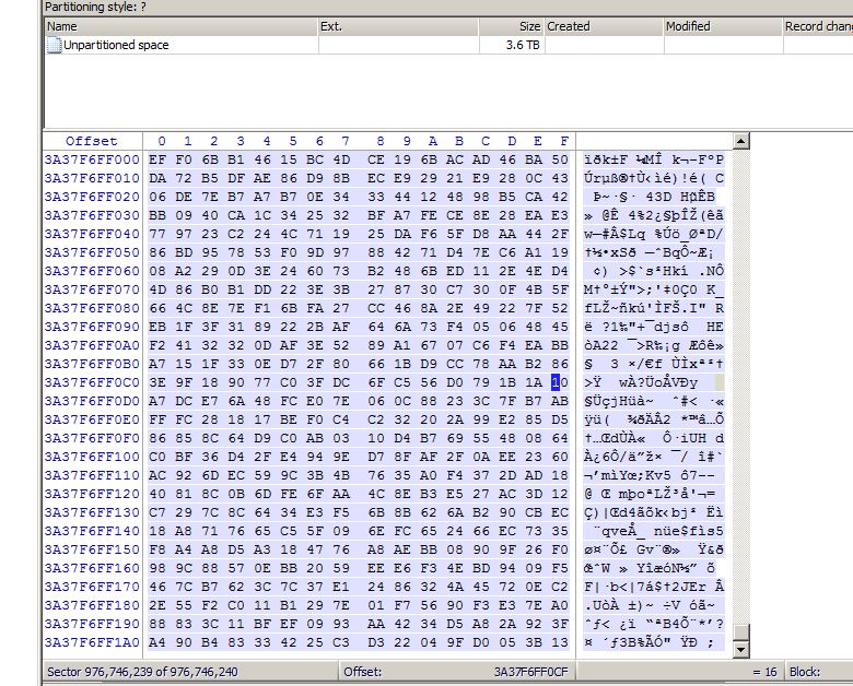

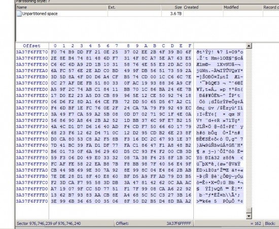

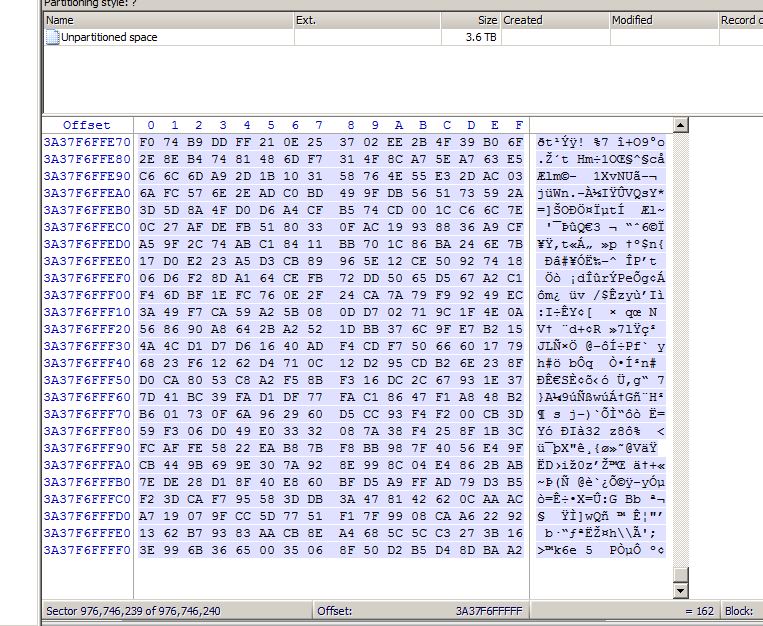

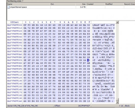

Now when connected via USB i can see following sectors (beyond the encrypted data area ?)
i am attaching the sectors (last encrypted data sector + sectors beyond that )
also attached snaps of start and end of the said sectors
thanks
i will get back with the readings

Via USB, the drive is reporting a capacity of 976746240 x 8 = 7813969920 LBAs. I don't understand why it would report only 7813971633 LBAs via SATA??? That only allows 1713 LBAs for the VCD???
Moreover, why would it report a capacity which is not aligned with a physical sector?

I have a similar case and there's no power to the drive. LED is not flashing so looks like there're something wrong with the power supply.
On the PCB board I measure L6 (the 150 coil) and nearby capacitors give 5v.
However no voltage on C7 C8. Nor the one below R38, no 1.2v. Just 0.
So it's APM4532 damage?
Thank you
