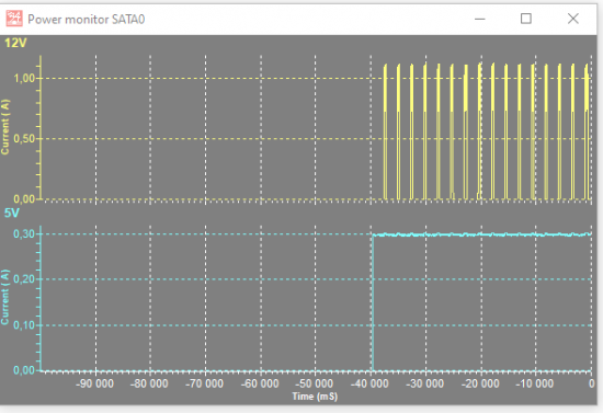

I tried to recover datas from a damaged Seagate ST31500341AS.
When I connect the device to PC3000, I heard that the motor try to start as you can see in this printscreen in attachment.
The disk is in busy state. After 4 or 5 minutes, the motor stop completely.
Do you have an idea if this hard drive can be repair with PC3000 or I have to change some parts ?
Thank you for your advices !
 Post subject: Re: Problem with a Seagate ST31500341AS (motor)
PostPosted: November 13th, 2019, 16:53
My money is on it being seized solid.
So will require platters and heads swap into a good chassis.
