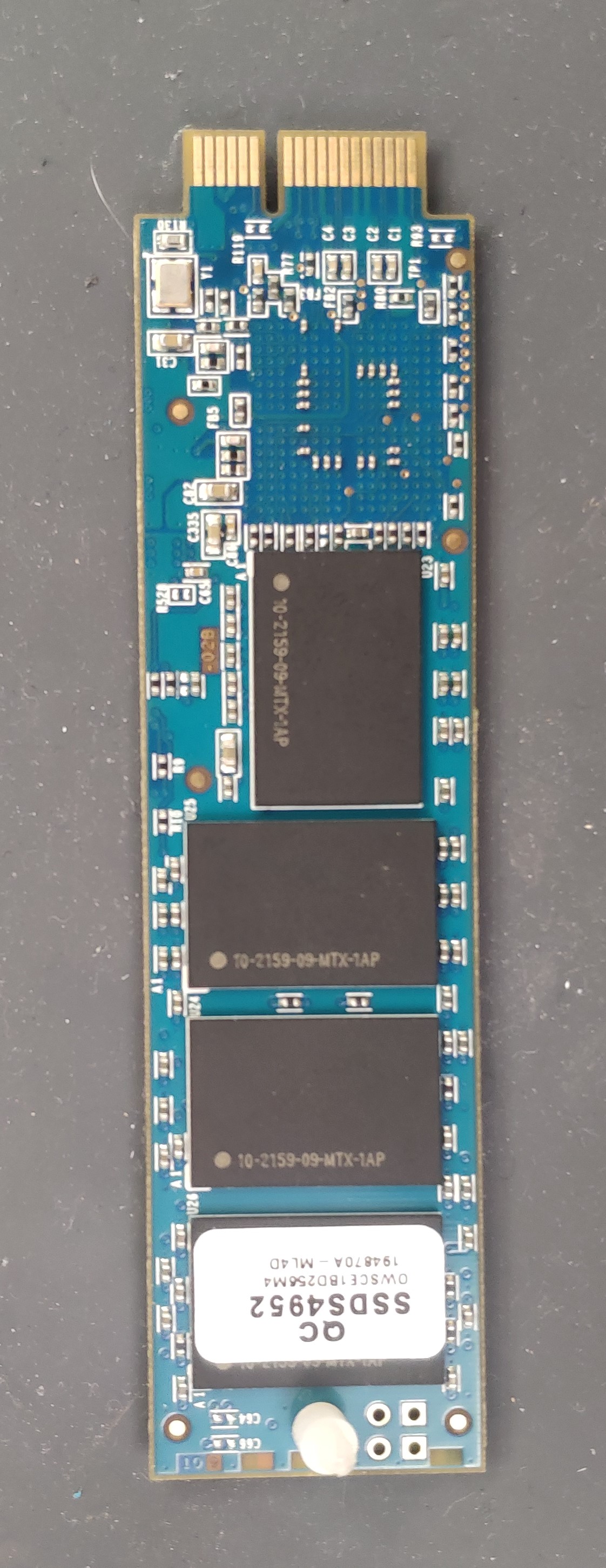

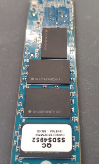

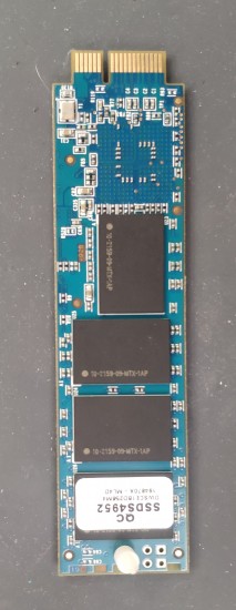

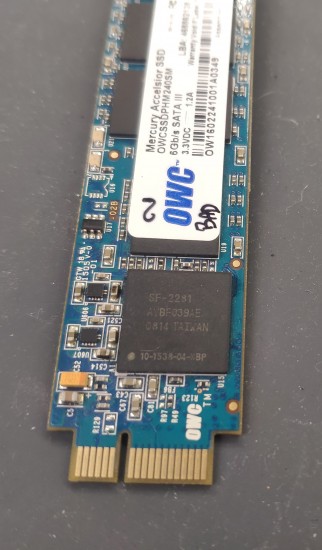

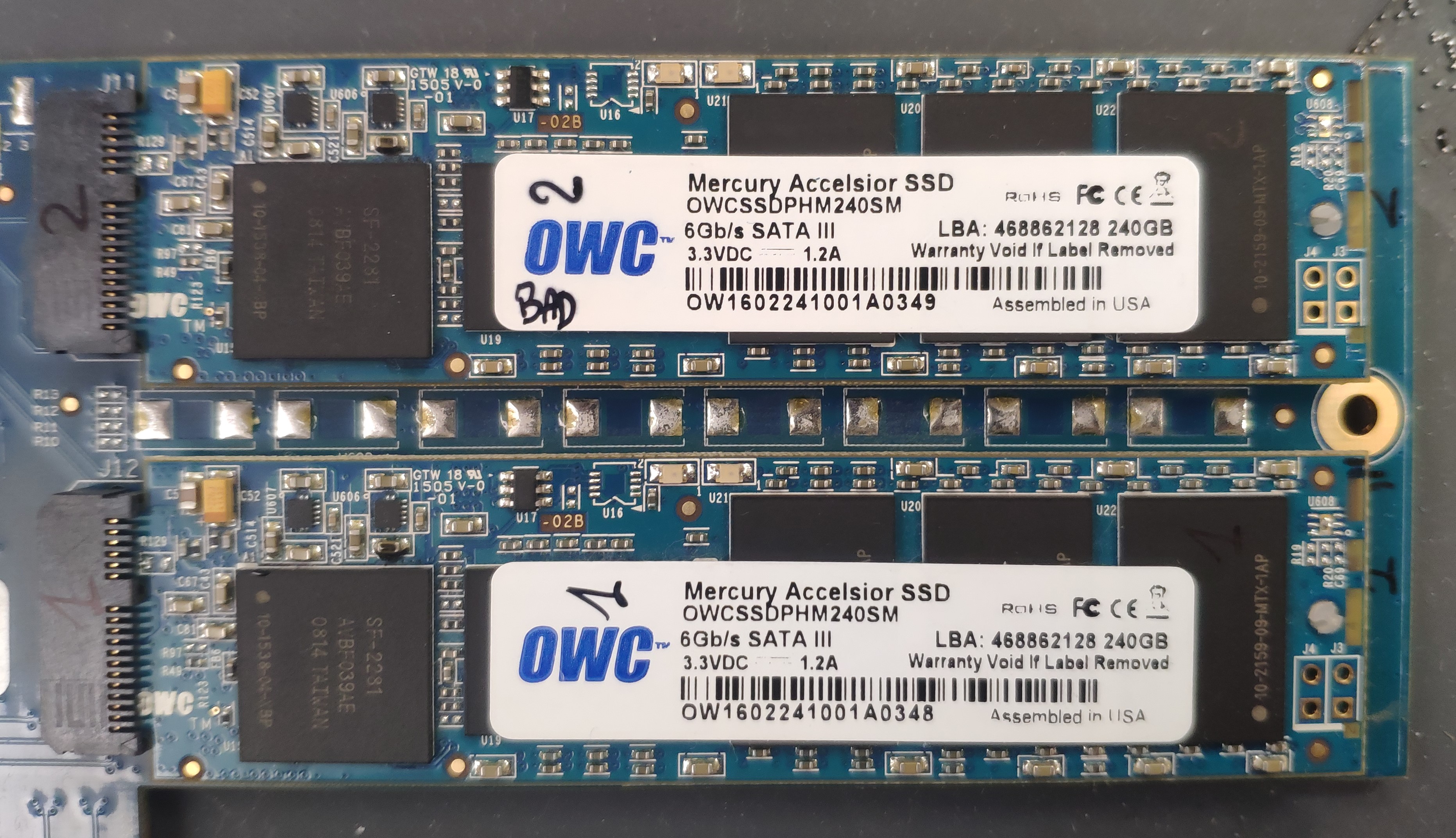

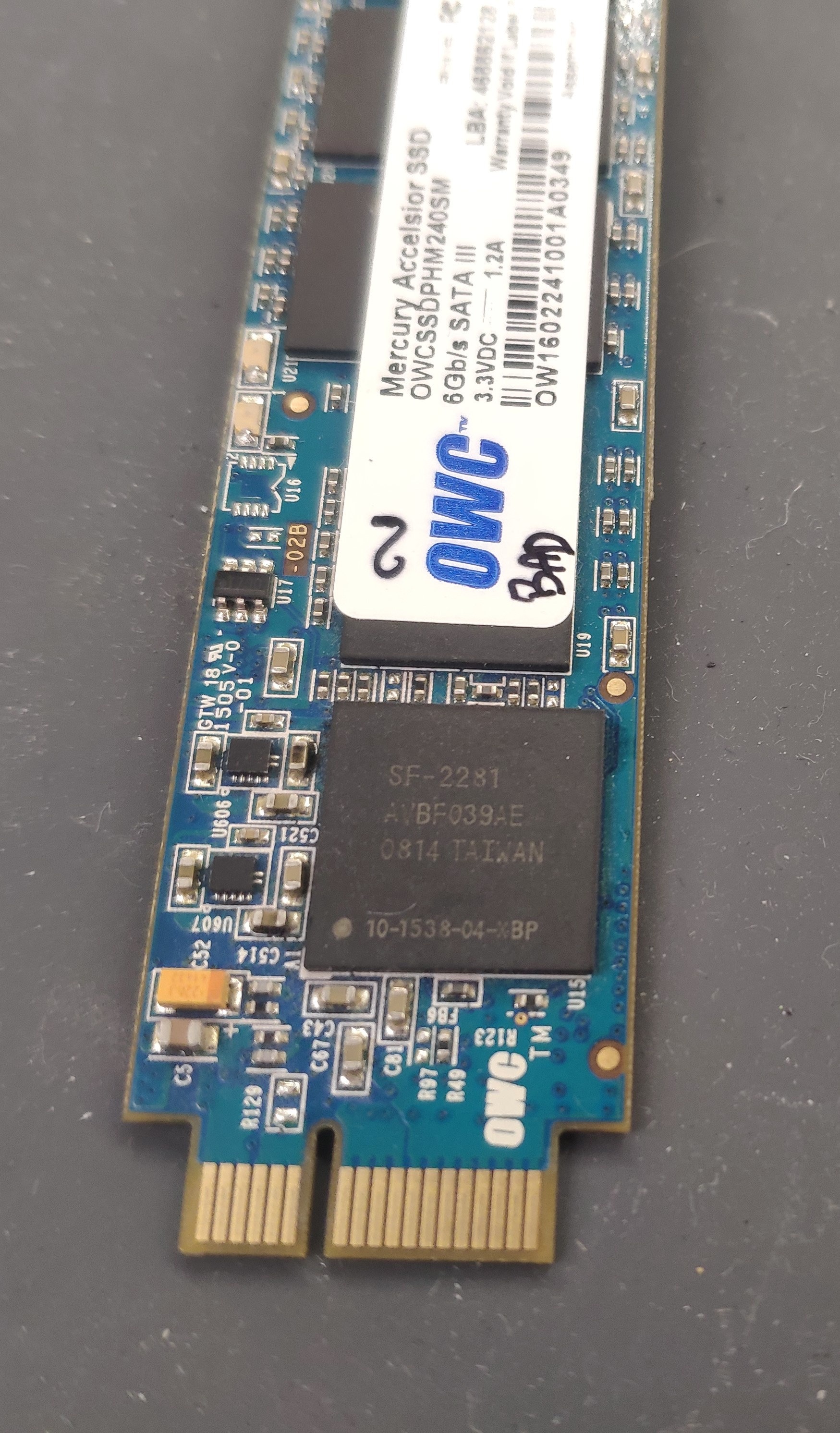

Good evening everyone,

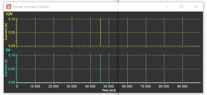

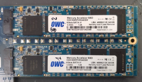

I have a PCI-SSD adapter (2x240gb Raid 0 modules) one of which seems to have gone ko.
I tried to swap it out of slots and it is actually only 1 that is not recognized, the other is online.

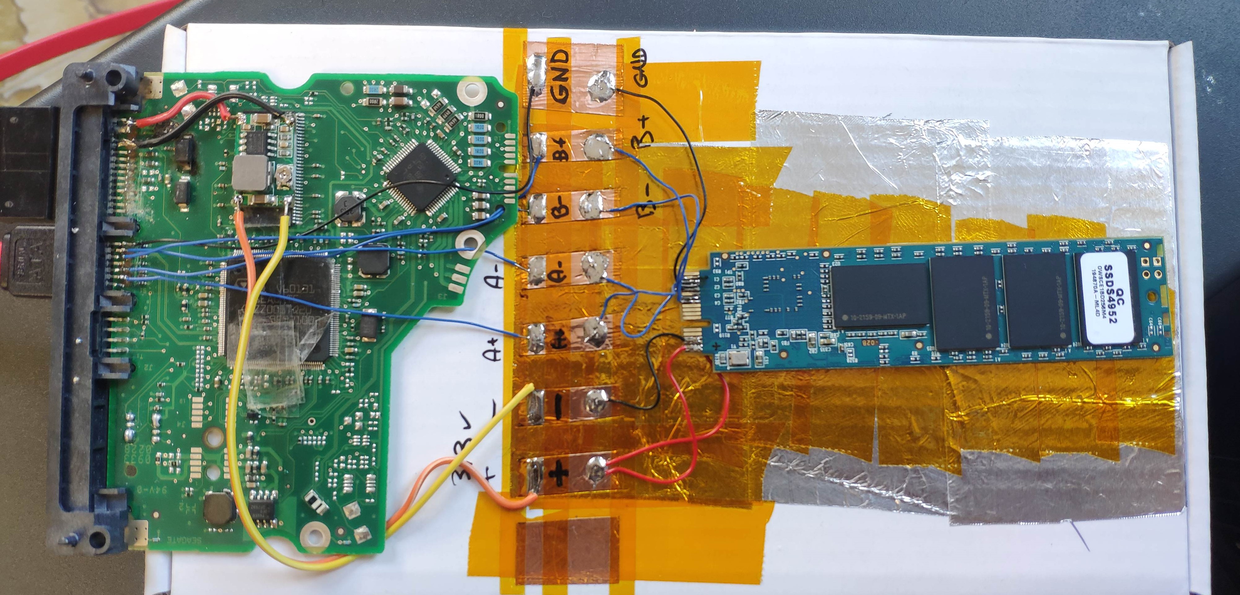

I tried to connect to pc3000 with a sata adapter to capacitors C1, C2, C3, C4 but it is absolutely not detected (I also tried with the working one)

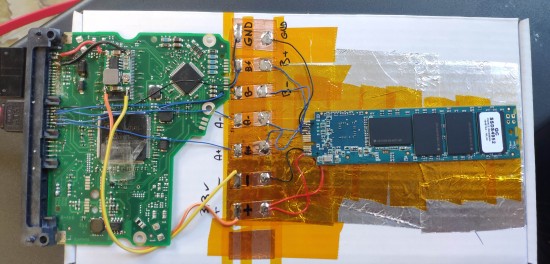

I did not make any notes to the one I had last year, just isolated SATA lines from PCIe board and wired them to a SATA connector.
The one i had, both drives was working, one had a few "bads" RAID was a simple stripe set.

Could it be a DEVSLP issue? Check to see if the DC-DC converters are outputting anything.

@fzabkar,
OP startet a threat on AceLab forum also, he figured out the connections, but one drive is in safe mode.

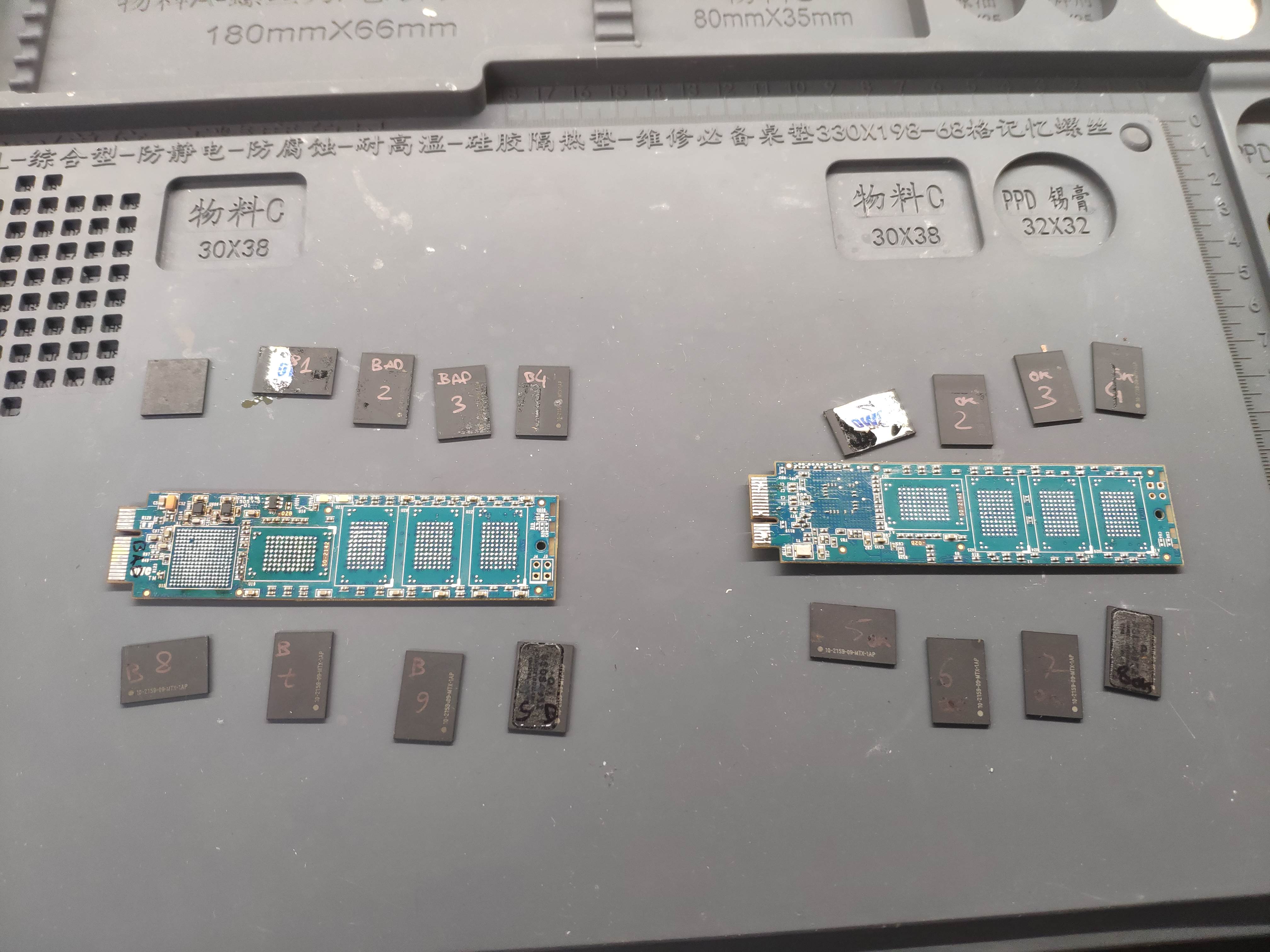

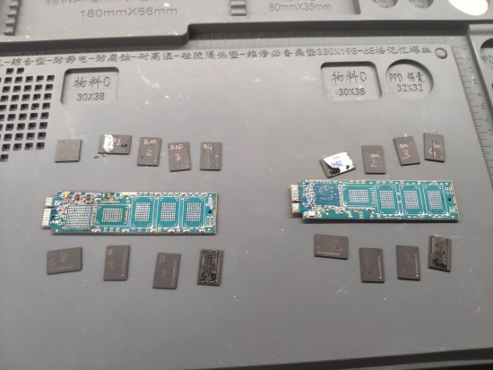

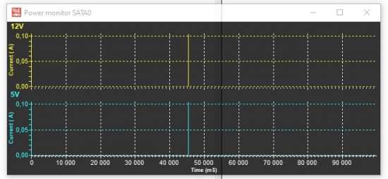

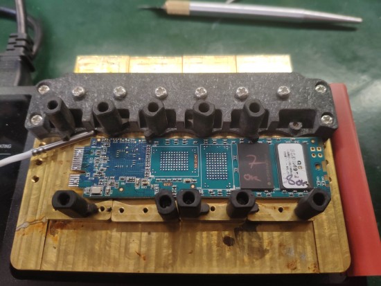

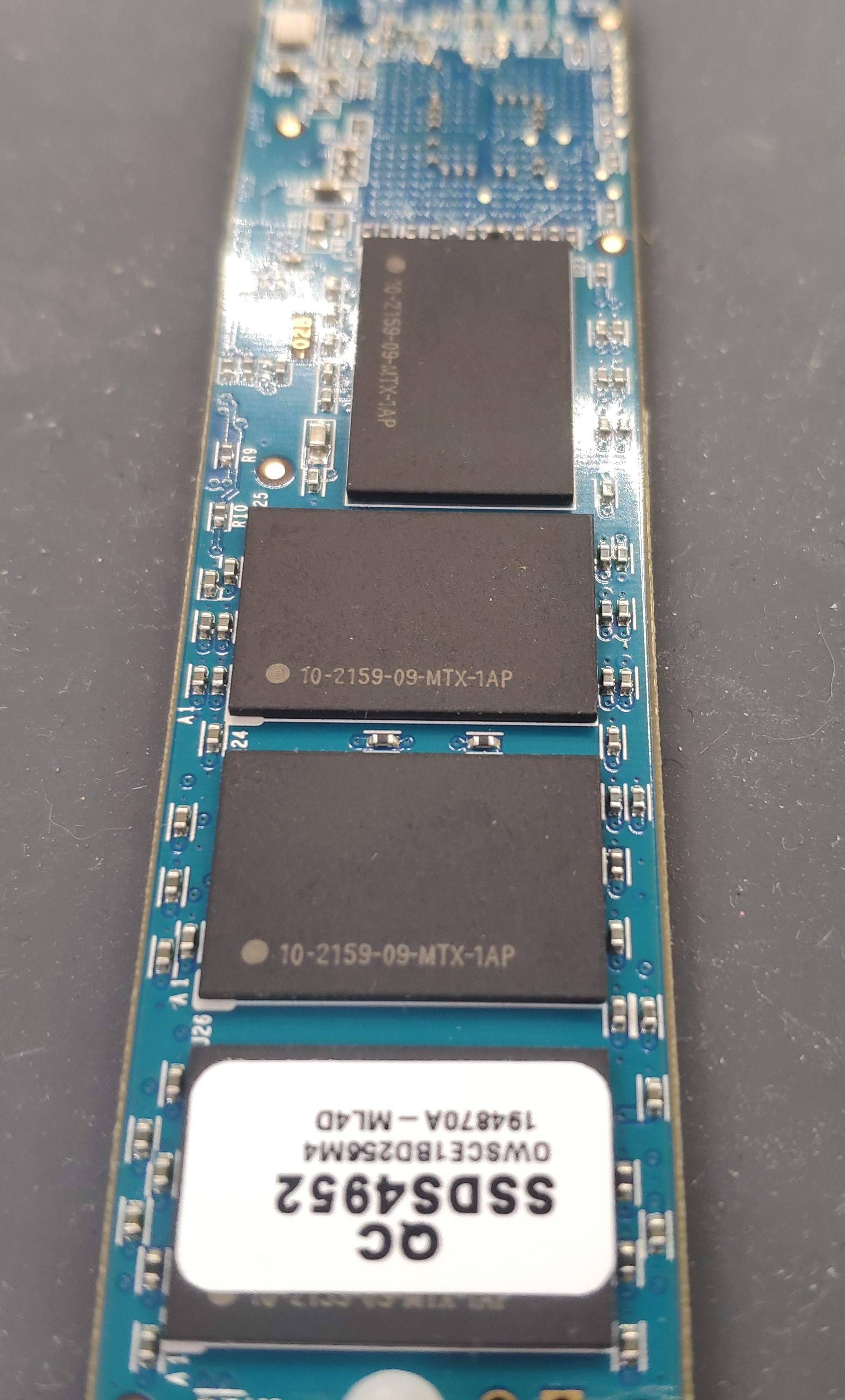

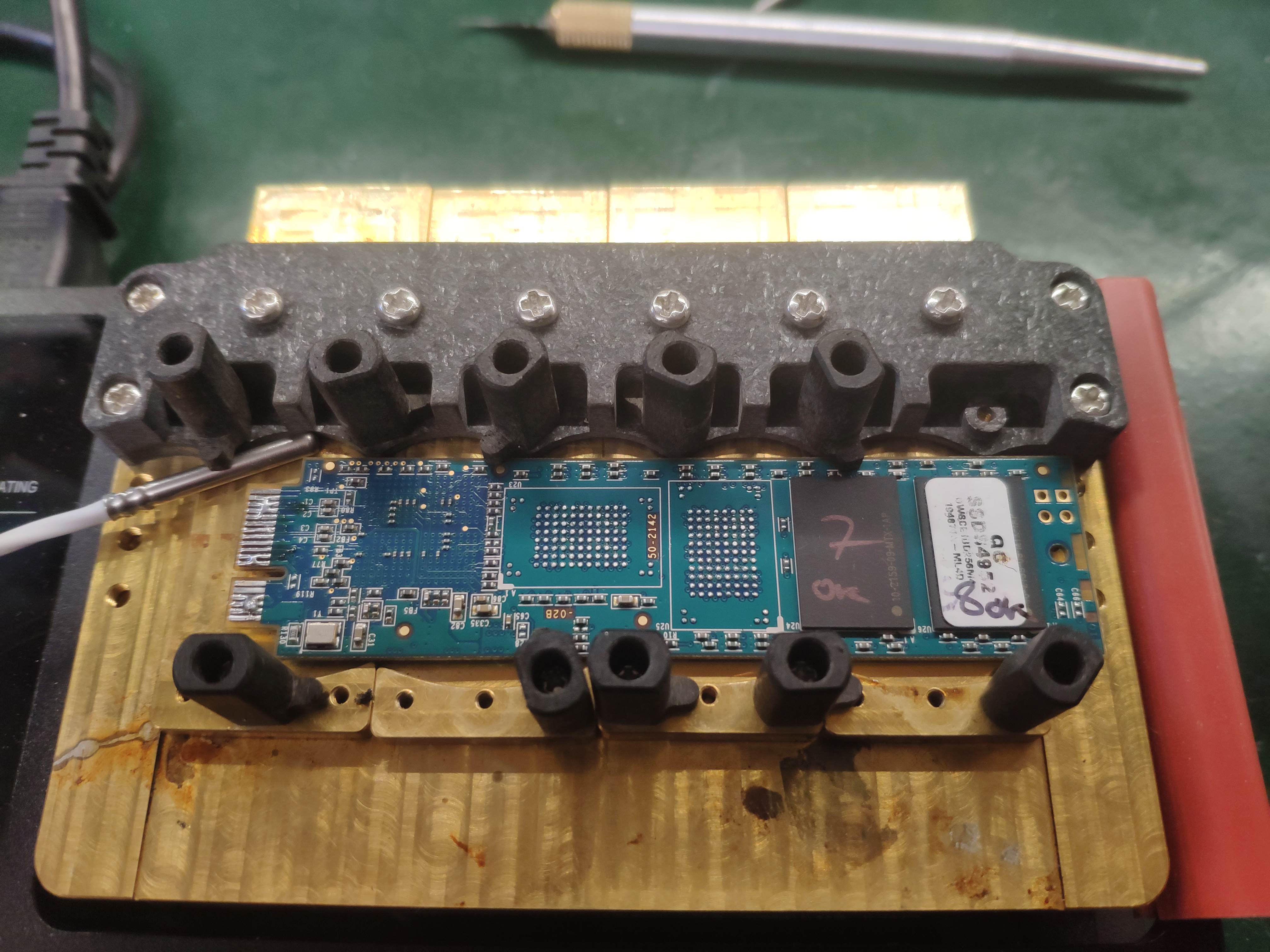

I made an extreme attempt, moving all the memory modules from the failed card to the working one. I got the same result, safe mode
