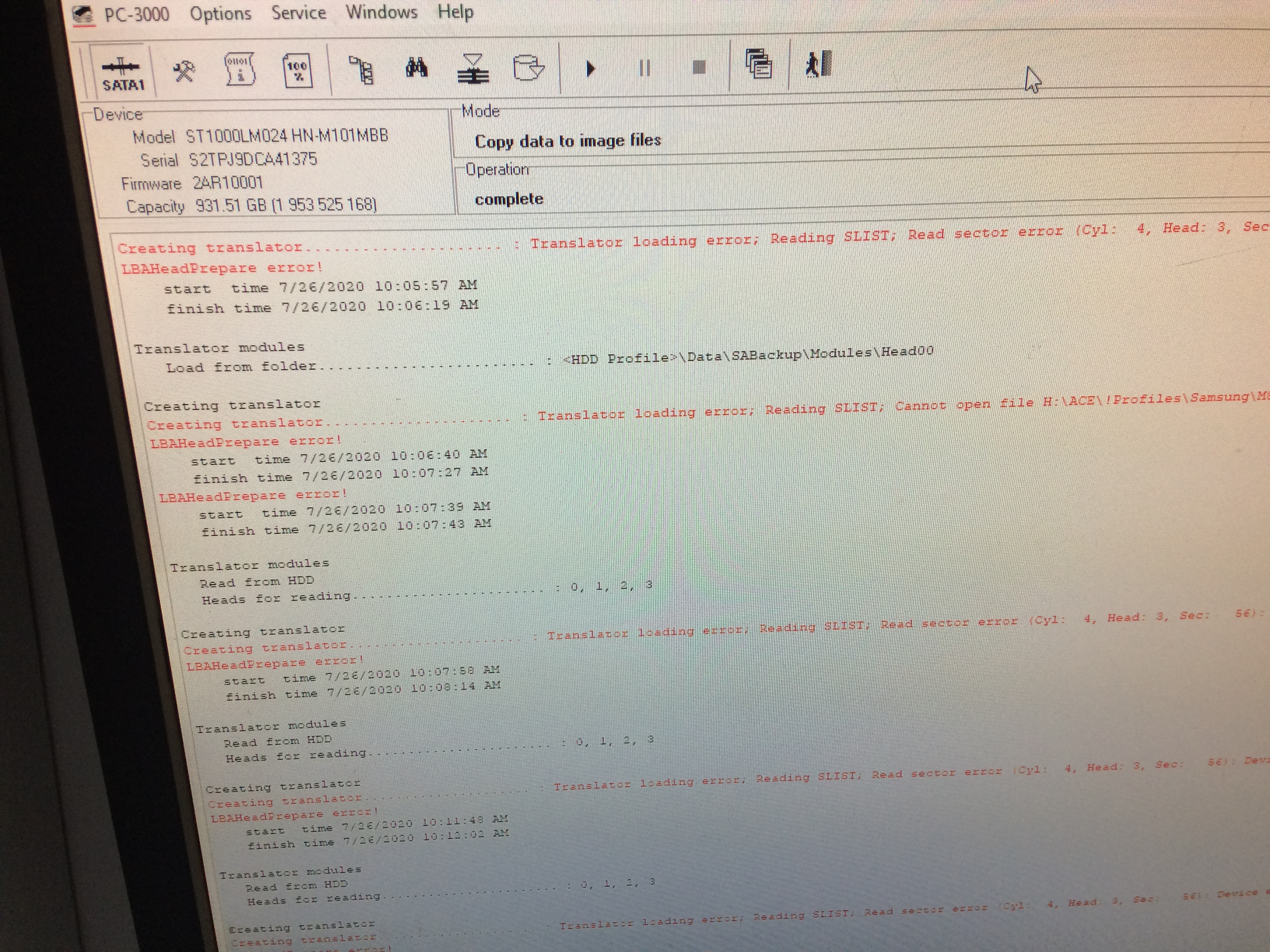

Hi everyone im working on Samsung 1tb u can serial no. And Model no. I have cut head2 as it was having scratches and head1 not ok and slist module is damage in head0 I changed head map in RAM drive detecting I COPIED FIRMWARE FROM HEAD0 but not able to create head map in DE can you suggest me what to do ?
Can I replace Slist module with do ornate drive module ?

No you cant. Slist is very significant to be original.

is it damaged in the used area? If not, you can still use it for head map building, however, you need to convince the drive to load it somehow.
