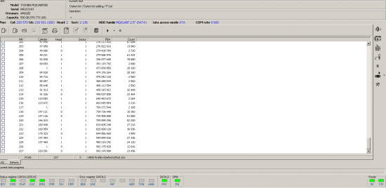

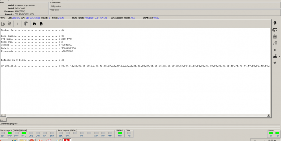

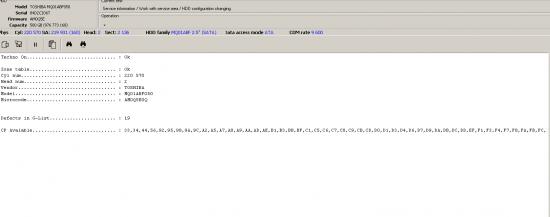

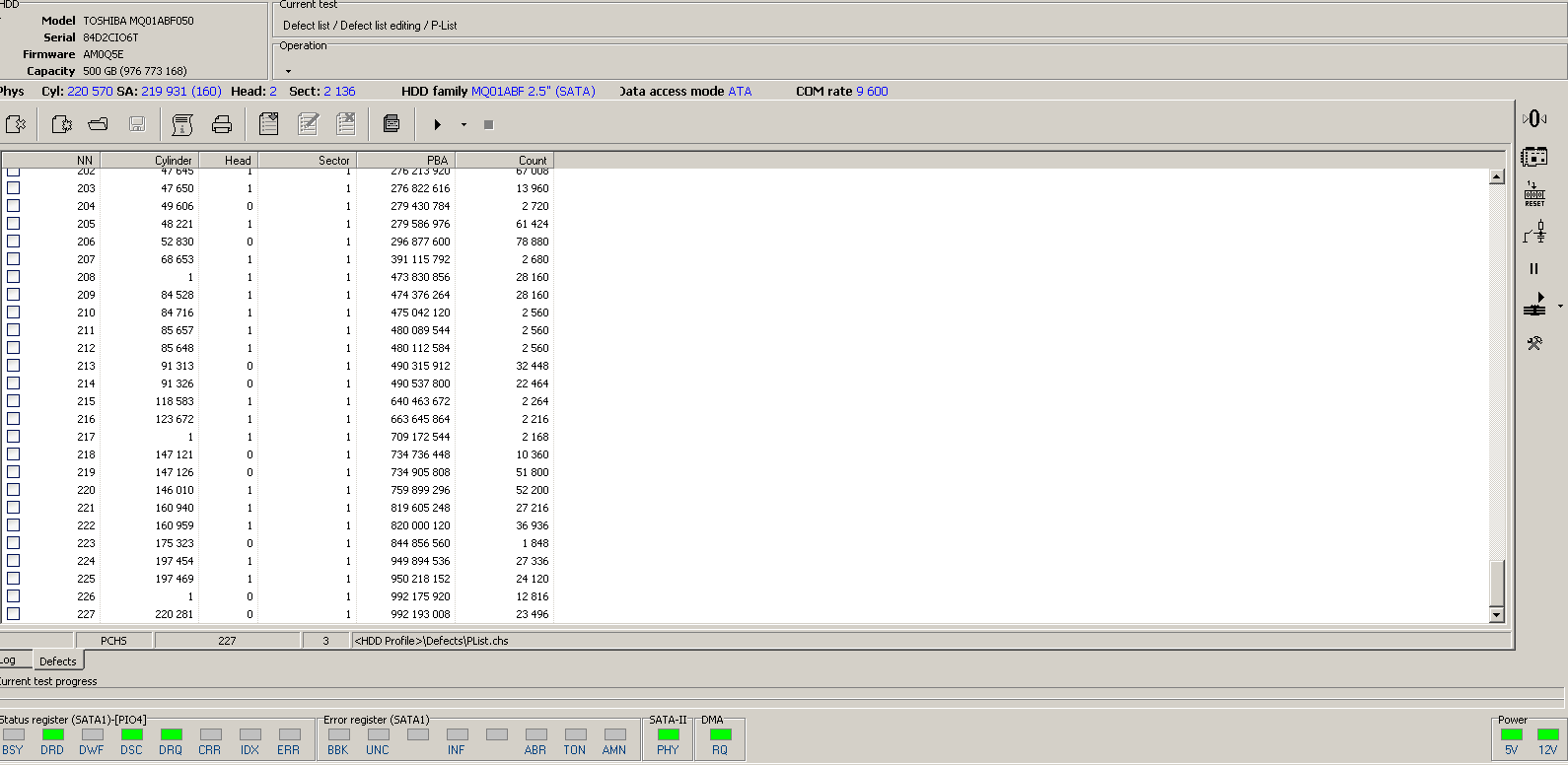

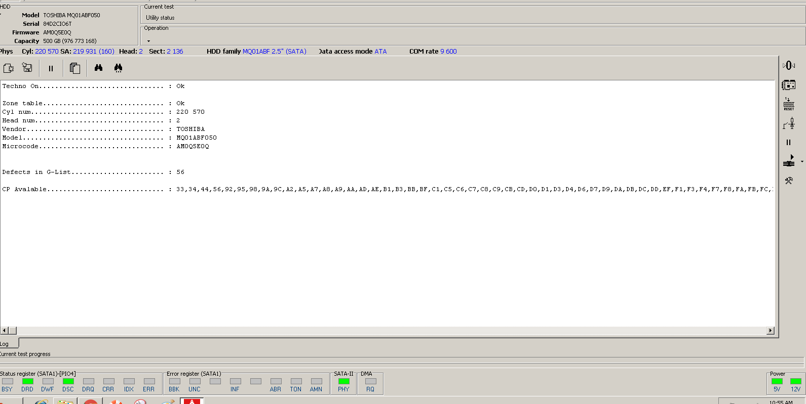

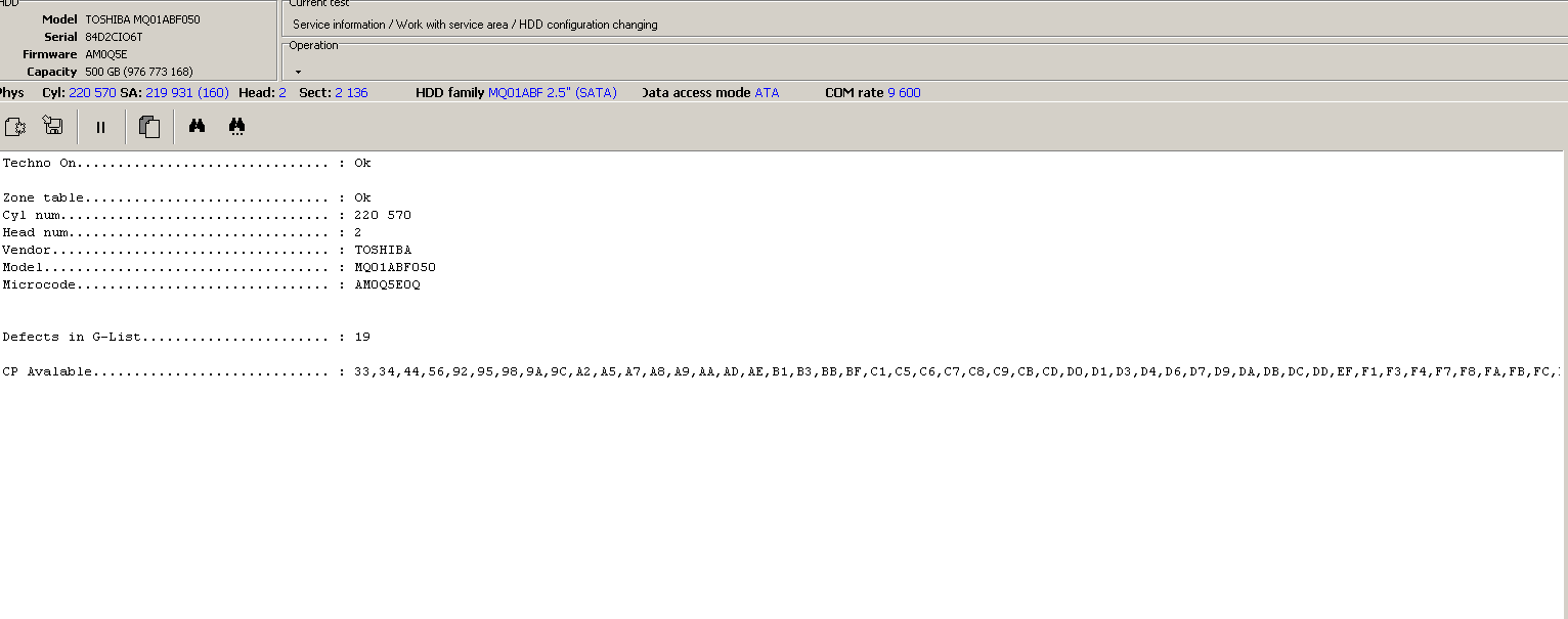

I am working with a Toshiba MQ01ABF050 hard disk .It has normal detection ic pc3000 Toshiba utility. I could read Glist Plist etc.
However disk is continuous surface defects and recovered data is of no use due to skipped sectors .
Initially Glist was having 268 entried. I tried a lot and finally moved Glist into Plist.
This is not working and I am still getting bad sectors every now and then.
Now Glist entries are getting increased steadily as well (from 29 to 56)
What is causing these entries ? Why I am getting so many errors in reading.
I tried to read through utility including Glist damage in translator optopns but nothing is working.
Can someone pls. shade a light.

If you have bad sectors, it's normal that the G-List (Growing List) will also increase, since the drive will mark them.
This is a hint also that the drive is giving you: It can die fast.

Wo Thanks a lot pclab :D
Now I understood , Drives platter itself is the cause. Due to defective platter G-list is increasing,
