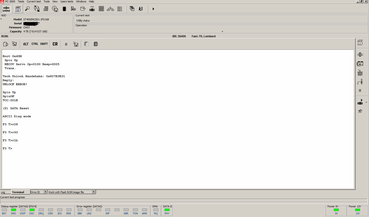

Hello guys,
I have tried to acces this drive, but i never see this drive before, and his comportment its a little different and I think his doesnt have any support from ACE LAB.
Its ready but when I try to read any module, he dont respond, just back to the terminal.
I can't acces any sector, what I want is acces the modules to fix then.
below the image, anyone have seen this before?

what's the drive family? Is it really Lombard??
Yes is Lombard
 Post subject: Re: ST4000NC001 Terascale
PostPosted: February 1st, 2023, 18:58
Posts: 4848
Unlocking lombard differs from most of the others, no need to patch rom, that's why the rom patch did not work for you.
pc3k can unlock it using the button on the toolbar on the right...
... or manually if you know how...
Thank you pepe! It worked!
