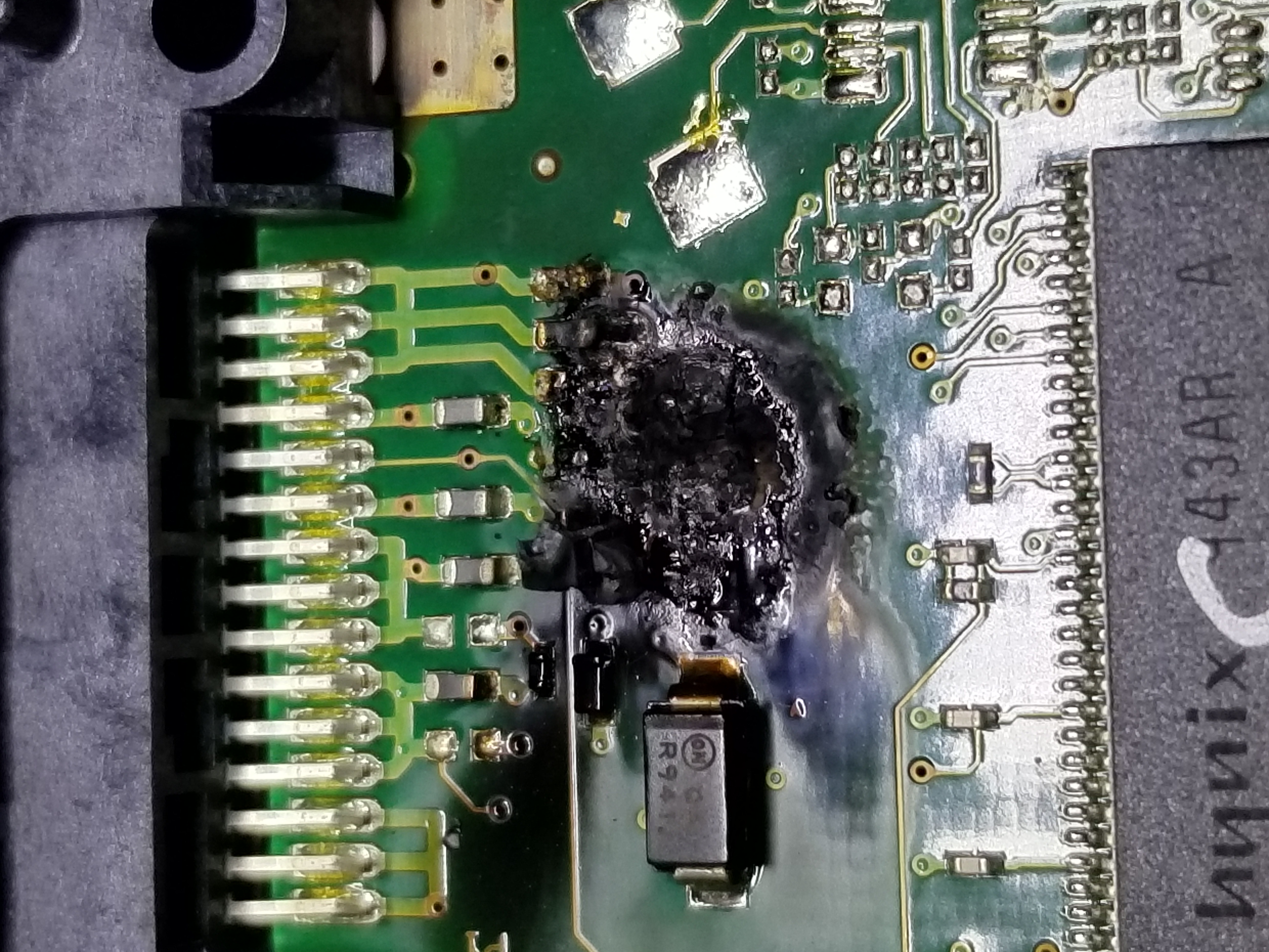

It's a weird one that's for sure. Drive had a power surge that took out the PCB and ROM. Swapped for another PCB and can get access to the drive with several 08xxx ROMs. I can see from mods what firmware the drive is. I did get sent matching firmware yesterday (seemed like a perfect match). But when I upload the ROM to the PCB it never comes RDY. This is exactly the same issue with the original ROM which made me think it was corrupt. But like I say I can get access to SA via an 08xxx ROM. I asked ACE to log in and take a look in case I was missing something (drive is 2006 so don't see that many). They confirmed from the SA the FW is 06.04C.
Its a head scratcher. It acts like the donor ROM is not the right firmware. Client said the drive did not go to anyone else before coming to us. In fact he had two drives affected by the power surge and we recovered the second.

I would check the resistances. Your PCB was prone to failure in this respect.

Sorry I meant to post a pic of the PCB.
Checking resistance might be an understatement in this case....
We are using a fully working donor PCB.

What is the PCB number? Could it be that the patient ROM does not match the donor's MCU?
AISI, the overvoltage was on the 12V rail, so the preamp is unlikely to have been affected.

ddrecovery wrote:
drive is 2006
That doesn't make sense. I think the PCB is not native. The date codes on the 5V TVS diode and SDRAM are 941 and 943, respectively. That's weeks 41 and 43 of 2009.
So where did the patient ROM dump come from? :-?
Sorry, my dumbass fault, that was the pic of the Seagate PCB.
I can confirm the MCUs on patient and donor do match.
It was from the patient ROM. As it didn't come RDY on the donor PCB I presumed it was a bad PCB.
Now the donor ROM doesn't work that hypothesis may not have been correct.
