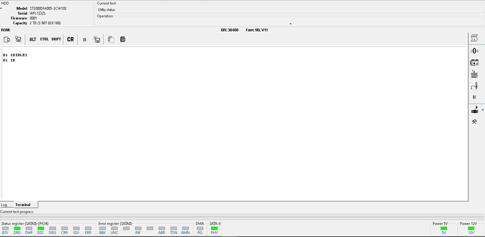

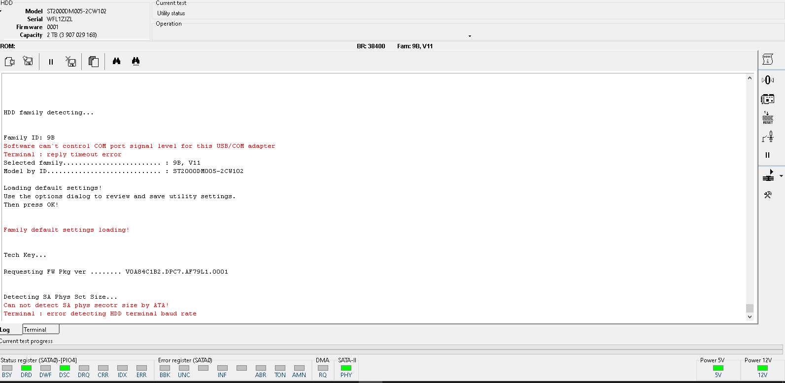

Disk Details -
Seagate ST2000DM005
FW - 0001
Terminal --
Di 1DIDLE1
Di 1D
ASCII Diag mode
F3 T>
ASCII Diag mode
F3 T>
[NECS.anot:00000024,00000000-00000000,00000000-00000000,00000000]
[NECS.not:00000000,00000000,00000000-00000000]#
CBEMF 0x47 0x00000004 DataLength: 0000266C
CDW. 04 Index: 00
CDW. 05 Index: 01
CDW. 01 Index: 02
CECECECECECECECECECECECECECECECECECECECECECECECECECECECECECECECECECE
Boot 0x0100MAF79L10001
SpinUp
TCC:001E
Trans
Rst 0x0100MAF79L10001
(P) SATA Reset
NVCScram Saved HB Size:020A
LD: MD_Alloc:00000090 HB_Alloc:0000 MD_Alloc:80380000 HB_Alloc:8032 FlashRestorePowerDevReg 7E: 7001 PowerDevReg 7D: 0044 MD_Saved:00000090 HB_Saved:00000000 MD_CRC:C730
PP: MD_Alloc:00016800 HB_Alloc:0000 FlashRestore
PVTSize: 0002417C CompSize: 0000266C DeCompSize: 0002417C MD_Saved:0000266C HB_Saved:00000000 MD_CRC:DDFC
MC: MD_Alloc:00003000 HB_Alloc:0000 FlashRestore
DataLength: 00000310 MD_Saved:00000310 HB_Saved:00000000 MD_CRC:4C0E DataLength: 0000266C
DSP0C72
2Sync:0 4
MCMainPOR: Start:
Media Cache Data Base 00E8E088B0 ODUmpEndHostLba = 08FC6688 IDUmpStartHostLba = FFFFFFFF
Check MCMT Version: Current
Primary is latest! - 00000001
MSPSequenceNumber(Disc) 000BD2CC
MSPSequenceNumber(MCMT) 000BD2CCMS UDE detect during recon LPCDisc=00 11FC9F10 004E
MS Read Fails: 8FE4CAE0,00006BC0
NECS: CorruptedSectorsRecon - Head:000091FE Tail:000091FE
LastWrittenDiscLBA : FFFFFFFFFFFFFFFF
MCMainPOR: MediaCacheDiscStateFlags 0000002A MCStateFlags 004000C1
6Gb Max Speed lowered to 3Gb for Intel bug
Send Status: COMRESET seen
FIS34
ENP0C72
2Sync:1 C
[MCMTW_DSW] Secondary - 000BA00AIDLE1
Di 1E
Di 1E
Di 1E
Di 1E
Di 1E
Di 1F
Di 1F#
CBEMF 0x47 0x085BB304 DataLength: 0000266C
CDW. 04 Index: 00
CDW. 05 Index: 01
CDW. 01 Index: 02
