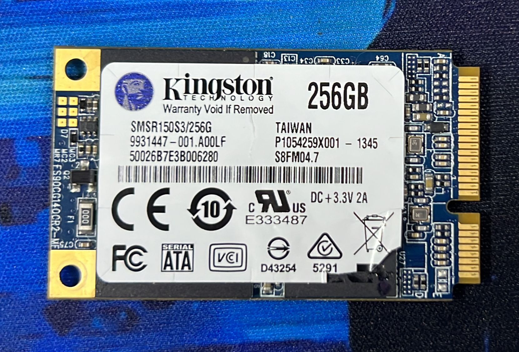

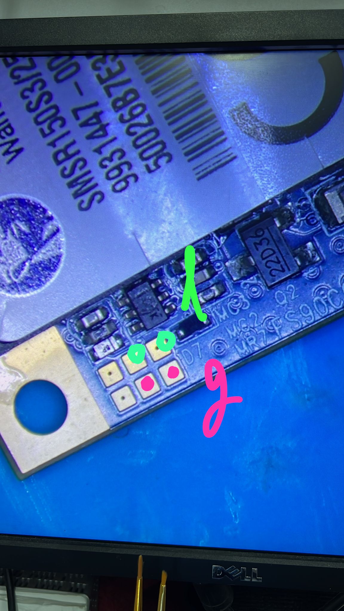

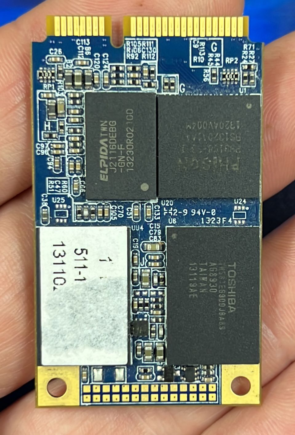

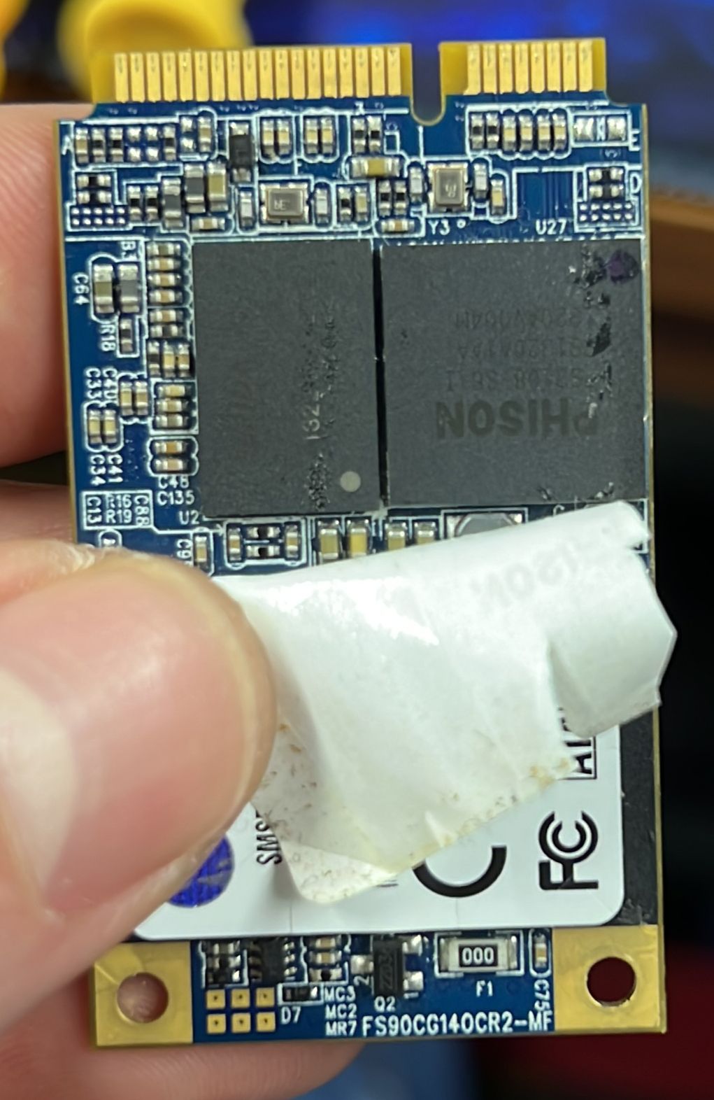

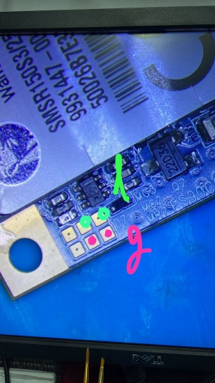

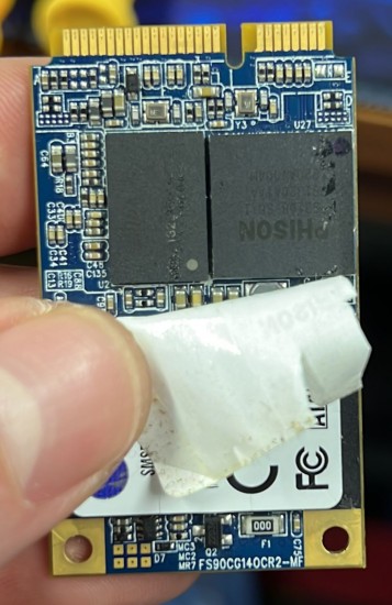

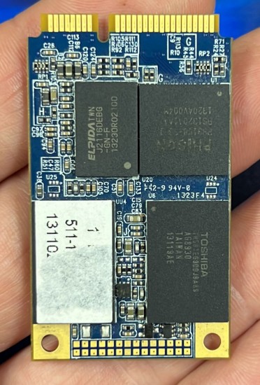

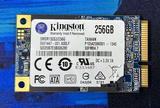

Hi friends. Interesting device for data recovery. Kingstone Msata disk 256 GB. drive with two PS3108 controllers. These are Two physical disks in a raid 0.

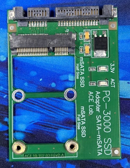

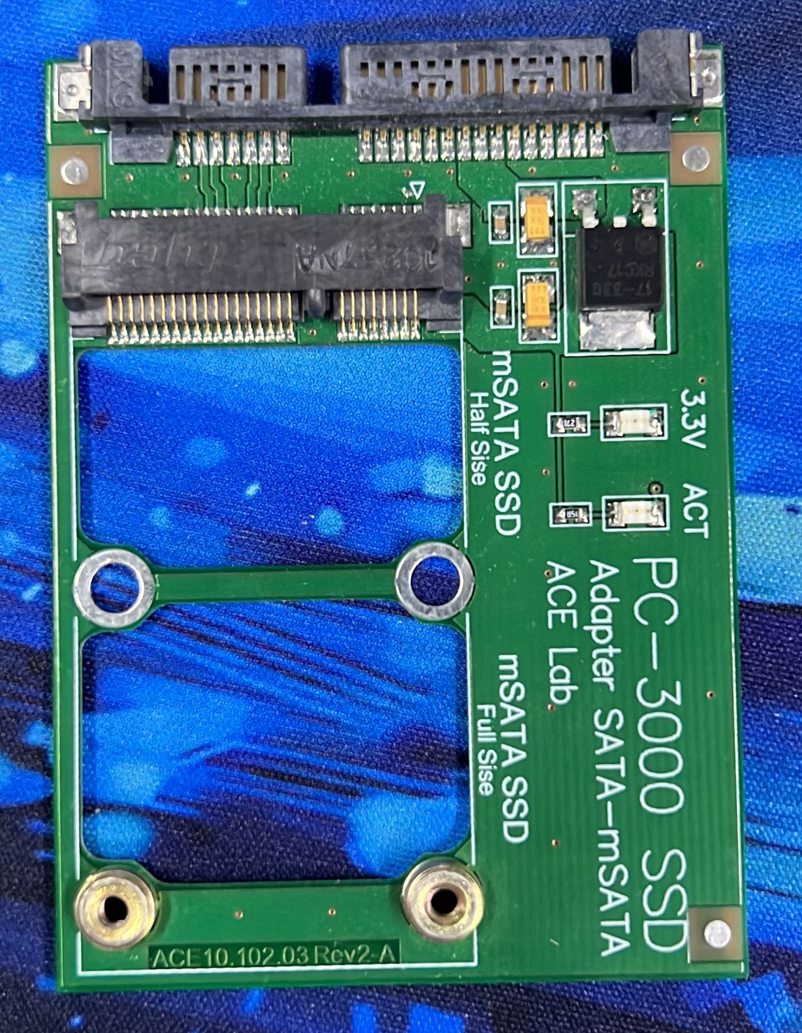

How did you recover the data?
1. Regularly connected to the msata to sata adapter and read first 128 gb to image file.

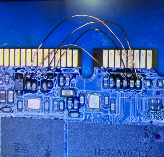

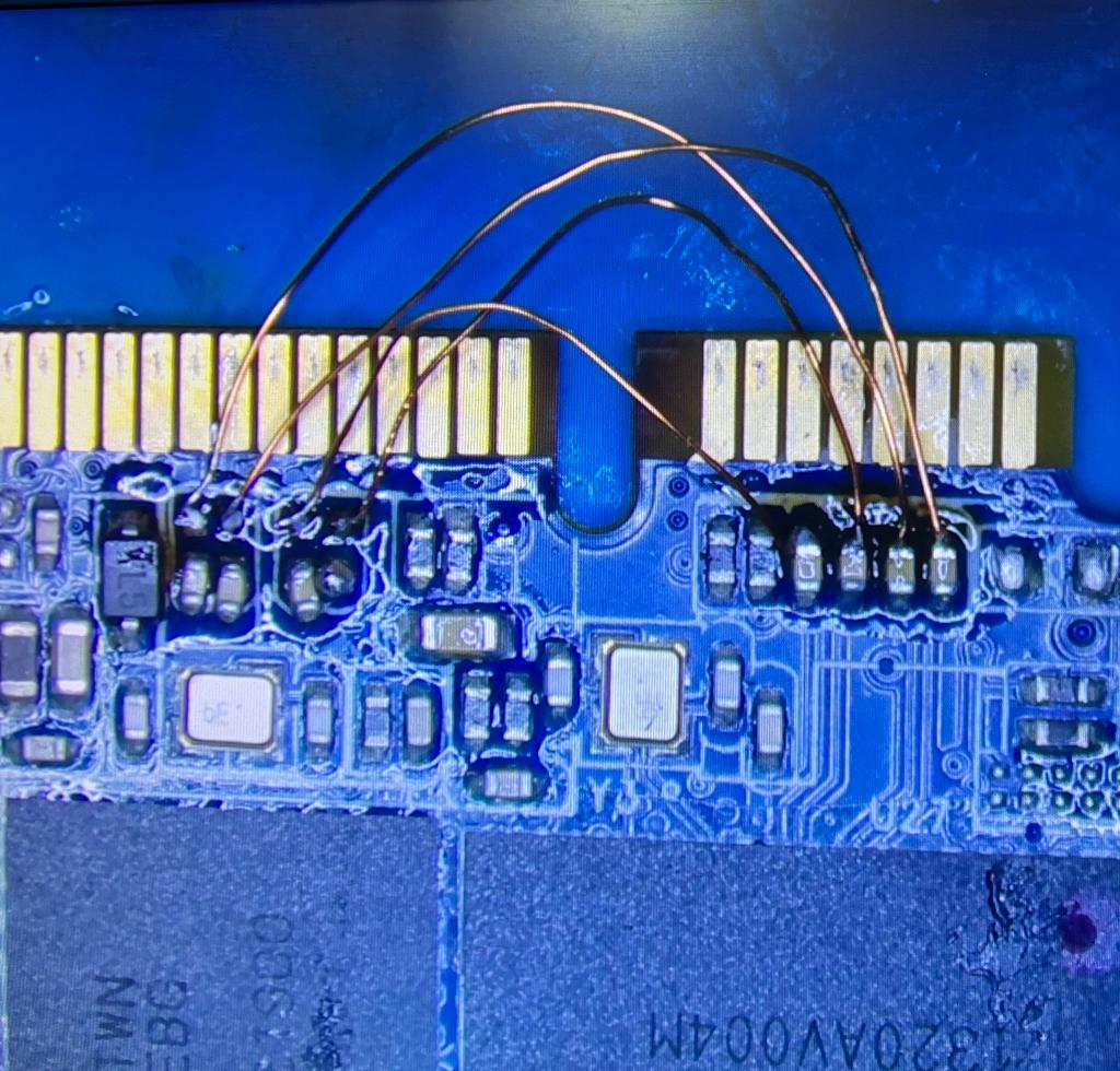

2. removed 4 capacitors from sata connector number one and soldered jumpers to the second connector. and read the second 128 gb to image file.
3. uploaded two image files to DE Raid and recovered
p.s. this drive has 2 save mode
