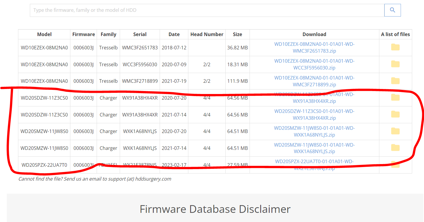

I am looking for Firmware backup/resources for the following Charger drive:
WD20SDZM-59TM5S1 ROM F/W version 0006003J
Not available in HDDSurgery.
If you can share, I will really appreciate it.
Thank you.

err, sure?

Thank you for your reply Northwind.
Yes sure. They don't have FW resources that matches Model number and Firmware version.
In fact I downloaded the ones you showed and could not fixed the problem.
The drive I have, Charger USB-C with unlocked SATA PCB, has MOD 2 with one bad sector on both copies 0 and 1.
I tried to use MOD 2 from the firmwares available at HDDsurgery that do not match Model but match FW version and
was not able to fix the problem.
Acelab Tech support also checked the drive and could not fix the problem. They also did not have identical model and FW.
All attempts were with resources that do not match model number only FW version 0006003J and did not work.
That is why I am looking resources for WD20SDZM-59TM5S1 ROM F/W version 0006003J.
