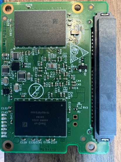

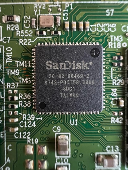

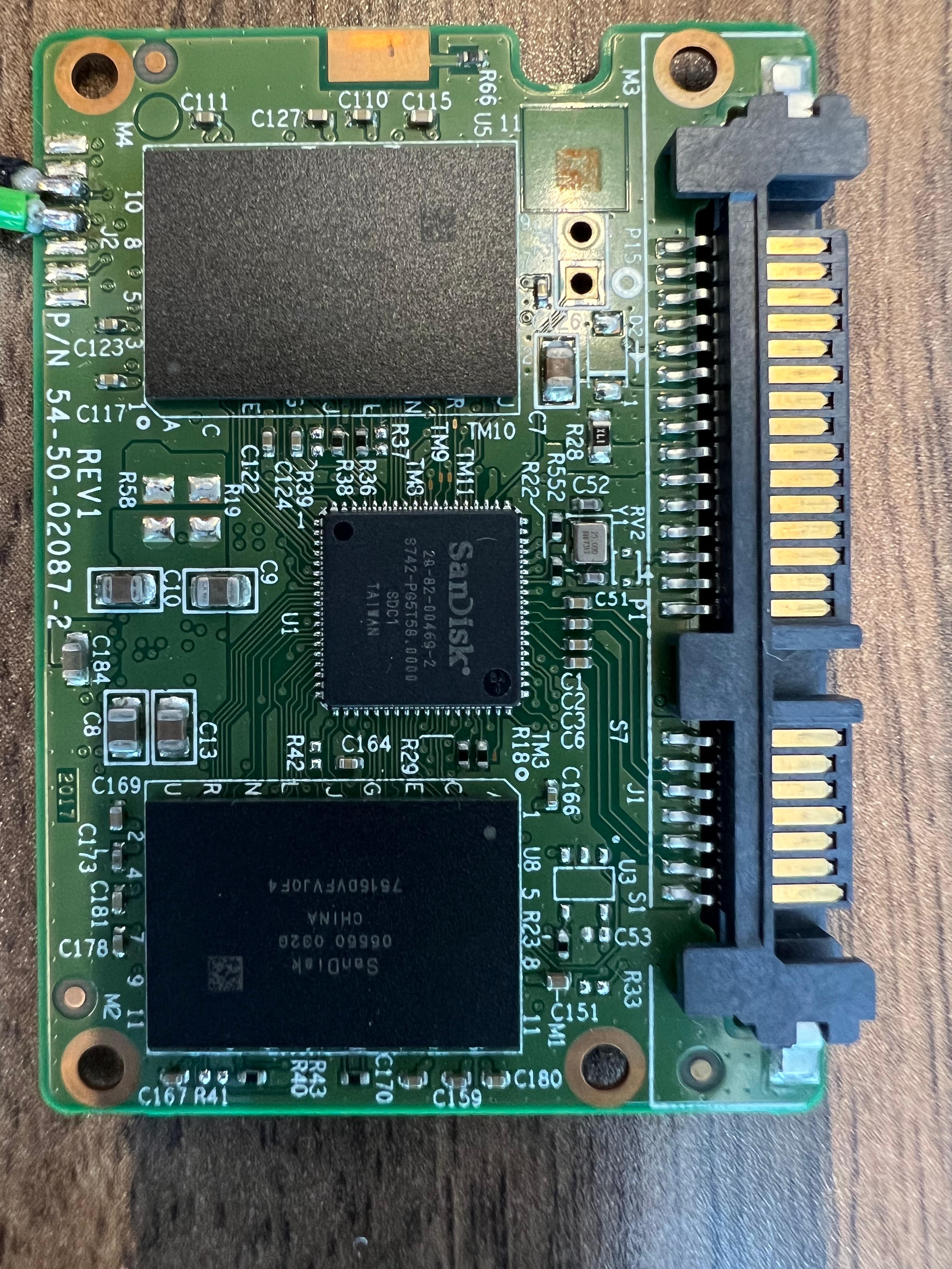

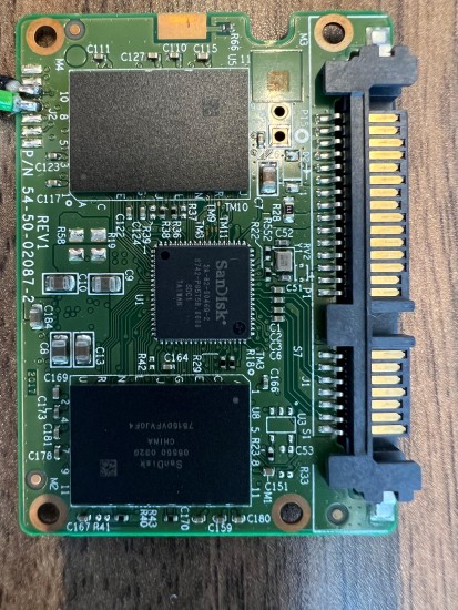

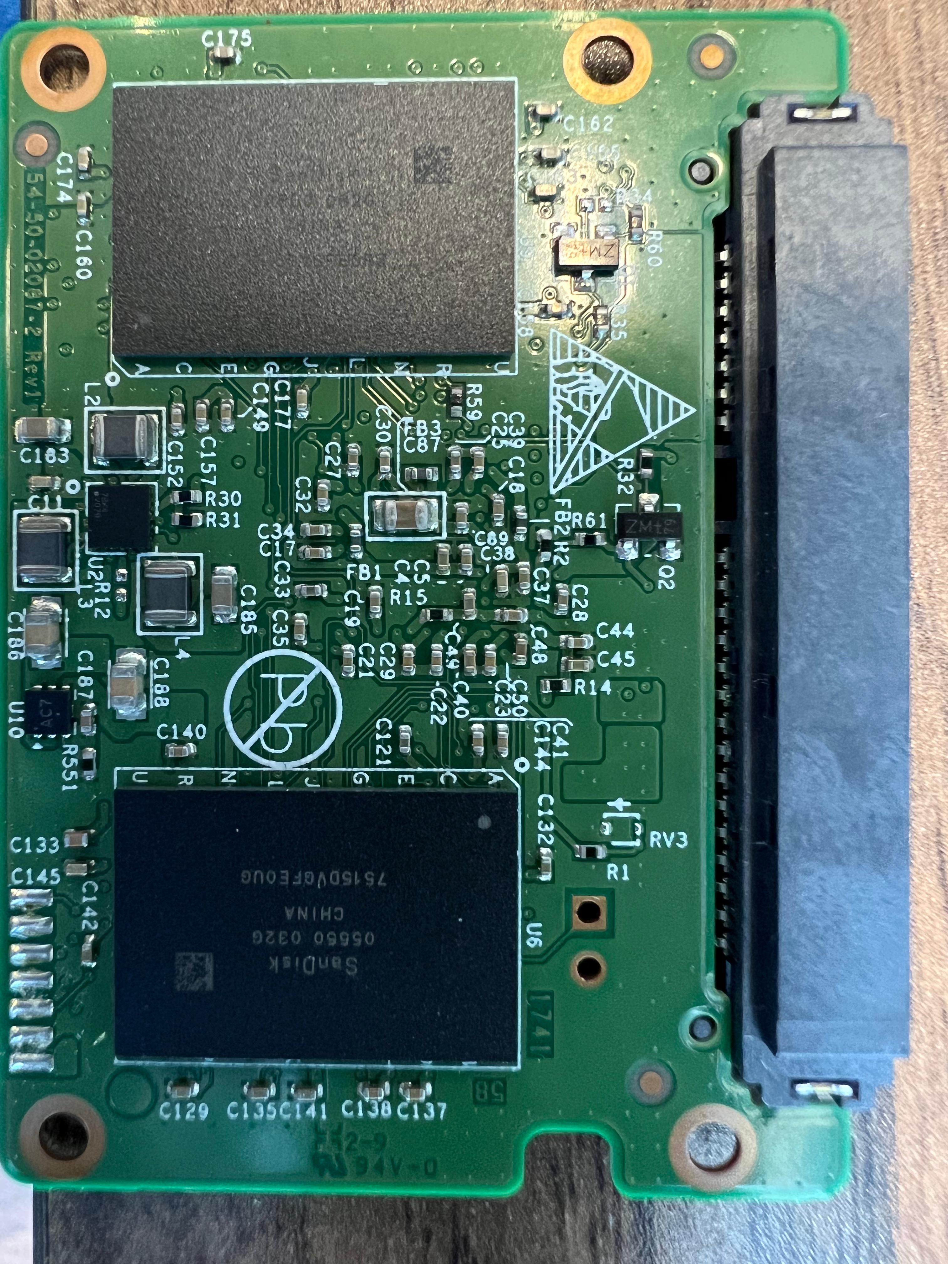

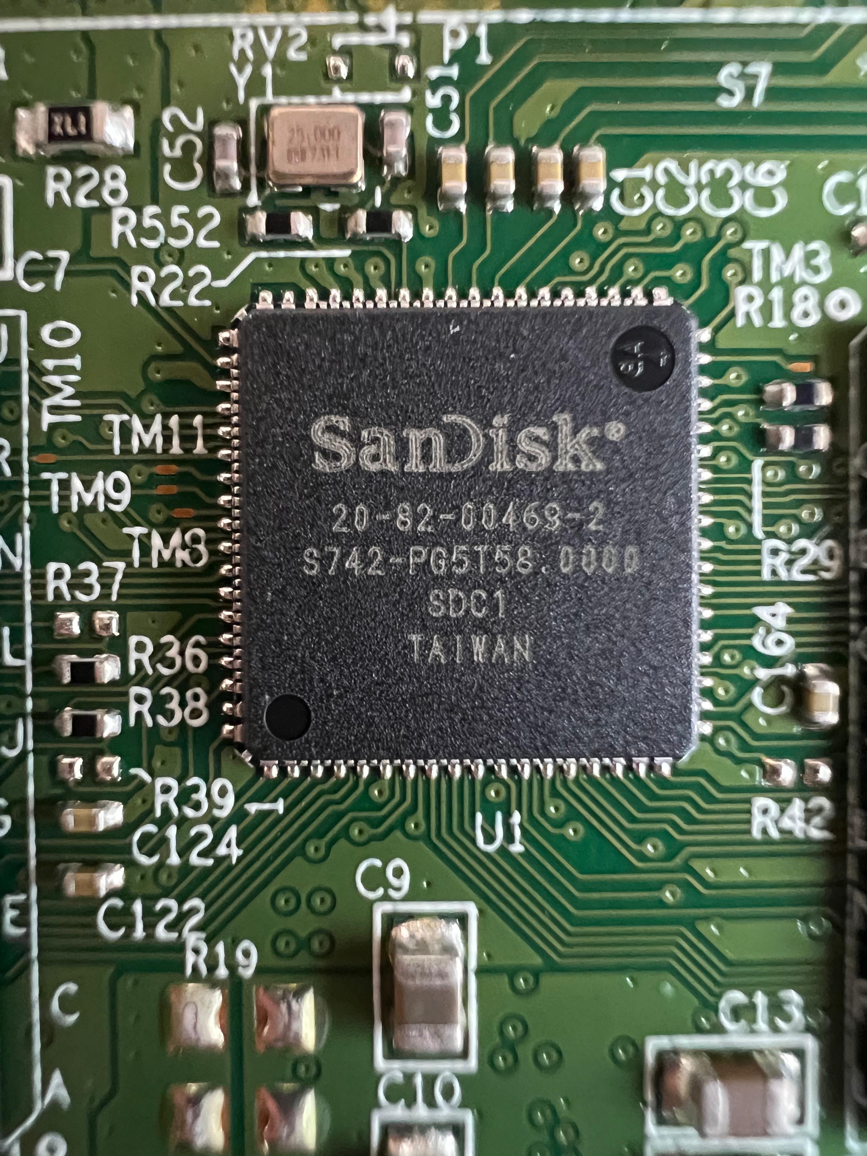

Hi Everyone,
I got the following drive:
Sandisk SSD PLUS 120GB
Model: SDSSDA-120G
Based on Sandisk controller please see the attached pictures.
Is this drive supported by PC3000 SSD?

At current day no supported.

Hi ,
You mean no support in PC 3000 SSD Tool ,But this Controller Is Supported By VNR/FE Chipoff ,I am Currently Doing 2 thanks for your help regarding NAND Config .But Michael i feel its very very long process for Reading 128GB NAND's that are TLC and Each Dump is approx 150gb plus ,Then ECC correction and Without Read Retry these chips are a PITA ,I can say a 480 GB might take 15 ~ 30 days to recover ,And a customer should understand that time we can do nothing else with tool As chip is physically in Tool .
