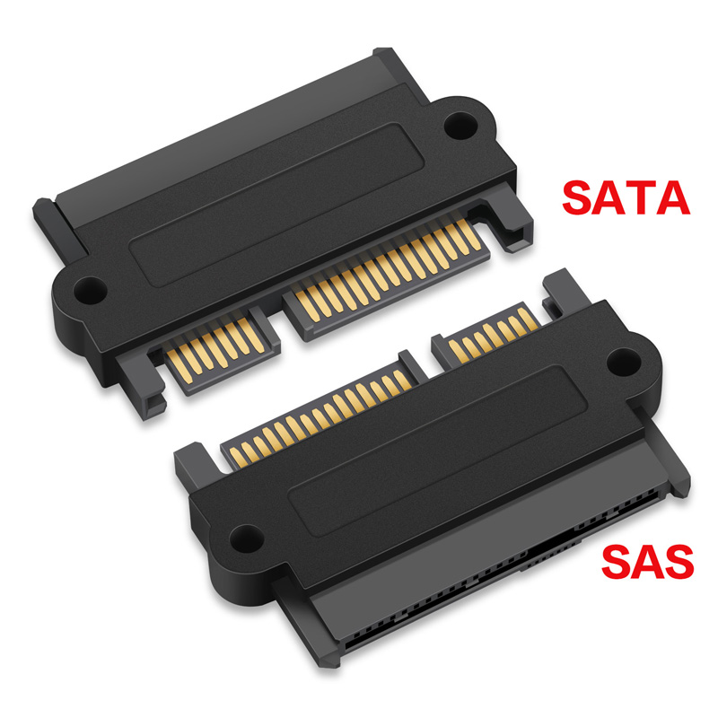

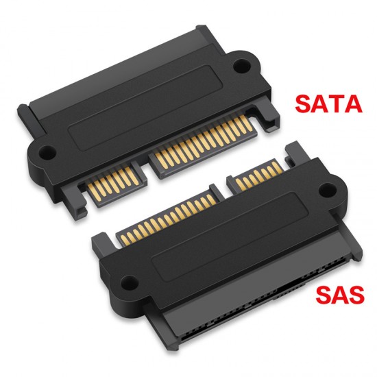

sempre wrote:
sempre wrote:
Hello!
:mrgreen:
Has anyone tested the SATA to SAS Adapter on the pc3k express? does it work for data extractor?
sorry, sas to sata!
if you mean the attached one, no it does not

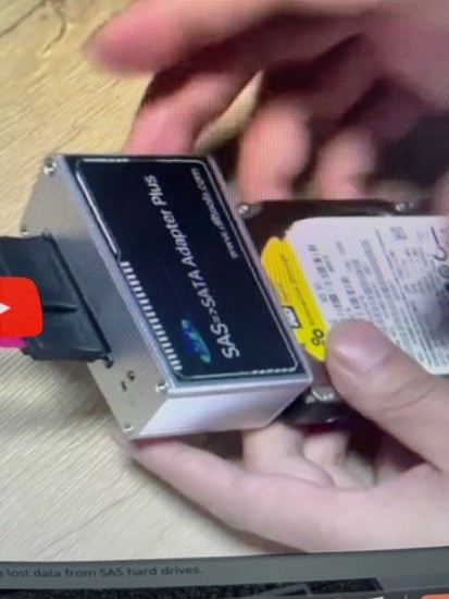

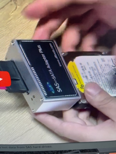

 Post subject: Re: Adapater
PostPosted: August 18th, 2023, 4:15
Joined: August 28th, 2017, 3:27
Posts: 16
Location: Manaus
sempre wrote:
Hello!
:mrgreen:
Hi! To work in Data Extractor, any drive, no matter if it's SAS or Flash or any other, should be detectable in PC. SAS drives can work on PC using a special SAS controller, connected to PCIe slot on motherboard. If your SAS to SATA adapter can make the SAS drive workable in Windows, then this drive can be checked in Data Extractor.
