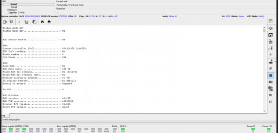

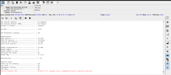

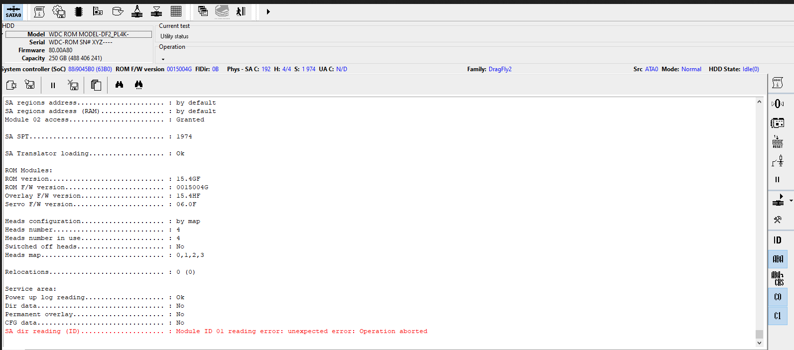

Hello community
With ref. to my earlier post in hddoracle , I am seeking help from hddguru community
WD Green 5000AVVS AV-GP (WD5000AVVS- 63M8B0) S/N WCAVXXX hard disk is I am working with. Its motor controller ic is burnt.
This model (DragnFly1) is having embedded rom .
I was not having exact pcb (2060-701640-001 Rev. A) so I tried 2060-771640-003 Rev A from WD 10EARS 1TB hard disk.

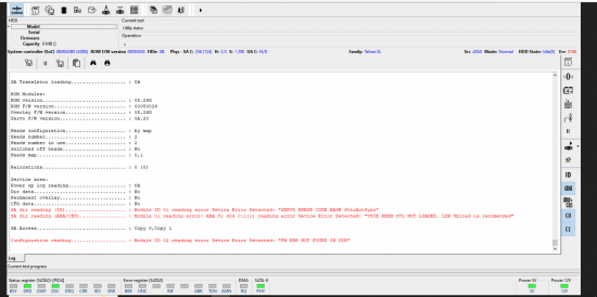

At that time disk got detected as 250GB (from rom). I tried to apply few loaders (DragnFly2 & others) but couldn't succeed due to lack of knowledge.
I have outsourced this case to another company. They are working & have updated that case is complex and might take time.
I would like to know what could be the solution for this case. Desoldering & reading patient mcu will need lots of skill and again is not easy.
Any hint or suggestion might lead to success. Pls. help.

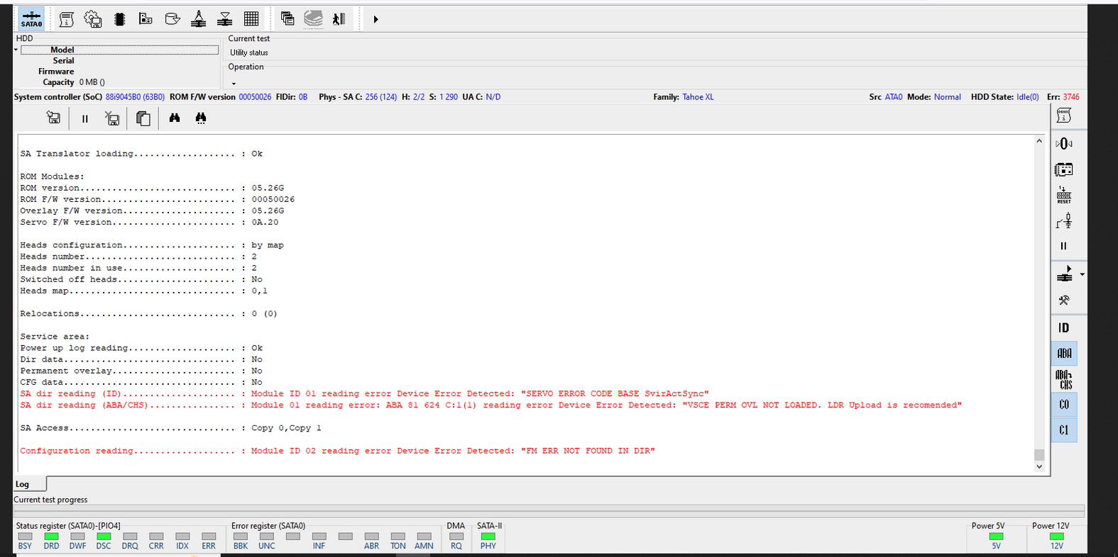

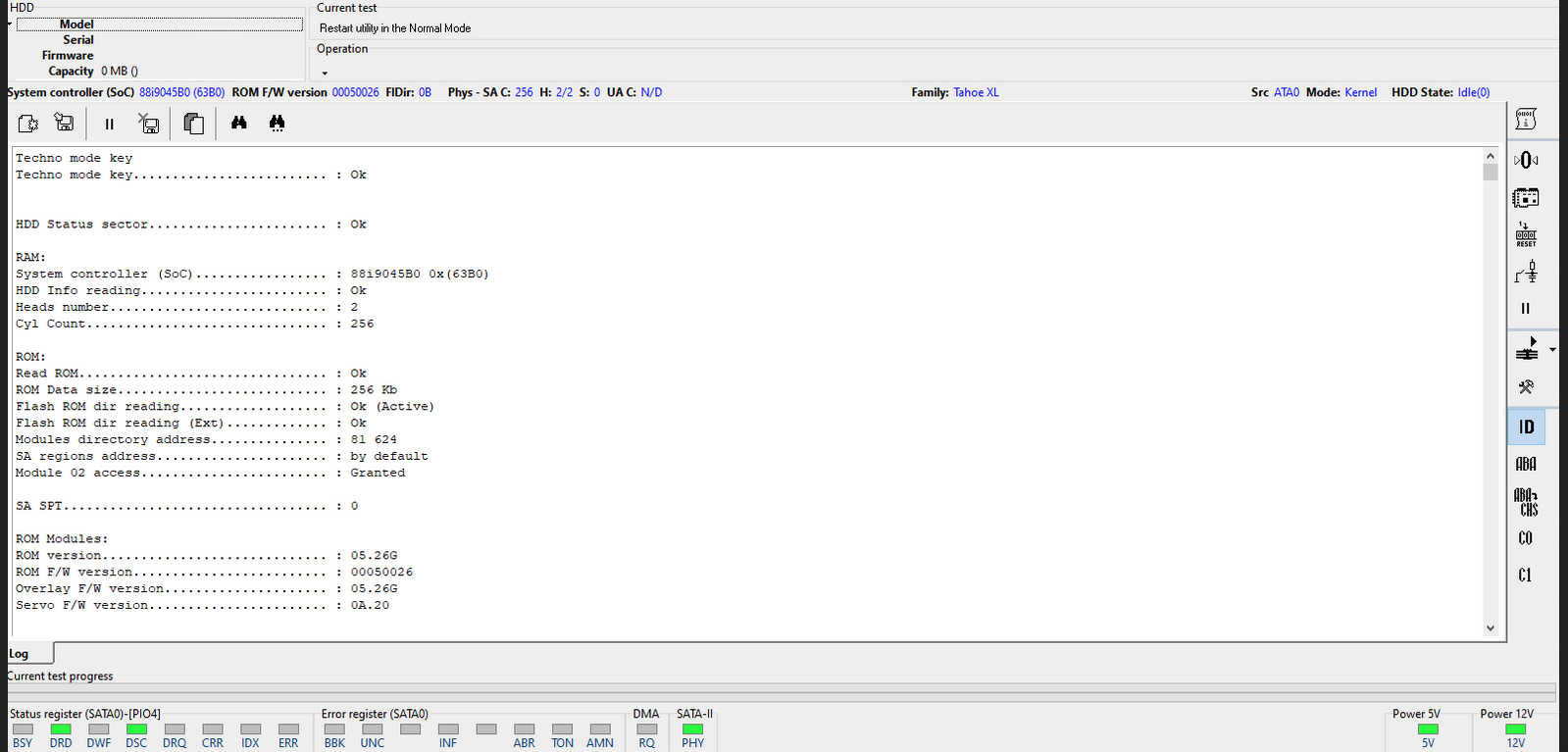

This case is unsolved yet as many DR companies have failed , ACE is also not able to solve .Anyone wants to give it a try before I return disk
Anyway customer is also not keen on data so I will not get any money & in turn will be able to give.
Its only a technical challenge who want to take there skills

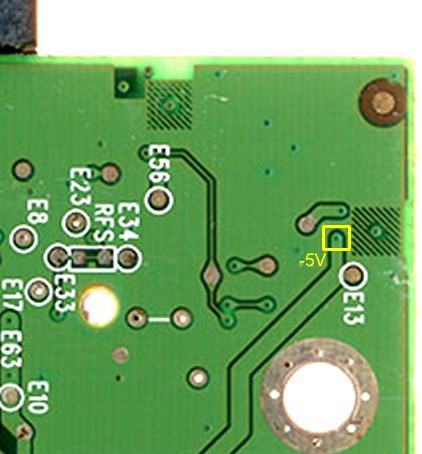

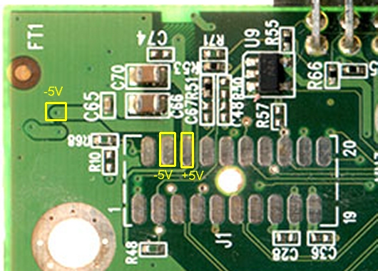

You can measure the resistance between ground and each of the preamp supply pins. Do this with the PCB on and off the drive. This will tell you if the preamp is damaged.
