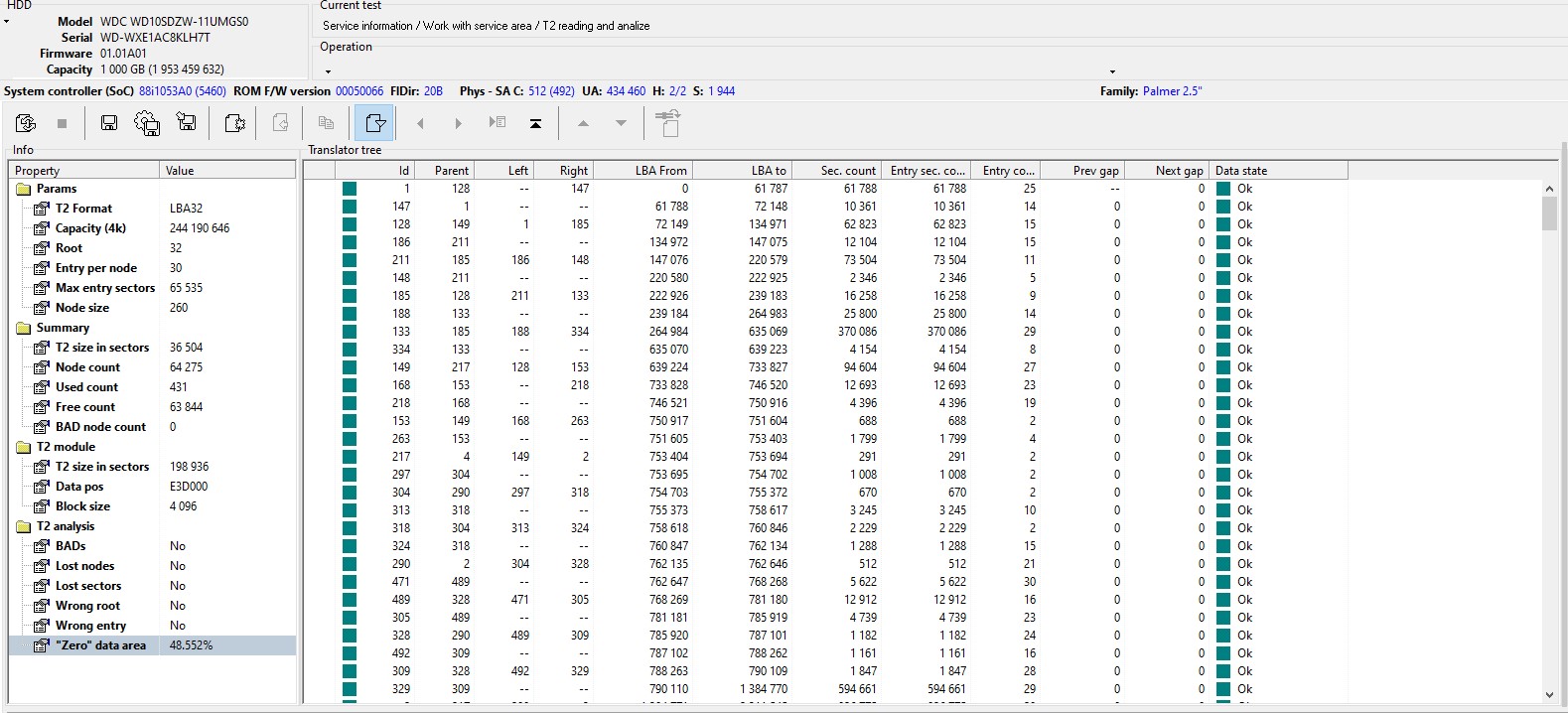

 Post subject: Re: Is it safe to generate the translator for this Palmer dr
PostPosted: December 29th, 2023, 12:31
Joined: February 15th, 2010, 23:14
Posts: 118
yes I analyze it and it seems in good condion as can be seen in the picture here
PostPosted: December 29th, 2023, 16:09
Posts: 357
If it's original T2 you can compare it with rebuilded one. SMR are strange. I've seen a case where rebuilded T2 didn't read sector 0 and some other too. When rebuilded again, everything was fine. Data was ok too. I even showed it to ACE. But i doubt that this is your case. If it's original T2, i would say bad sectors, or as Pepe wrote, maybe weak head.
