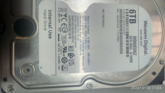

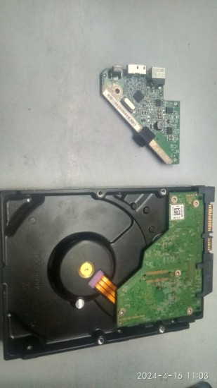

Hello Experts,
* I have a WD Elements 6TB External Hdd. 3.5" Hdd
* WDC WD60EDAZ-11U78B0-04-A8H-2-WD-WX12DA1PZZZP
* Family Venicer
* Sata Pcb 2060-810011-001 Rev P1 & Usb 3.0 PCB 4061-705094-004
* It Not Detect Status.
* Rom SED Lock Unlocked & It Has Some Firmware Issue. Firmware Corrected & Hdd Detect ok.
* But Now All Sectors Are Encrypted, I Have Set Decrypt option DE,Then Still Sectors are Encrypted.
* I Tried with Original Sata Pcb & Unlock Pcb Also. Both are Same All sectors are Encrypted.
Here any Experts face this issue Earlier pls Guide Me.
Thanks In Advance.

File comment: Its Usb Drive

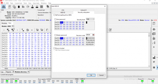

 Post subject: Re: WD Elements Encryption
PostPosted: April 16th, 2024, 4:58
Posts: 4808
is SED turned on in 02?

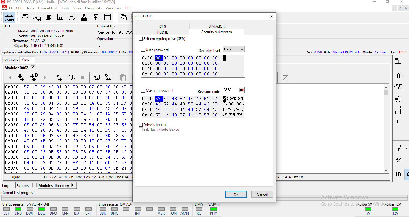

PostPosted: April 16th, 2024, 8:11
Joined: August 4th, 2018, 0:29
Location: tamilnadu
No Sir , No SED is on.
PostPosted: April 16th, 2024, 8:34
Posts: 4808
SED is off in 02, as per your screenshot, that's why you get the same data with native and donor pcb.
as per my records, this mdl should have SED turned ON.
