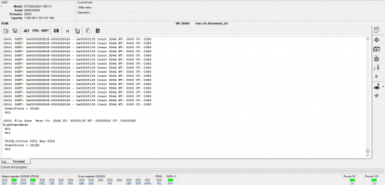

I am trying to unlock rosewood A5 , I could read rom but its name is changes to " ROM_WDEASNQH_0F390397.bin " instead of normal ROM.bin
Is this normal or something is wrong ?
Here is rom copy
https://drive.google.com/file/d/19Xh6ZW ... sp=sharing
terminal log
Switching HDD power supply OFF
Switching HDD power supply ON
Flash type inx... 0x00000002
Flash size....... 0x00100000
Flash prm dmp.... 0xEF 0x14 0x08 0x0B 0x05 0x9F 0x01 0x03 0x3C 0x20 0x40 0x04 0x00 0x01 0x00 0x00
Receiving file flash.bin, length = 1048576
Saving ROM to profile folder
File : C:\Program Files\ACE Lab\PC-3000\Bin\!Profiles\SgF3\Rosewood_A5\ST1000LM035-1RK172-SDM3-WDEASNQH pathing\Data\ROM\ROM_WDEASNQH_0F390397.bin

Guys something is definately wrong here ,when I patched this rom and written back to hdd , it loses id and goes to busy state.
How can I correct this ? Pls.help

I think system files are corrupted
