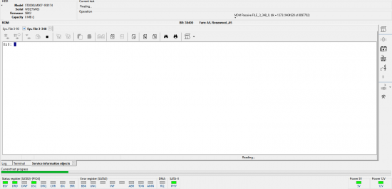

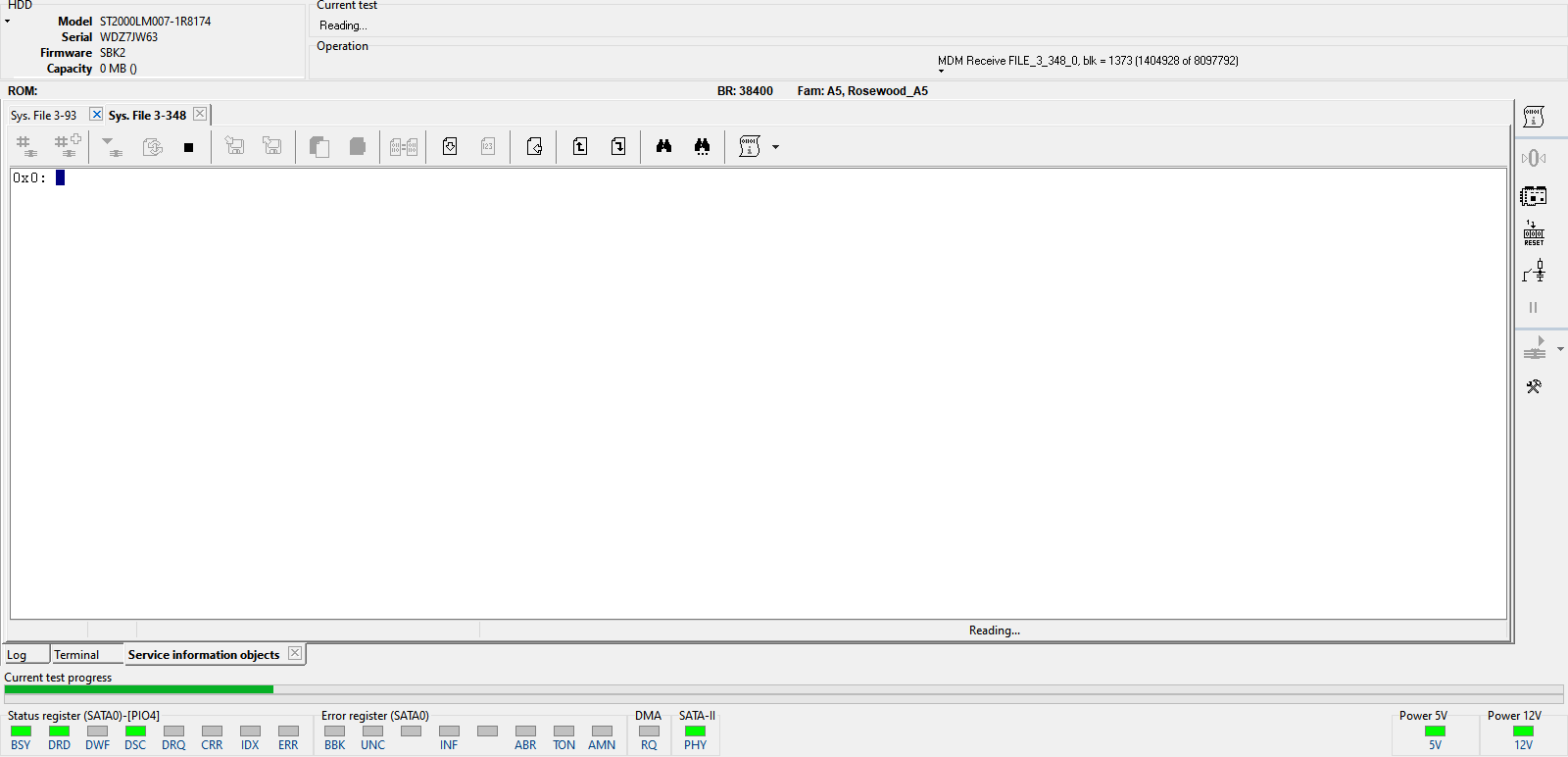

Guys what could be the reason for this drive to show 0 mb.
Its spinning normally without clocking.Is there any known FW issue with this family

At least need to see terminal output!

+1 terminal and history of steps taken will hint whats going on.

Thanks , I was waiting for some suggestions as I want to go ahead with caution .I will unlock rom and update soon.

Thanks Dear , I haven't done anything so far as I don't want top take chances with crucial client data.
Will update terminal output.

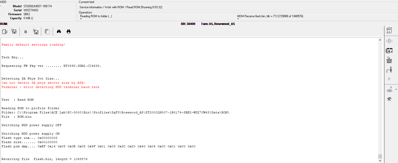

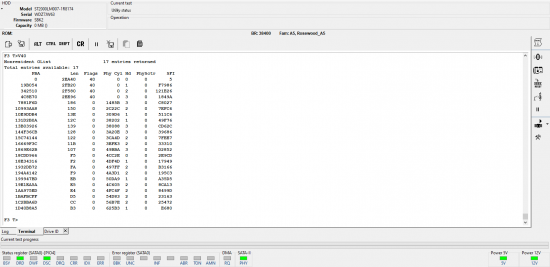

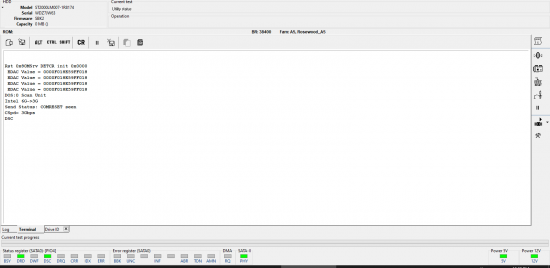

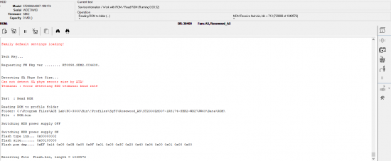

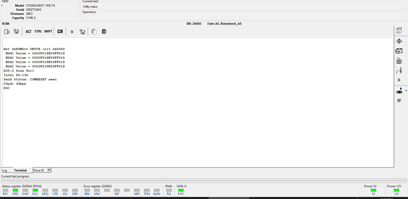

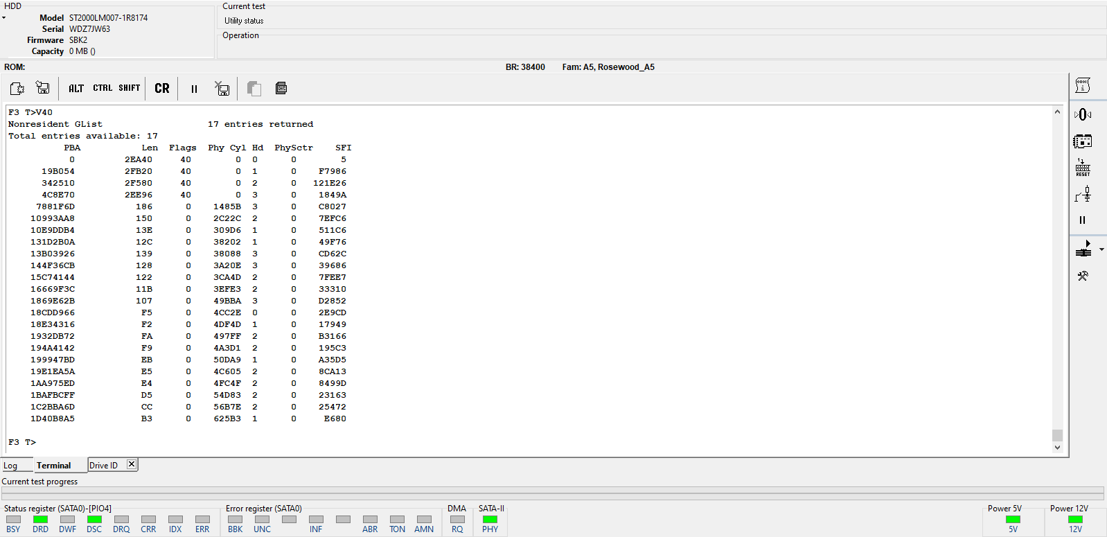

While disk stays busy and when I re read ID it gets initialized , I could read system files.
Here is terminal
