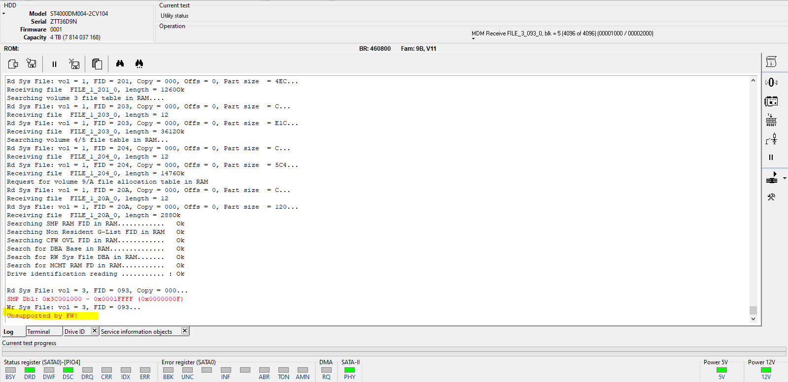

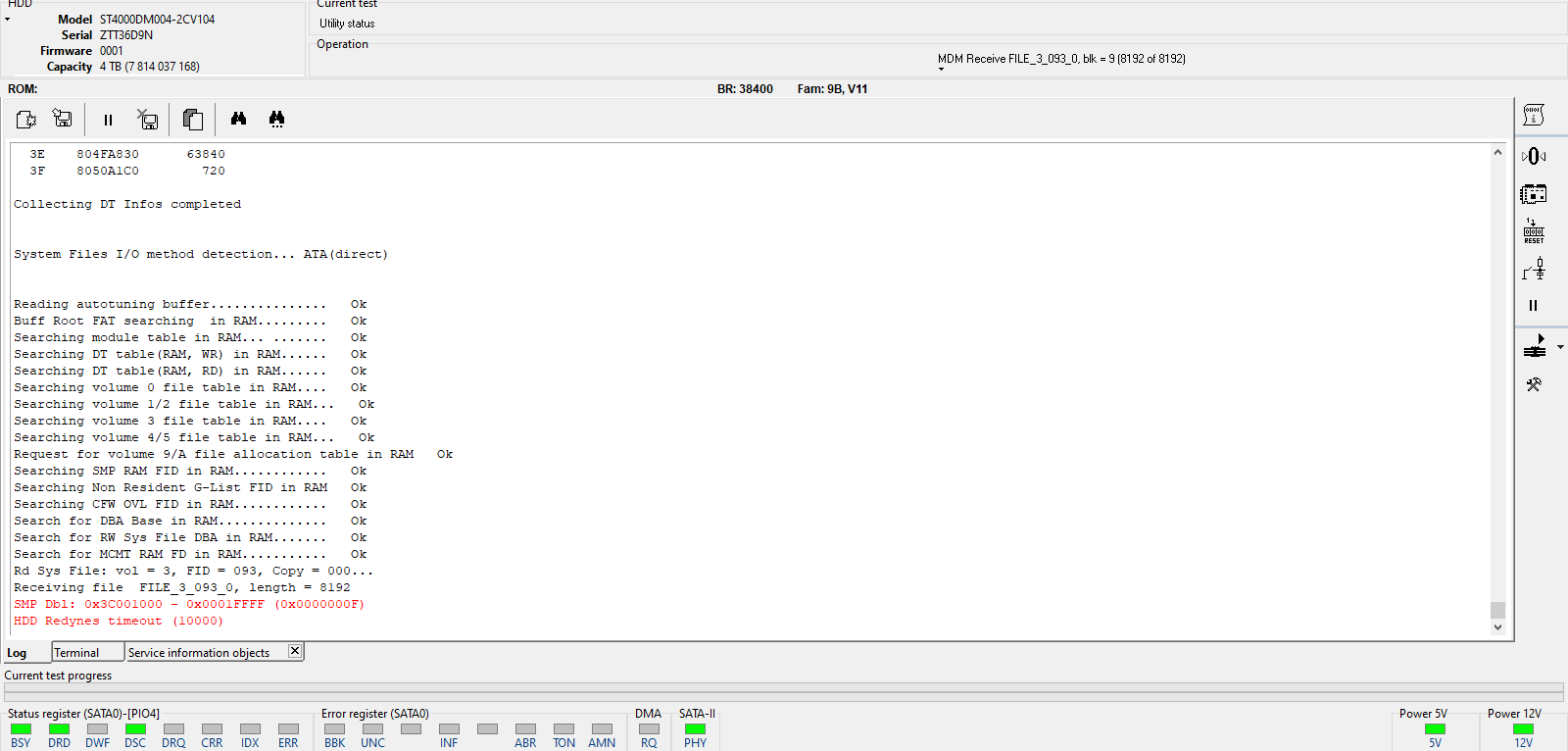

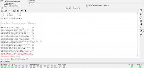

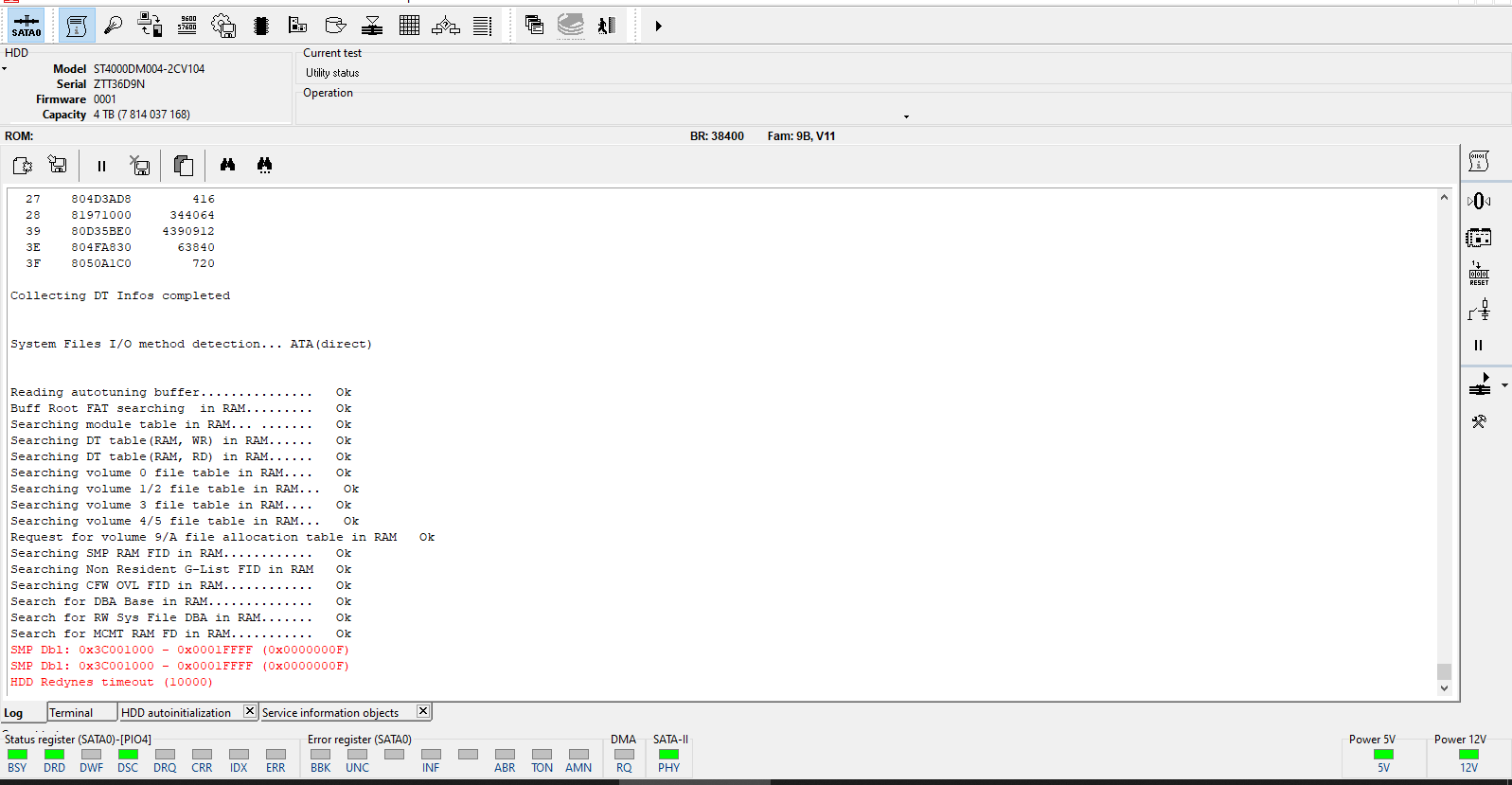

Hi friends
I have got this 4 TB disk , it is giving sector access errors .I have taken resources backup and backed up system files (sysfile 28 can't get copied from terminal)
I am getting errors while disabling background process.
What will be safest steps to follow.

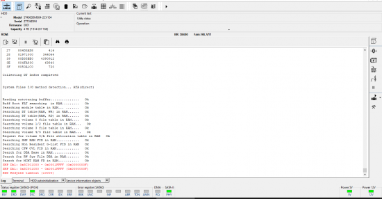

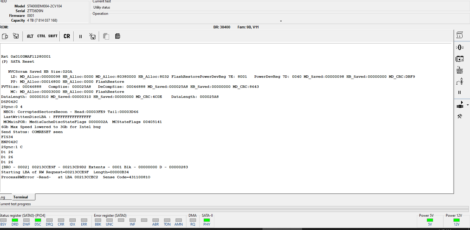

Hi
I am getting fw not supported error what it means & how can I correct it.
Anyone pls. help. Thanks
 Post subject: Re: Seagate 9B V11 family firmware diagnostics
PostPosted: May 22nd, 2024, 7:24
Posts: 4809
fw does not support writing sysfile thru terminal.
you need to write over ata.

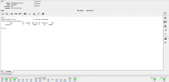

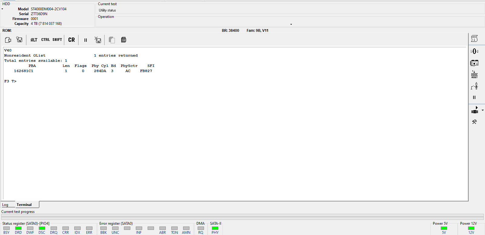

I am unable to write sys file 93 by both ATA methods as disk loses readyness , is there anything I am still missing.
PostPosted: May 23rd, 2024, 4:19
Posts: 4809
what's goning on on the terminal?

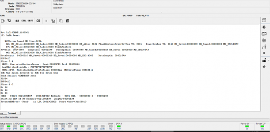

Hi Thanks
Here is terminal output
Skip Error Type Decision due to Small Sector count 0x0001
Out: [PRA]!
Starting LBA of RW Request=00213CCE9F Length=00000B34
ProcessRWError -Read- at LBA 00213CD6A4 Sense Code=43110081
Out: [PRA]!
ProcessRWError -Read- at LBA 00213CD6A8 Sense Code=43110081
Out: [PRA]!
ProcessRWError -Read- at LBA 00213CD6AE Sense Code=43110081
Out: [PRA]!
RAW ON After Spinup for counter=0x00000020, BlkAddr=0x003A6A960A
LBA = 00000000213CD2D7[ScrubRemove]!
LBA = 00000000213CD617[ScrubRemove]!
LBA = 00000000213CD619[ScrubRemove]!
CNcp
AStDisc
ProcessRWError -Read- at LBA 00213CD6C3 Sense Code=43110081
Out:
CNcp
AStDisc
CNcp
AStDisc
RAW Reallocate [RA]!
Common path start quit now
ProcessRC: 00000001,00000000
SkipLen: 00000000
ReadContinuous: 213CD617,000003BC
UnrecovSectorCount:0306,03B0
NumUDEs: 00000306,00000000,000003B0
Passed: 00000080,0000017E,0000035C
Out:
[SpawnDiscNodes: 213CD61E,000003AA-09E674F8,000059A0] ==> BRO is in progress
SkipLBA: 213CD61E,213CD9C7
Starting LBA of RW Request=000346FC42 Length=00001B60
ProcessRWError -Read- at LBA 000347027E Sense Code=43110081
Out:
ReallocateLBA1: 0347027E Length: 00000001
RST Status
NumMediaCacheEntries: 00000400
NumTotalEntries: 000005CA
SCT Status
MC1stSparePBA: 3BD5CAA0 MCLastSparePBA: 3BD7455F
User1stSparePBA: 3B242A41 UserLastSparePBA: 3B312B4D
FAILED to spare00000101!
CNcp
CNcp
CNcp
CNcp
CNcp
CNcp
NVCScram Saved HB Size:020A
LD: MD_Alloc:00000098 HB_Alloc:0000 MD_Alloc:80380000 HB_Alloc:8032 FlashRestore
PowerDevReg 7E: 7001 PowerDevReg 7D: 0044 MD_Saved:00000098 HB_Saved:00000000 MD_CRC:DBF9
PP: MD_Alloc:00016800 HB_Alloc:0000 FlashRestore
PVTSize: 00046888 CompSize: 000025AA DeCompSize: 00046888 MD_Saved:000025AA HB_Saved:00000000 MD_CRC:D057
MC: MD_Alloc:00003000 HB_Alloc:0000 FlashRestore
DataLength: 00000310 MD_Saved:00000310 HB_Saved:00000000 MD_CRC:4C0E DataLength: 000025AA
DSP0436
2Sync:0 4
NECS: CorruptedSectorsRecon - Head:00003FE9 Tail:00003D66
LastWrittenDiscLBA : FFFFFFFFFFFFFFFF
MCMainPOR: MediaCacheDiscStateFlags 0000002A MCStateFlags 00405141
6Gb Max Speed lowered to 3Gb for Intel bug
Send Status: COMRESET seen
FIS34
ENP0436
2Sync:1 C
Di 27
F3 T>

Location: World
Show NGList.
Data Recovery, Remote support & Training https://disksolution.com.pk/
PostPosted: May 24th, 2024, 9:57
Posts: 196
Disk Solution wrote:
Show NGList.
Hi Disk Solution here is NRG list

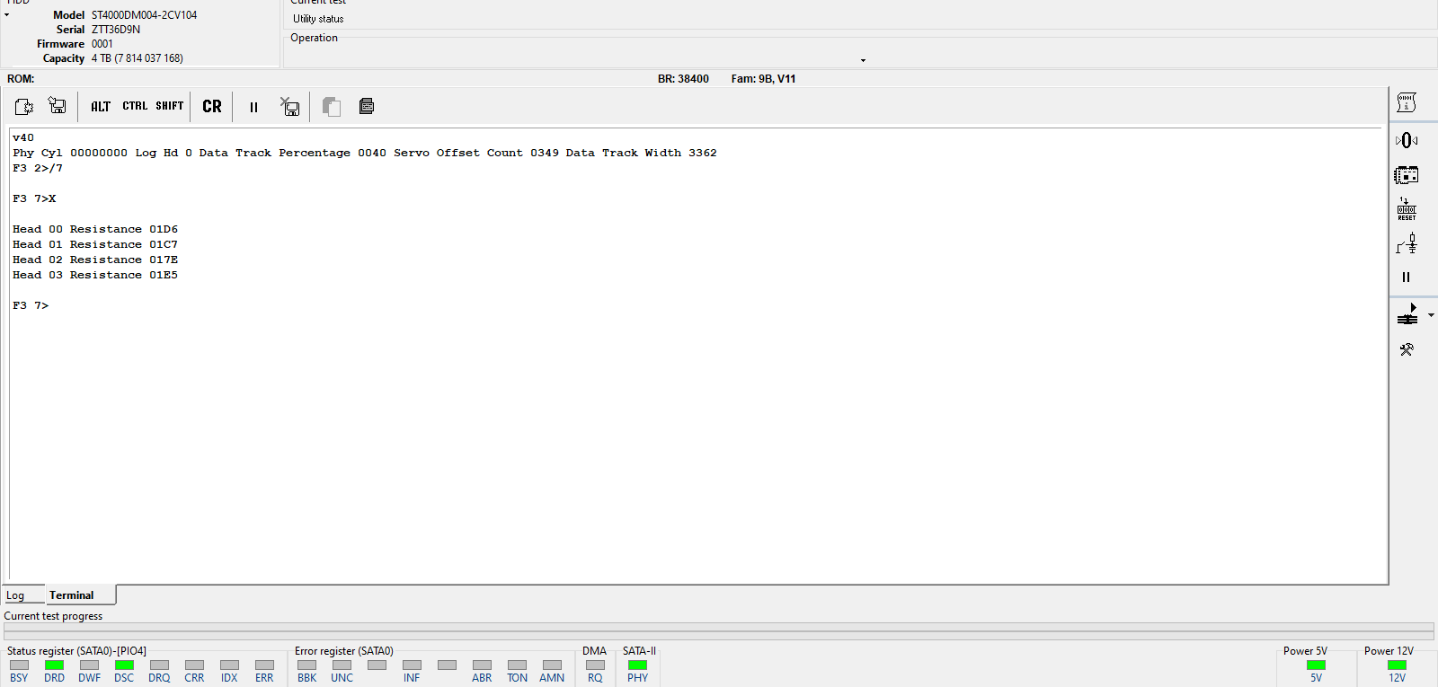

Thanks . I am unable to write sysfile 93 bt ATA indirect so background scanning is not disabled. I think issue could in in SA or weak head 0.
While writing terminal gives LED error
LED:0x000000BD FAddr:0x00009039
Disks health is 9% it has lots of smart errors , should I clear smart
