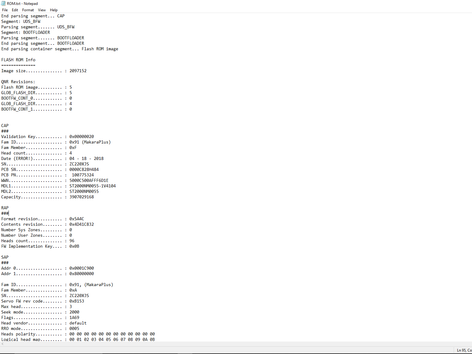

I am hunting donor for ST2000NM0055-1V4104 MakaraPlus Drive.
How to identify preamp & headmap from rom .
Here is rom
https://drive.google.com/file/d/1U2yLcN ... sp=sharing

 Post subject: Re: Finding Donor for MakaraPlus
PostPosted: July 28th, 2024, 23:38
Posts: 198
Location: Universe
Zero Alpha wrote:
Thanks .
Before posting I have checked your website & this post as well.
In both methods preamp description is missing . I have finally chosen first 3 letters of SN for preamp & 4 head model (for head map) as only criteria.
