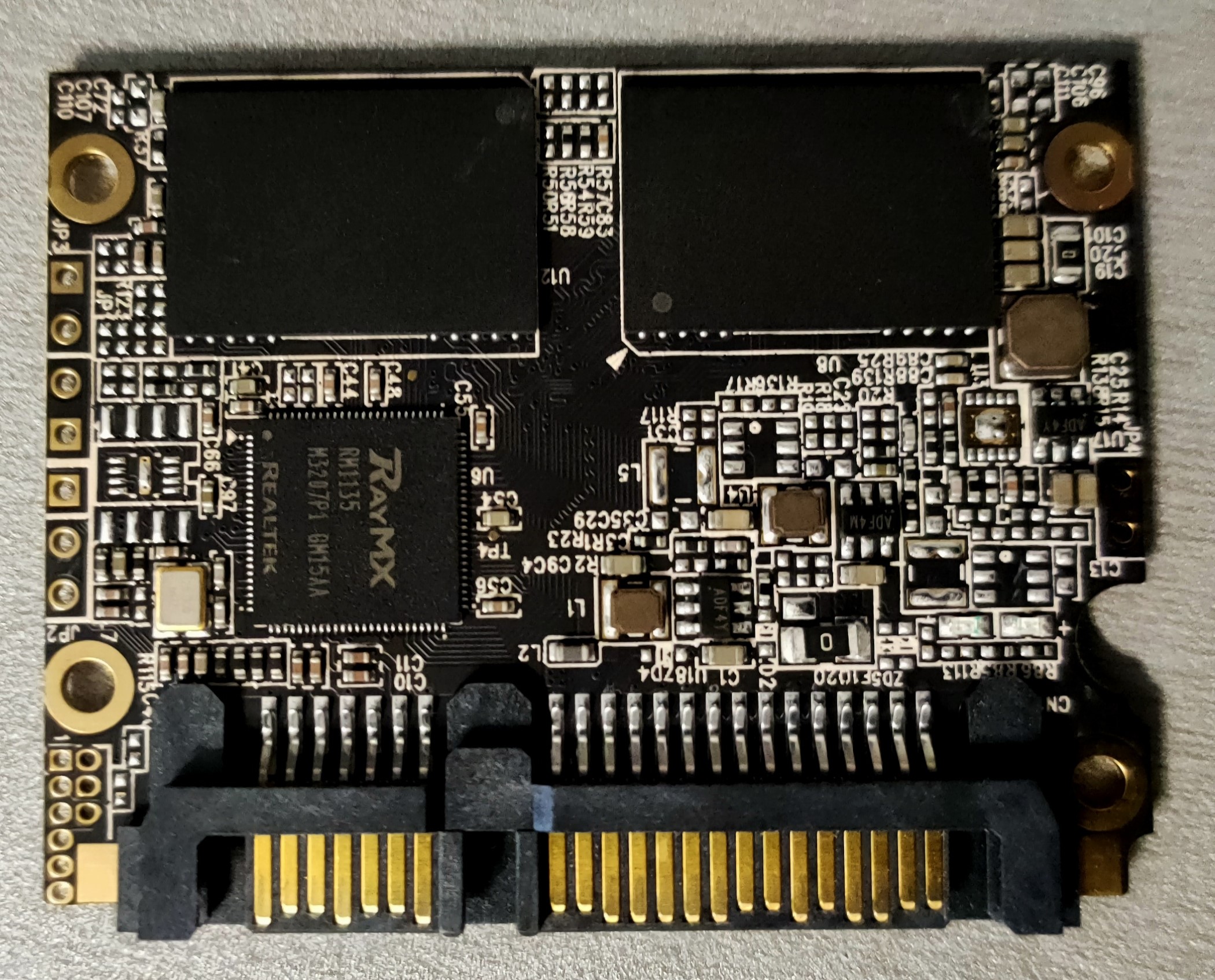

i have a chinese SSD Sata and it has RayMX RM1135 when i connect it to the PC3K it reads it normally with all info but with reading is very very slow and when i repower the SSD manually it can read the unreadable sectors but very slow is there and suggestions to solve that ?

No solutions for Realtek to work in techno mode. Copy important data as fast as possible. Set proper timing, resets, repowers etc. Try with a little heat or freezing spray on nands.
Cover the entire ssd leaving the nand chips ,Then use hot air or freeze whatever works .if reading is slow nand is degrading

but i tried those suggestions it gives same results, it reads about 0.5 mb in 30 min
