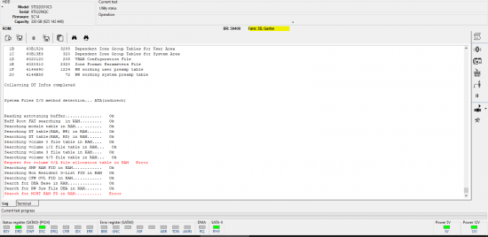

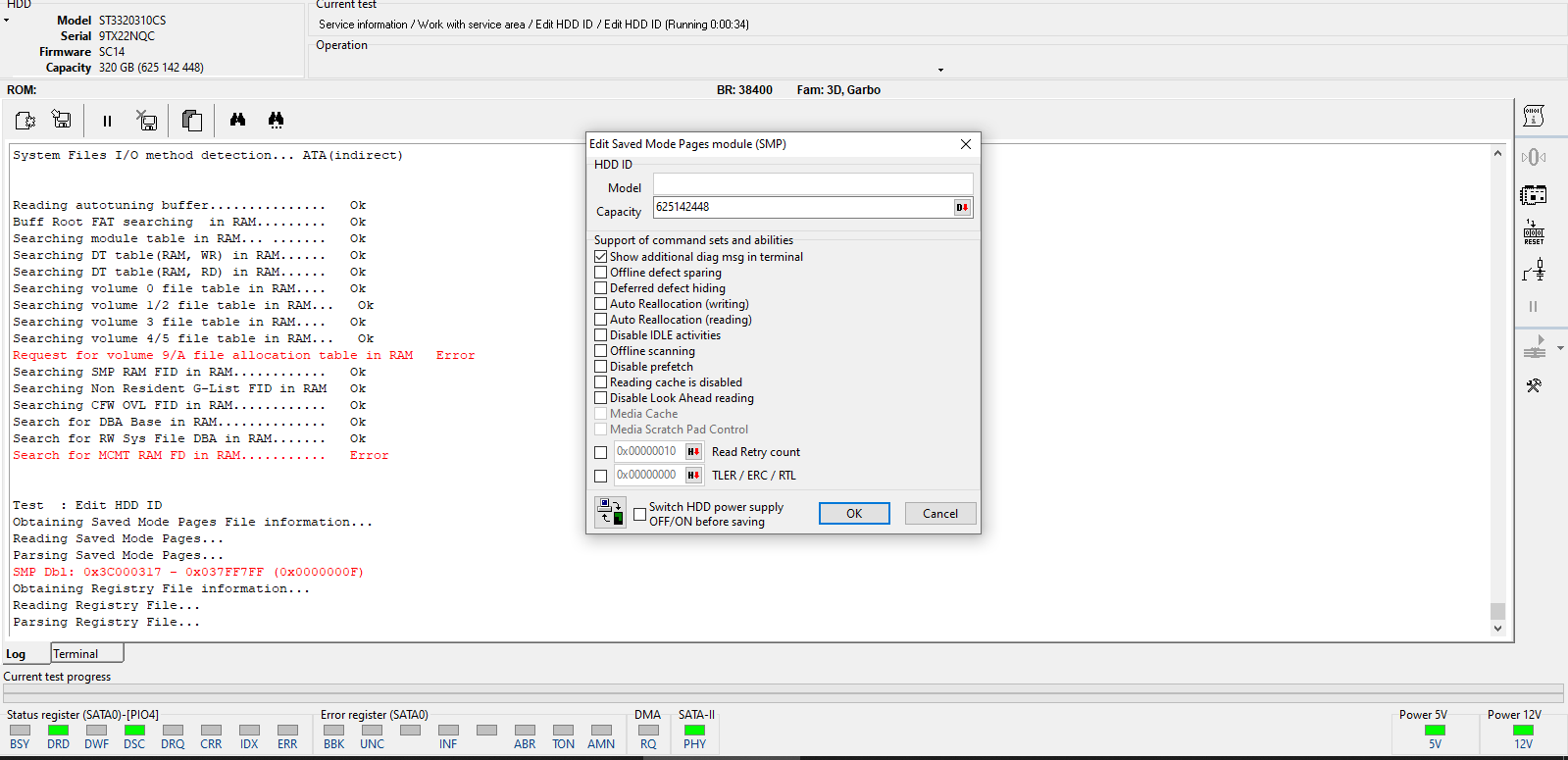

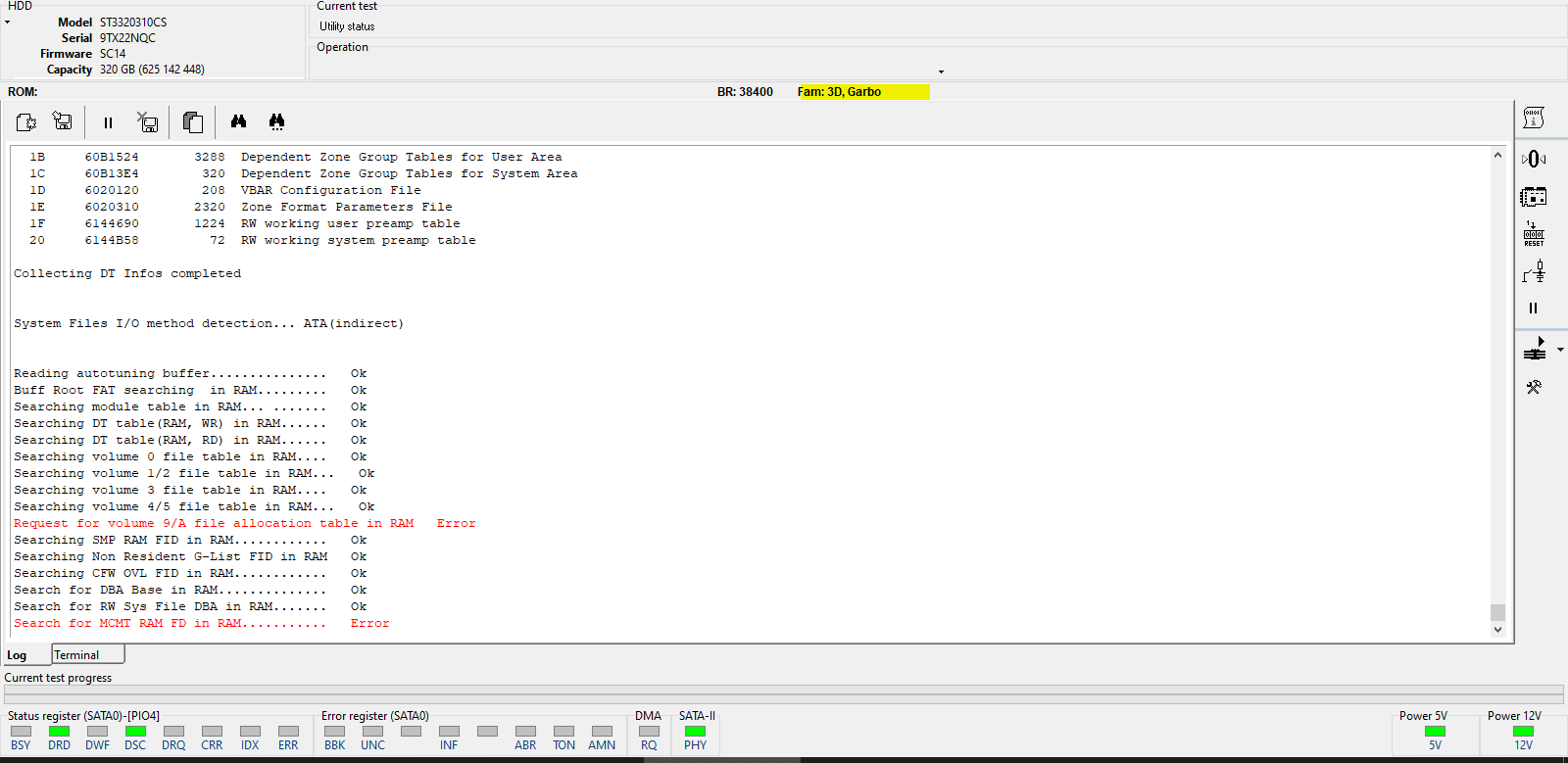

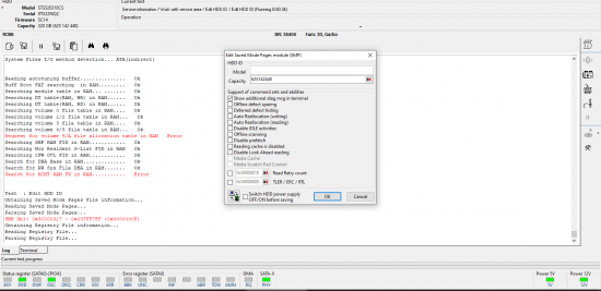

I want to refine sysfiles of this disk in order to make data extraction smooth.
I am unable to access sys file 93 (disk loses readyness) How can I manually read this file. Is disabling reallocation (edit hdd id ) is same as SMP sys 93 correction.
Is there any other sys file I must work on or anything else I can do further.

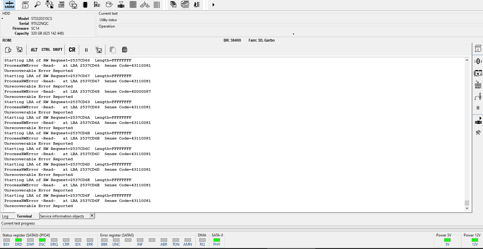

Its sys_0_8F for this family and not 93 , I have done that anything I can do. Terminal is showing processwork error

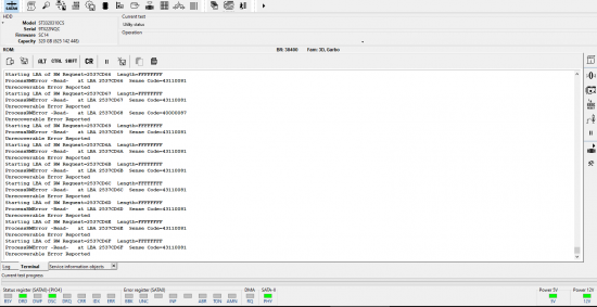

Nearly 99% Data recovered except one PST , Head 1 imaged 100% head 0 is giving read errors. Is there anything can be done except treating bad sectors which no one can do anything.

You can send "F" commands to disable reallocation, etc. I have written a ZOC script (at HDD Oracle) to automate this for you.
F"READ_SPARING_ENABLED",0,22
F"WRITE_SPARING_ENABLED",0,22
F"OFFLINE_SPARING_ENABLED",0,22
F"DAR_ENABLED",0,22
F"DISABLE_IDLE_ACTIVITY",1,22
F"BGMS_DISABLE_DATA_REFRESH",1,22
F"ABORT_PREFETCH",1,22
F"READ_LOOKAHEAD_DISABLED_ON_POWER_UP",1,22
F"READ_CACHING_DISABLED_ON_POWER_UP",1,22
https://www.hddoracle.com/download/file.php?id=3883
