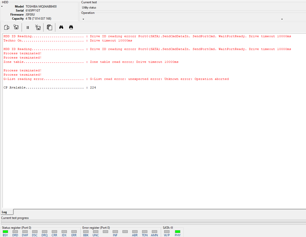

AND IDEA OR SUGGESTIONS FOR THE ATTACHED ERROR

Damaged G-list
you can still clone it in DE
 Post subject: Re: TOSHIBA MQ04ABB400
PostPosted: October 7th, 2024, 3:26
Posts: 3551
I kindly disagree.
The above drive does not read Zone, does not read ID (the displayed ID is taken from the PCB), does not know Techno and generally it doesn't read anything from the SA.
MQ04 has most of SA on the platters, so this drive doesn't read anything, most probably heads are gone. But it still needs to be diagnosed.

northwind wrote:
I kindly disagree.
I AGREE CAUSE WHEN I OPENED THE HDD I SAW SCRATCH ON THE PLATTERS
