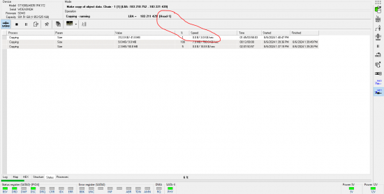

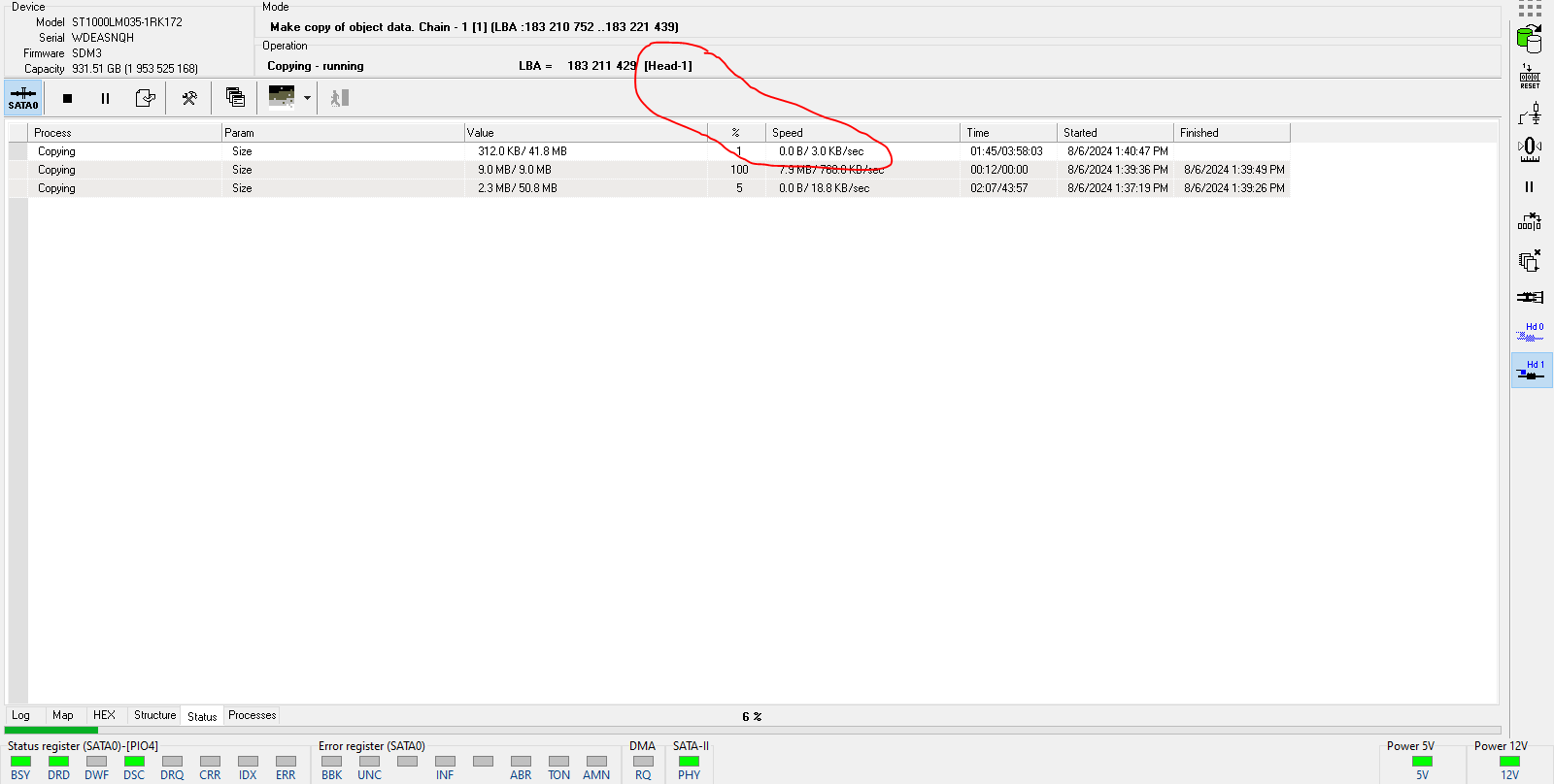

This ST1000LM035-1RK172 Rosewood A5 reading speed for Head 1 is very low (1~2 kb/s)
How can I identify whether this is due to weak head itself or any other reason.
Is there anyway to change head parameters using pc3K to improve read speed
Terminal shows following -
 Post subject: Re: Rosewood A5 Head slow rdiagnostics and possible adjustm
PostPosted: August 6th, 2024, 8:28
Posts: 1748
Head 1 damaged and most likely reading wrong pattern.
PostPosted: August 8th, 2024, 2:36
Posts: 196
yes head 1 crashed. Thanks
