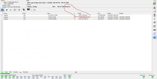

This ST1000LM035-1RK172 Rosewood A5 reading speed for Head 1 is very low (1~2 kb/s)
How can I identify whether this is due to weak head itself or any other reason.
Is there anyway to change head parameters using pc3K to improve read speed
Author:  unknown [ August 6th, 2024, 8:28 ]
Post subject:  Re: Rosewood A5 Head slow rdiagnostics and possible adjustm
Head 1 damaged and most likely reading wrong pattern.
Author:  posidon [ August 8th, 2024, 2:36 ]
yes head 1 crashed. Thanks
