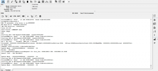

Guys I have backed up sys files 28 /93 & 346 , I am unable to disable reallocation as disk becomes busy & give time out.
Terminal shows -- Update Mask - 0000000000588DDBB0000008-00
I have tried everything but no way. Besides SMP flags is there any other file I can update for further refinement ?
I will be thankful for any suggestion.

I tried fzabkar's script but it doesn't work.Then I tried to initilize hard disk by entering in utility by powered on /off state etc.
While entering utility disk stays busy while unlocking it shows id.
I am not much confident about commands but will give it a try , is there any single command for all rosewood variants ? Besides SMP is there anything I can do

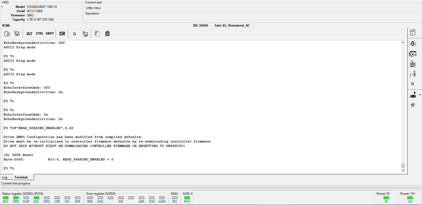

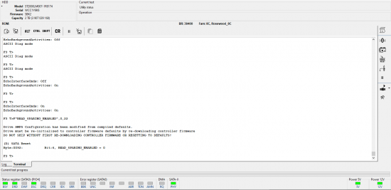

I have been following your advice from your previous posts :-
You can try to stabilize the drive and turn on further diag msg.
When you launch F3 util:
1. :At utility start section : Select correct HDD ID in RAM + Install Write Protection
2. : In Actions: select "Unlock Tech Mode, drive prepared by utility" (drive will send handshake to unlock and read ID and select family)
3. : Do a backup of important fw. Indirect or Terminal.
Edit ID via terminal, turn on additional diag msg.

Come on , hurry up guys pls. give me some hint before posting this request to another forum & saying good bye to hddguru :(

Rosewood drives can be very complex even for the experienced.
Do you have a backup of all the firmware or can you only access it via terminal?

yes I agreed each case is unique. I know this drive can be fixed by simple fw trick who has enough experience.
Its all about timings & how we enter in utility like -
1) Powering first & auto detect enter unlock before utility start
2) enter utility without powering (common f3) then power on & unlock
3) enter without unlocking power on & unlock.
for each of this drive behave differently
In this case drive does not respond to sys file 93 (hdd editor in ram or SMP flag updating etc)
I think by modifying file in terminal may work but I am not confident and don't want to do experimentation with client disk.

This is the most common hard drive I get in and yes there are some simple tricks for common problems but there is also some very difficult problems.
Can you turn the drive off and on and enter the Rosewood_8C utility and post everything from the 'Log' tab. Also post a clean terminal log so I can see how it behaves from power on.

Thank you so much Zero Alpha
Here are both logs-

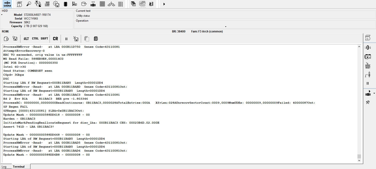

Terminal :-
Boot 0x80M
QB
Rst 0x80MSrvDETCR init 0x0000
(P) SATA Reset
RAW OFF
PASS
Drive AMPS Configuration has been modified from compiled defaults.
Drive must be re-initialized to controller firmware defaults by re-downloading controller firmware
DO NOT SHIP WITHOUT FIRST RE-DOWNLOADING CONTROLLER FIRMWARE OR RESETTING TO DEFAULTS!
(DOS Table) Worst Count: 00000C08 At SU: 00005130 NT: 00000000 OT: 00000001
(POR) Recover Secondary MCMT Opened Recovered
DSC PASS
Starting LBA of RW Request=000B11D73D Length=00000298
ProcessRWError -Read- at LBA 000B11D7AD Sense Code=43110081
ProcessRecoveryComp-2
ERC TO exceeded, orig value in us:FFFFFFFF
MS Read Fails: 588EB9E8,000014C0
(MC POR Duration): 00000004B0
Intel 6G->3G
Send Status: COMRESET seen
CSpd= 3Gbps
DSC
Update Mask -Out:
Update Mask - 00000000588DD660 - 00000008 - 00
Update Mask - 00000000588DD668 - 00000008 - 00
Starting LBA of RW Request=000B11BAB5 Length=00001DD4
ProcessRWError -Read- at LBA 000B11BAD3 Sense Code=43110081Out:
ProcessRWError -Read- at LBA 000B11BAD5 Sense Code=43110081Out:
ProcessRWError -Read- at LBA 000B11BAD6 Sense Code=43110081Out:
Update Mask - 00000000588DD6B8 - 00000008 - 00
ProcessRWError -Read- at LBA 000B11BADA Sense Code=43110081Out:
ProcessRWError -Read- at LBA 000B11BADB Sense Code=43110081Out:
ProcessRWError -Read- at LBA 000B11BADF Sense Code=43110081Out:
ProcessRWError -Read- at LBA 000B11BAE0 Sense Code=43110081Out:
Update Mask - 00000000588DD708 - 00000008 - 00
Update Mask - 00000000588DD710 - 00000008 - 00
Update Mask - 00000000588DD718 - 00000008 - 00
ProcessRWError -Read- at LBA 000B11BAE4 Sense Code=43110081Out:
Update Mask - 00000000588DD728 - 00000008 - 00
ProcessRWError -Read- at LBA 000B11BAE6 Sense Code=43110081Out:
Update Mask - 00000000588DD748 - 00000008 - 00
Update Mask - 00000000588DD750 - 00000008 - 00
Update Mask - 00000000588DD758 - 00000008 - 00
ProcessRWError -Read- at LBA 000B11BAEC Sense Code=43110081
Hd 2 Err Blk B11BAEC BER pre -1.792827
ProcessRC: 00000000,00000000ReadContinuous: 0B11BAEC,00000261TotalEntries:0004 XfrLen:0261UnrecovSectorCount:0004,0003NumUDEs: 00000004,00000003Failed: 40000087Out:
SP Regen FAIL
SPRegen [0000|43110081] @LBA=0x0B11BAECOut:
Update Mask - 00000000588DD760 - 00000008 - 00
Harden - 0B11BAEC
InitiateMarkPendingReallocateRequest for disc_lba: 000B11BAEC CHS: 00023B6D.02.0037
Assert 741D - LBA 0B11BAEC!
Update Mask - 00000000588DD780 - 00000008 - 00
Update Mask - 00000000588DD788 - 00000008 - 00
Update Mask - 00000000588DD790 - 00000008 - 00
ProcessRWError -Read- at LBA 000B11BAF4 Sense Code=43110081Out:
Update Mask - 00000000588DD7A8 - 00000008 - 00
Update Mask - 00000000588DD7B0 - 00000008 - 00
ProcessRWError -Read- at LBA 000B11BAF7 Sense Code=43110081Out:
ProcessRWError -Read- at LBA 000B11BAF8 Sense Code=43110081Out:
Update Mask - 00000000588DD7C8 - 00000008 - 00
ProcessRWError -Read- at LBA 000B11BAFA Sense Code=43110081Out:
Update Mask - 00000000588DD7D8 - 00000008 - 00
Update Mask - 00000000588DD7E0 - 00000008 - 00
ProcessRWError -Read- at LBA 000B11BAFE Sense Code=43110081Out:
Update Mask - 00000000588DD7F8 - 00000008 - 00
Update Mask - 00000000588DD800 - 00000008 - 00
ProcessRWError -Read- at LBA 000B11BB01 Sense Code=43110081Out:
Update Mask - 00000000588DD810 - 00000008 - 00
Update Mask - 00000000588DD818 - 00000008 - 00
Update Mask - 00000000588DD820 - 00000008 - 00
Update Mask - 00000000588DD828 - 00000008 - 00
Update Mask - 00000000588DD830 - 00000008 - 00
Update Mask - 00000000588DD838 - 00000008 - 00
Update Mask - 00000000588DD840 - 00000008 - 00
Update Mask - 00000000588DD848 - 00000008 - 00
Update Mask - 00000000588DD850 - 00000008 - 00
Update Mask - 00000000588DD858 - 00000008 - 00
Update Mask - 00000000588DD860 - 00000008 - 00
ProcessRWError -Read- at LBA 000B11BB0D Sense Code=43110081Out:
Update Mask - 00000000588DD870 - 00000008 - 00
Update Mask - 00000000588DD878 - 00000008 - 00
ProcessRWError -Read- at LBA 000B11BB10 Sense Code=43110081Out:
Update Mask - 00000000588DD8B0 - 00000008 - 00
Update Mask - 00000000588DD8B8 - 00000008 - 00
Update Mask - 00000000588DD8C0 - 00000008 - 00
ProcessRWError -Read- at LBA 000B11BB1A Sense Code=43110081Out:
Update Mask - 00000000588DD8D8 - 00000008 - 00
ProcessRWError -Read- at LBA 000B11BB1C Sense Code=43110081Out:
ProcessRWError -Read- at LBA 000B11BB1D Sense Code=43110081Out:
Update Mask - 00000000588DD908 - 00000008 - 00
ProcessRWError -Read- at LBA 000B11BB22 Sense Code=43110081Out:
ProcessRWError -Read- at LBA 000B11BB24 Sense Code=43110081Out:
Update Mask - 00000000588DD928 - 00000008 - 00
ProcessRWError -Read- at LBA 000B11BB26 Sense Code=43110081Out:
ProcessRWError -Read- at LBA 000B11BB27 Sense Code=43110081Out:
Update Mask - 00000000588DD940 - 00000008 - 00
Update Mask - 00000000588DD948 - 00000008 - 00
ProcessRWError -Read- at LBA 000B11BB2A Sense Code=43110081Out:
ProcessRWError -Read- at LBA 000B11BB2D Sense Code=43110081Out:
Update Mask - 00000000588DD970 - 00000008 - 00
ProcessRWError -Read- at LBA 000B11BB3E Sense Code=43110081Out:
ProcessRWError -Read- at LBA 000B11BB40 Sense Code=43110081Out:
Update Mask - 00000000588DDAB0 - 00000008 - 00
Update Mask - 00000000588DDAB8 - 00000008 - 00
ProcessRWError -Read- at LBA 000B11BB5A Sense Code=43110081Out:
Update Mask - 00000000588DDAD8 - 00000008 - 00
Update Mask - 00000000588DDAE0 - 00000008 - 00
Update Mask - 00000000588DDAE8 - 00000008 - 00
Update Mask - 00000000588DDB00 - 00000008 - 00
Update Mask - 00000000588DDB08 - 00000008 - 00
ProcessRWError -Read- at LBA 000B11BB62 Sense Code=43110081Out:
Update Mask - 00000000588DDB18 - 00000008 - 00
ProcessRWError -Read- at LBA 000B11BB64 Sense Code=43110081Out:
Update Mask - 00000000588DDB28 - 00000008 - 00
Update Mask - 00000000588DDB30 - 00000008 - 00
Update Mask - 00000000588DDB38 - 00000008 - 00
Update Mask - 00000000588DDB40 - 00000008 - 00
ProcessRWError -Read- at LBA 000B11BB69 Sense Code=43110081
Hd 2 Err Blk B11BB69 BER pre -1.803039
ProcessRC: 00000002,00000000ReadContinuous: 0B11BB69,000001E4TotalEntries:0004 XfrLen:01E4UnrecovSectorCount:0003,0003NumUDEs: 00000003,00000003Failed: 40000087Out:
SP Regen FAIL
SPRegen [0000|43110081] @LBA=0x0B11BB69Out:
Update Mask - 00000000588DDB48 - 00000008 - 00
Harden - 0B11BB69
InitiateMarkPendingReallocateRequest for disc_lba: 000B11BB69 CHS: 00023B6D.02.00B4
Assert 741D - LBA 0B11BB69!
Update Mask - 00000000588DDB68 - 00000008 - 00
ProcessRWError -Read- at LBA 000B11BB70 Sense Code=43110081Out:
Update Mask - 00000000588DDB88 - 00000008 - 00
Update Mask - 00000000588DDB90 - 00000008 - 00
ProcessRWError -Read- at LBA 000B11BB74 Sense Code=43110081Out:
ProcessRWError -Read- at LBA 000B11BB75 Sense Code=43110081Out:
Update Mask - 00000000588DDBB0 - 00000008 - 00
Update Mask - 00000000588DDBB8 - 00000008 - 00
Update Mask - 00000000588DDBC8 - 00000008 - 00
Update Mask - 00000000588DDC00 - 00000008 - 00
Update Mask - 00000000588DDC20 - 00000008 - 00
ProcessRWError -Read- at LBA 000B11BB8F Sense Code=43110081Out:
ProcessRWError -Read- at LBA 000B11BB92 Sense Code=43110081Out:
ProcessRWError -Read- at LBA 000B11BB93 Sense Code=43110081Out:
ProcessRWError -Read- at LBA 000B11BB96 Sense Code=43110081Out:
ProcessRWError -Read- at LBA 000B11BBA0 Sense Code=43110081Out:
ProcessRWError -Read- at LBA 000B11BBA3 Sense Code=43110081Out:
ProcessRWError -Read- at LBA 000B11BC00 Sense Code=43110081Out:
Update Mask - 00000000588DE068 - 00000008 - 00
Update Mask - 00000000588DE070 - 00000008 - 00
Update Mask - 00000000588DE078 - 00000008 - 00
Update Mask - 00000000588DE0C8 - 00000008 - 00
ProcessRWError -Read- at LBA 000B11BC1D Sense Code=43110081Out:
ProcessRWError -Read- at LBA 000B11BC1E Sense Code=43110081Out:
ProcessRWError -Read- at LBA 000B11BC22 Sense Code=43110081Out:
ProcessRWError -Read- at LBA 000B11BC26 Sense Code=43110081Out:
Update Mask - 00000000588DE260 - 00000008 - 00
ProcessRWError -Read- at LBA 000B11BC4D Sense Code=43110081Out:
ProcessRWError -Read- at LBA 000B11BC51 Sense Code=43110081Out:
ProcessRWError -Read- at LBA 000B11BC52 Sense Code=43110081Out:
ProcessRWError -Read- at LBA 000B11BC5A Sense Code=43110081
Hd 2 Err Blk B11BC5A BER pre -1.801642
ProcessRC: 00000002,00000000ReadContinuous: 0B11BC5A,0000023FTotalEntries:001B XfrLen:023FUnrecovSectorCount:0010,001ANumUDEs: 00000010,0000001AFailed: 40000087Out:
SP Regen FAIL
SPRegen [0000|43110081] @LBA=0x0B11BC5AOut:
Update Mask - 00000000588DE2D0 - 00000008 - 00
Harden - 0B11BC5A
InitiateMarkPendingReallocateRequest for disc_lba: 000B11BC5A CHS: 00023B6E.02.0059
Assert 741D - LBA 0B11BC5A!
ProcessRWError -Read- at LBA 000B11BC5B Sense Code=43110081Out:
ProcessRWError -Read- at LBA 000B11BC5C Sense Code=43110081Out:
ProcessRWError -Read- at LBA 000B11BC60 Sense Code=43110081Out:
ProcessRWError -Read- at LBA 000B11BC62 Sense Code=43110081Out:
ProcessRWError -Read- at LBA 000B11BC73 Sense Code=43110081Out:
Update Mask - 00000000588DE3A8 - 00000008 - 00
ProcessRWError -Read- at LBA 000B11BC76 Sense Code=43110081
Hd 2 Err Blk B11BC76 BER pre -1.805312
ProcessRC: 00000002,00000000ReadContinuous: 0B11BC76,00000223TotalEntries:000F XfrLen:0223UnrecovSectorCount:000E,000DNumUDEs: 0000000E,0000000DFailed: 40000087Out:
SP Regen FAIL
SPRegen [0000|43110081] @LBA=0x0B11BC76Out:
Update Mask - 00000000588DE3B0 - 00000008 - 00
Harden - 0B11BC76
InitiateMarkPendingReallocateRequest for disc_lba: 000B11BC76 CHS: 00023B6E.02.0075
Assert 741D - LBA 0B11BC76!
ProcessRWError -Read- at LBA 000B11BC77 Sense Code=43110081
Hd 2 Err Blk B11BC77 BER pre -1.806229
ProcessRC: 00000002,00000000ReadContinuous: 0B11BC77,00000222TotalEntries:000E XfrLen:0222UnrecovSectorCount:000D,000CNumUDEs: 0000000D,0000000CFailed: 40000087Out:

MindMergepk wrote:
terminator2 wrote:
Zero Alpha wrote:
SP Regen FAIL
SP Regen FAIL
SP Regen FAIL
SP Regen FAIL
99% there is a faulty/failing head out of 4, PM me
Oh yes that must be the reason for drive becoming busy .Initially when it came it was having instant detection but after unlocking it lost default detection & after unlocking only it get in ready state. Unfortunately I can't use DE to check heads.

Head 2 has MD.

northwind wrote:
Head 2 has MD.
Thanks yes I cannot issue any command as reallocation is not getting stopped , in unlocked mode only I can issue commands which is of no use.
Head change might be only solution else is it possible to disable head 2 and access drive normally so as to get partial data.
