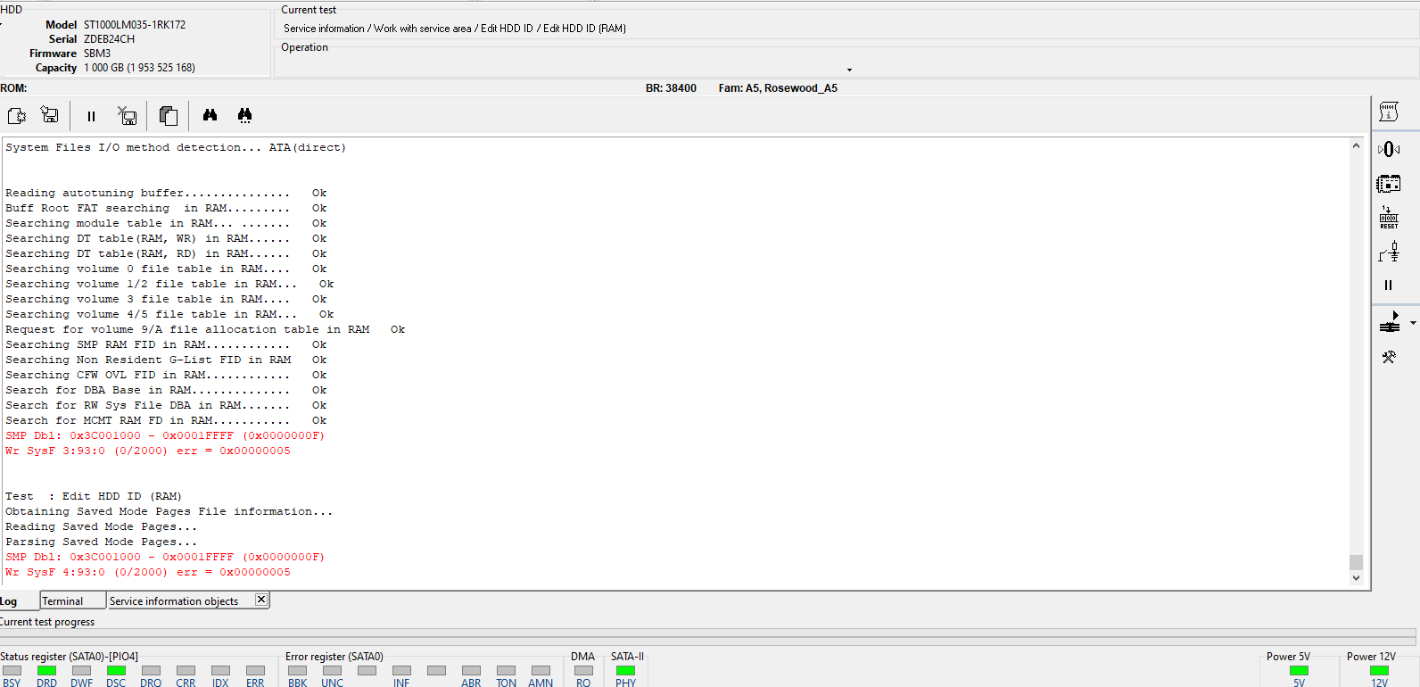

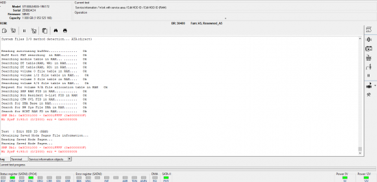

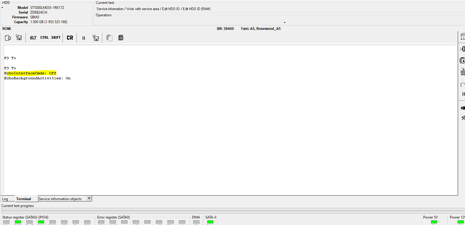

I have always noticed that after patching rom my rosewood disks become busy & after unlocking (while entering in utility) they show ID. I do not know the reason.
I am trying to disable reallocation on this but getting error tried both ways but getting same error.
What could be the reason.
I am trying to do it by issuing command set (by fzabkar) but not been able to do so as well.
Can someone pls. help
F"READ_SPARING_ENABLED",0,22
F"WRITE_SPARING_ENABLED",0,22
F"OFFLINE_SPARING_ENABLED",0,22
F"DAR_ENABLED",0,22
F"DISABLE_IDLE_ACTIVITY",1,22
F"BGMS_DISABLE_DATA_REFRESH",1,22
F"ABORT_PREFETCH",1,22
F"READ_LOOKAHEAD_DISABLED_ON_POWER_UP",1,22
F"READ_CACHING_DISABLED_ON_POWER_UP",1,22

Issue resolved Head 0 is weak & in failing state , is there anyway I can do something in PC3K for head 0
Read speed is 0k/s ~ 200 kb/s varying randomly . Is there anyway to check whether this speed is for few zones & might improve later (defective or weak zones)
 Post subject: Re: Unable to disable reallocation Rosewood ST1000LM035
PostPosted: September 8th, 2024, 9:15
Posts: 1321
Sub map by head and then select whatever chain you like - alternatively user the stop after x failures to skip to the next chain.
