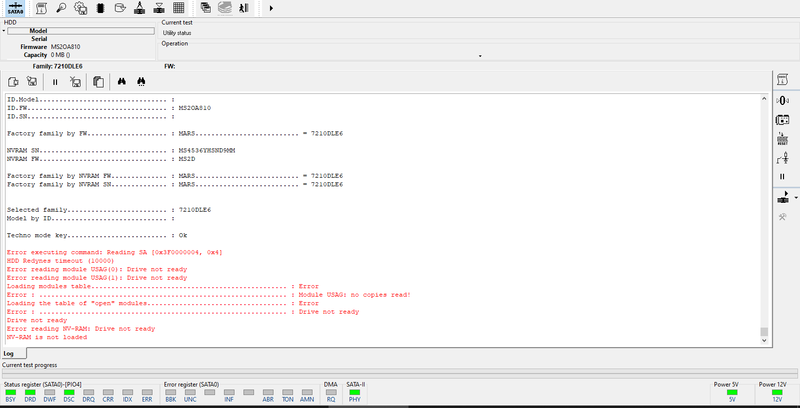

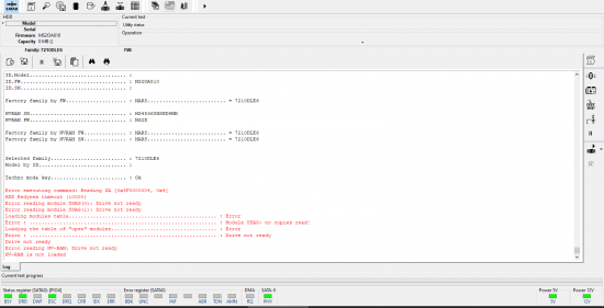

Toshiba DT01ACA100 ( Hitachi ARM ) is having no spin & is getting detected as 0mb with no model no & SN bu showing FW.
What could be the issue ? Is this FW or head related issue.
Can someone pls. comment. Thank you

PUIS is enabled.

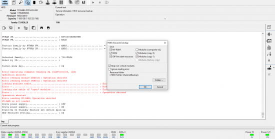

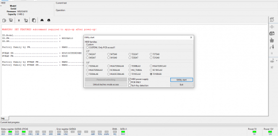

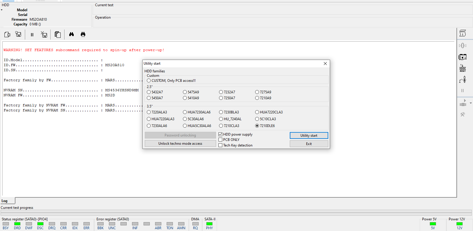

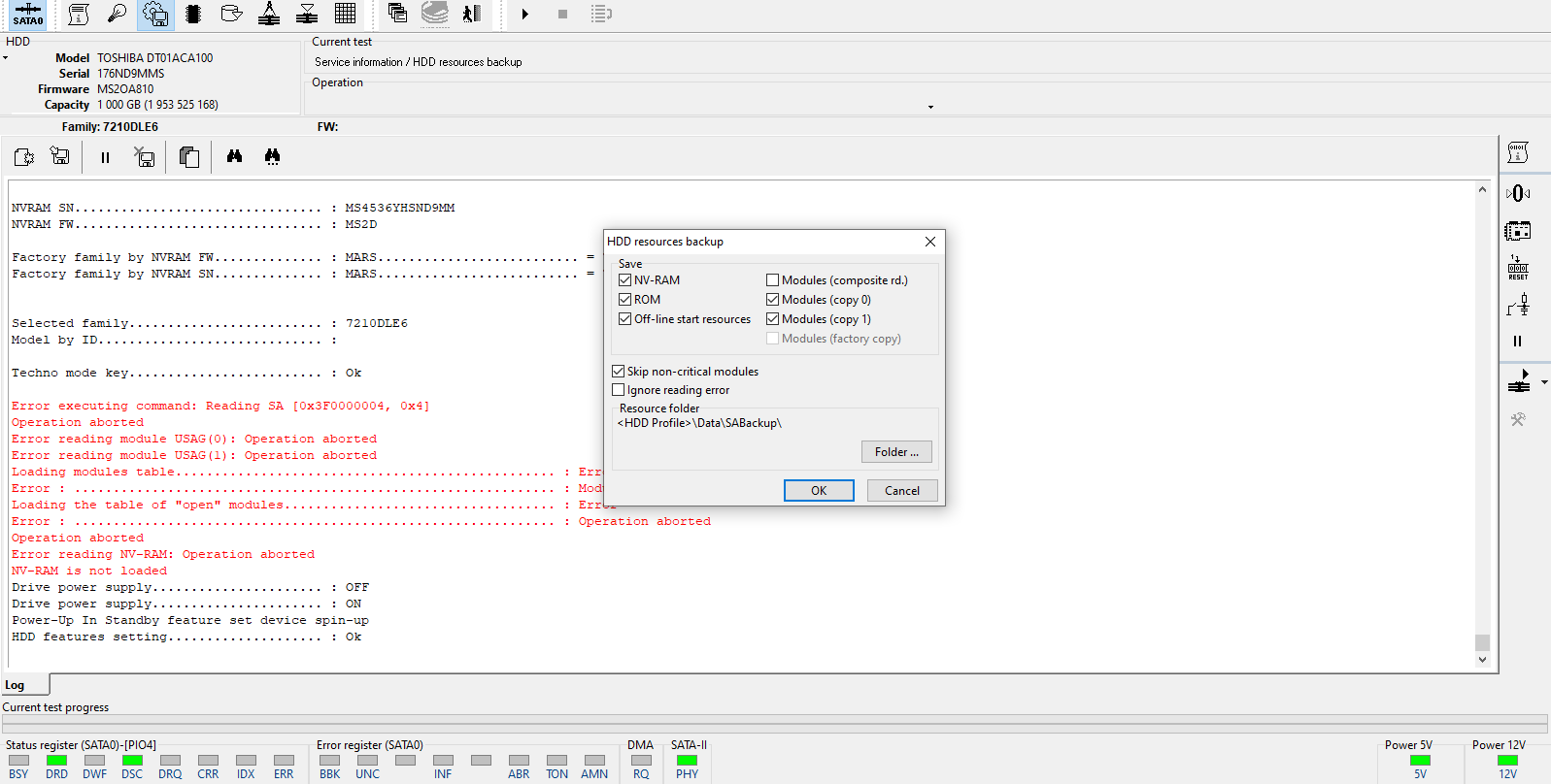

PUIS is enabled.
Thanks a lot fzabkar :D :good:
In a second drive started to get ready. I was about to give a quotation for head transplant
you saved a job & a customer too.
