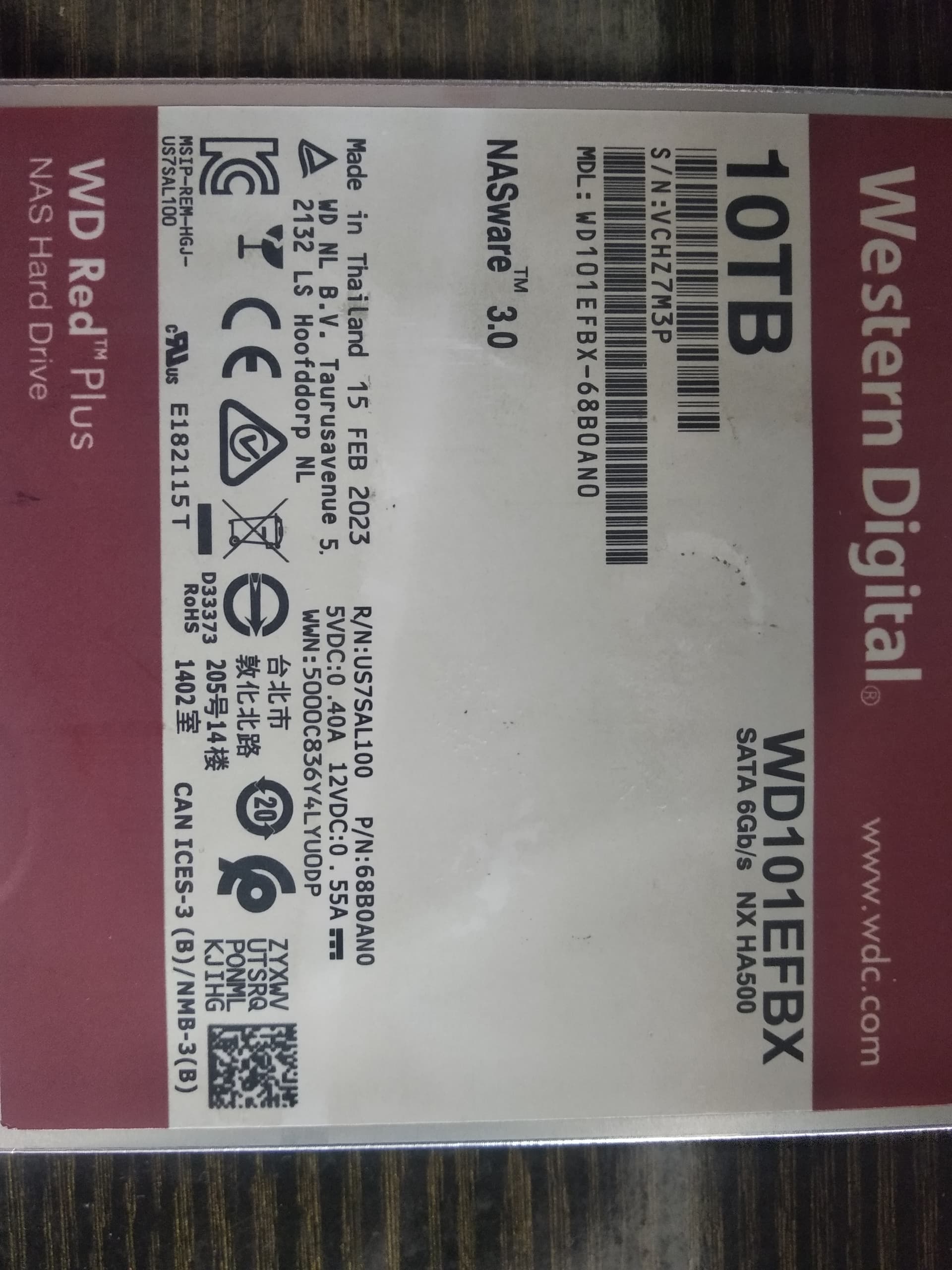

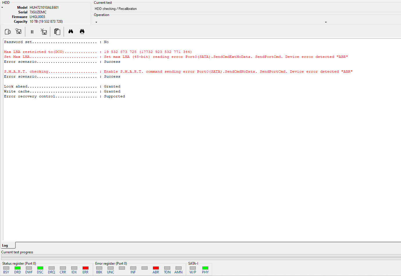

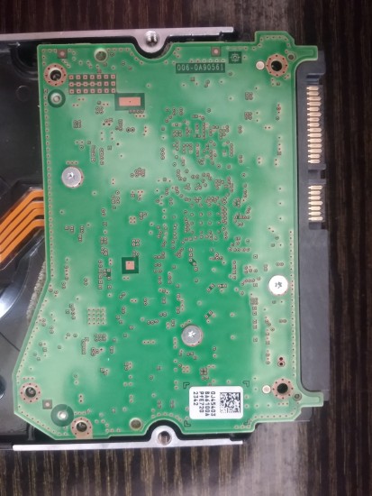

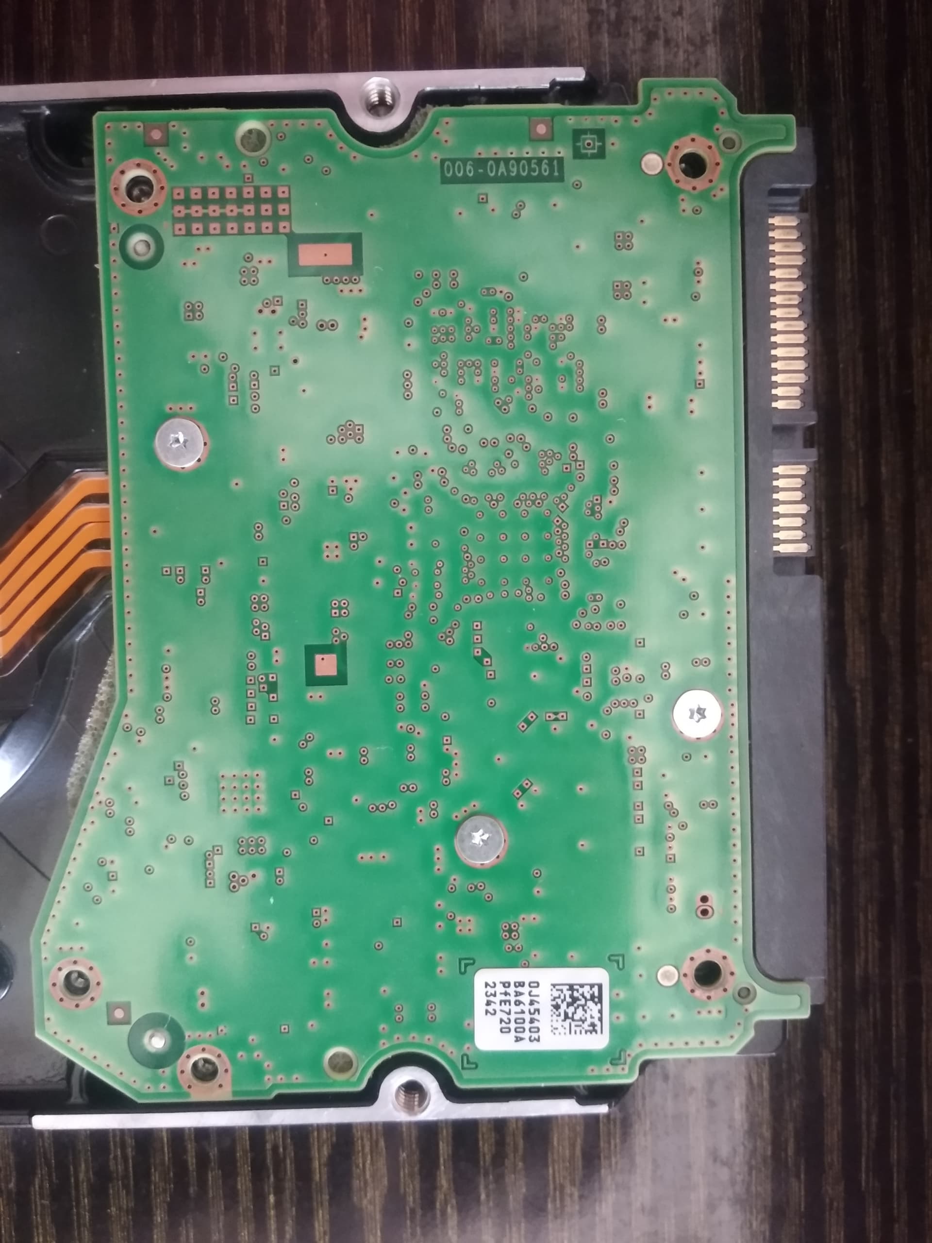

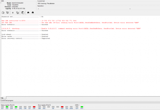

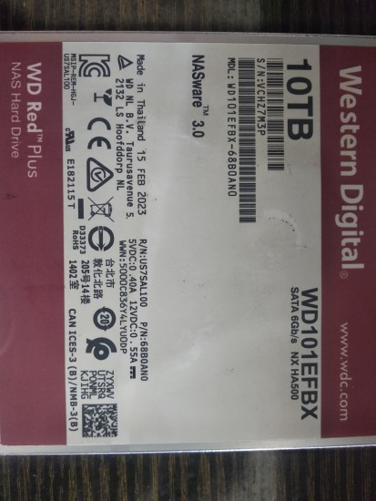

can anyone help me with this HDD
as you can see in the attached photo it can be identified but when i try to read sectors it give ABR ERR and also i can't identify the family

pc3000 does not have support for these drives.
Zero Alpha: zeroalpha.com.au
 Post subject: Re: WD RED 10T HUH721010ALE601
PostPosted: September 16th, 2024, 21:12
Posts: 17328
https://support-en.wd.com/app/warrantystatusweb
VCHZ7M3P
WD101EFBX-68B0AN0
WDVLA
7200
256M
SATA3
6GB/S
10TB
12HD
RED PLUS HGST
