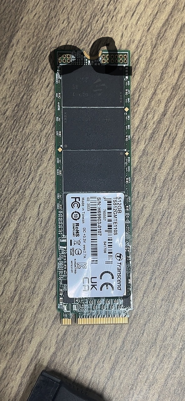

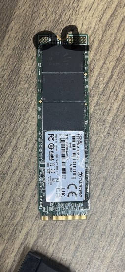

Isn't the circled part a safety mode short?
Safe mode is not entered.
Is there anyone who can tell me what it is?

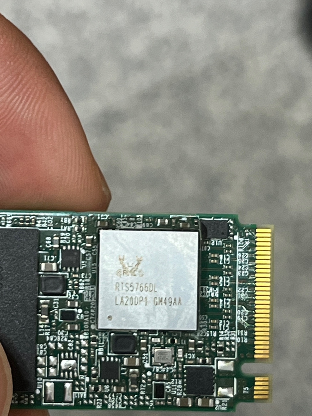

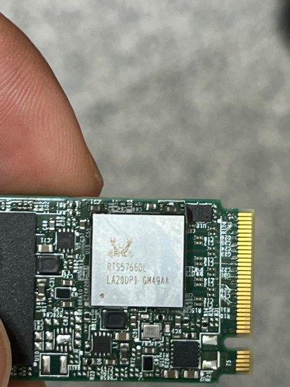

What is the controller in this drive?
 Post subject: Re: SSD Safe Mode Issue
PostPosted: October 6th, 2024, 21:38
Joined: June 3rd, 2024, 0:06
Posts: 26
Location: 대한민국 서울특별시 송파구 문정동 96-6
This
Do I need to remove the gray plate?
