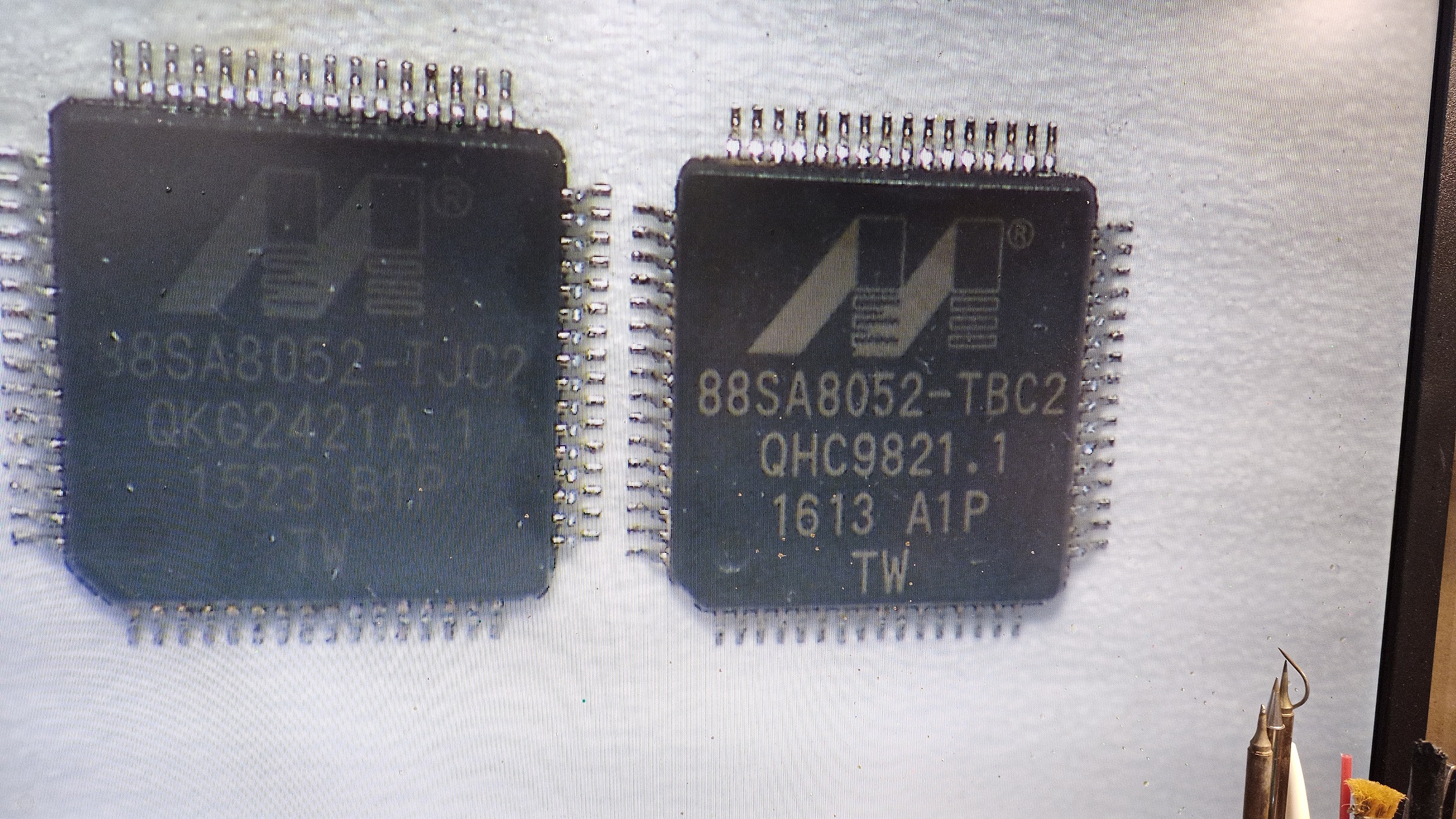

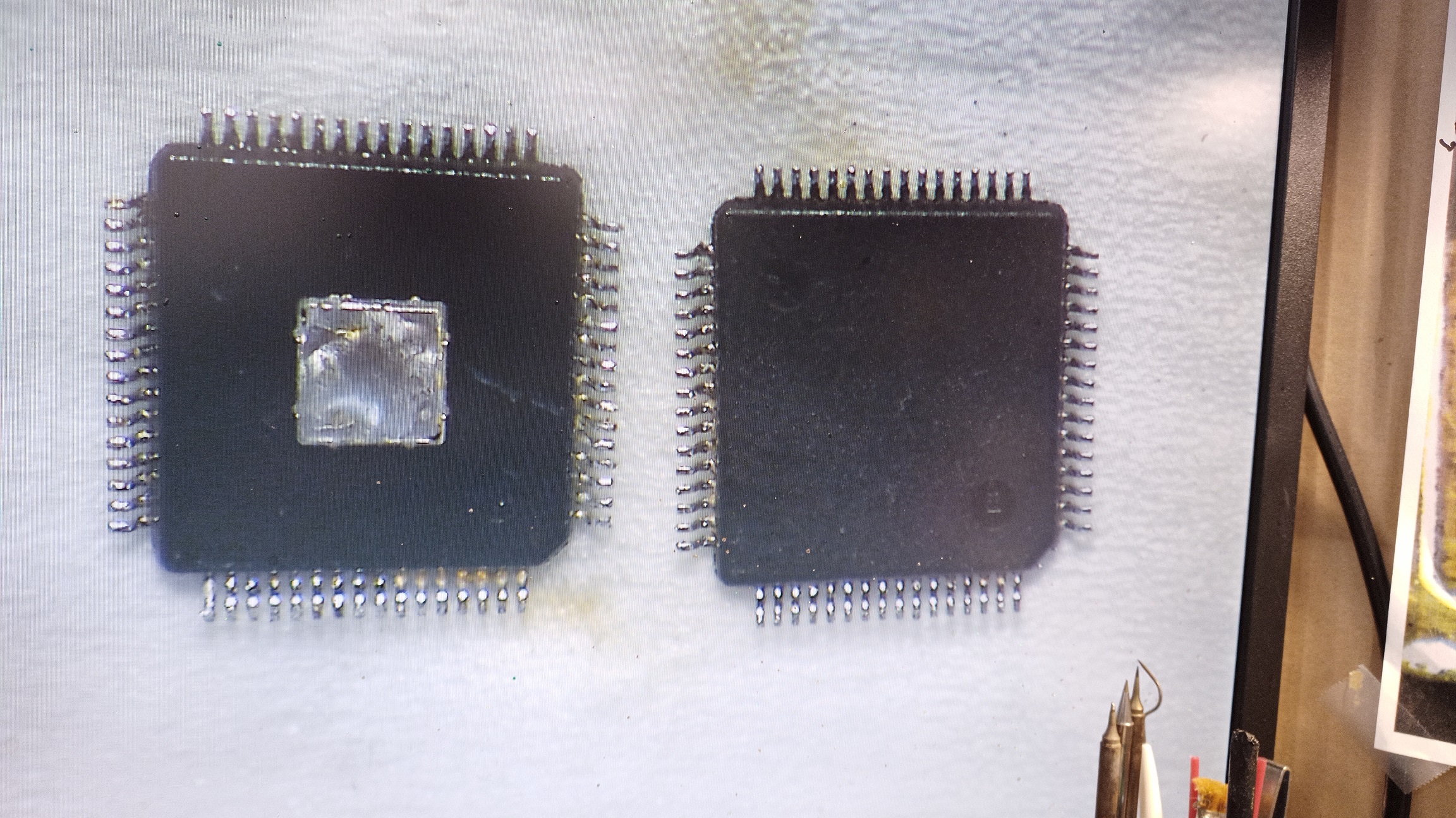

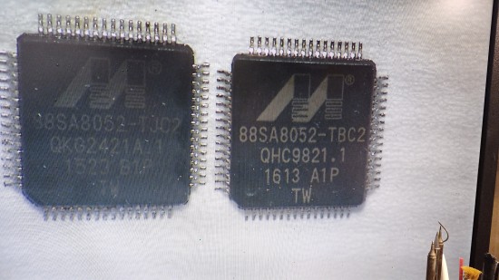

i just noticed the IC that i replaced is different....... my bad! cant find a compatible IC "the one in the LEFT" is the original chip!

The difference is in the package code (TBC versus TJC):
https://www.hddoracle.com/download/file.php?id=5485&mode=view
In fact, Ace Lab recommends the JMicron 20330 IDE-SATA bridge.
https://www.hddoracle.com/viewtopic.php?p=24565#p24565

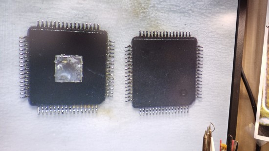

the JMicron 20330 has no soldering point on the back side! is same with the TBC version that i bought! iv already tested the other components on the board with the multimeter !and compared with another pc-3000! they measure correctly!

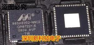

that is why im pretty sure the problem is the 88SA8052-TJC2 controller! but i cant find it on sale on aliexpress! what about the 88sa8052-nnc2 ? is suitable? looks similar

I saw the -NNC2 version in my searches. I don't have a datasheet, but I'm guessing its pinout would be identical. I really don't see how the extra heat sinking would make a difference, though. If you're worried, you could glue a heatsink to the top of the IC.
Be aware that there are a lot of fakes at Aliexpress.

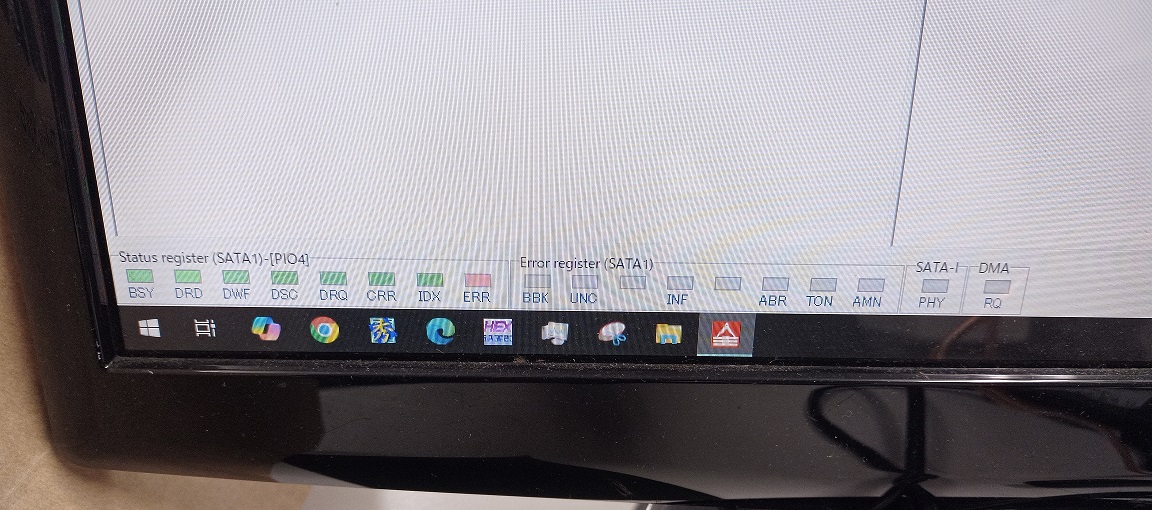

thank you for your super fast answer! i tought the soldering point on the back side of the chip are some sort of "grounding"

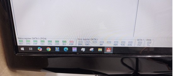

the drive spins but on the pc-3000 utility STATUS REGISTER status it looks like nothing is connected

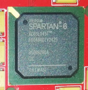

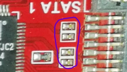

I'm wondering whether the problem is in this IC:
Alternatively, maybe one of the SATA Tx/Rx coupling capacitors is open? You could test this by shorting the ends of each capacitor with tweezers. (However, you mustn't do this if you have also removed the same capacitors on your USB HDD, for example.)

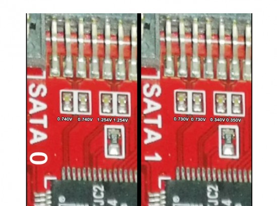

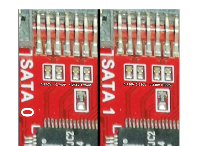

Sir thank you for your patience.... actually the capacitors of SATA 0 and SATA 1 give me different values
