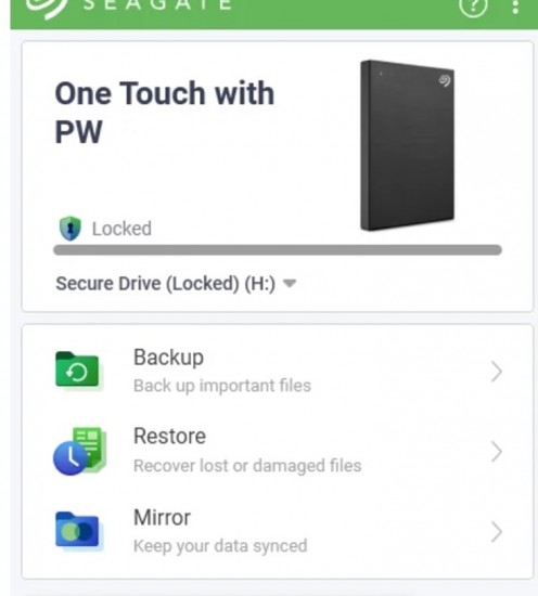

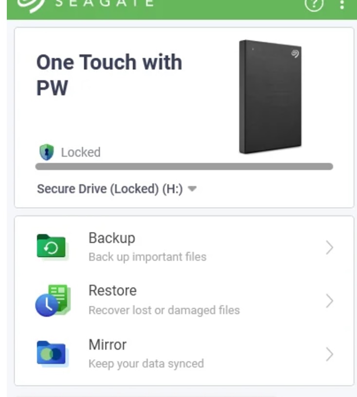

The problem drive is a Seagate ST1000LM038 in external case "UltraTouch Backup Plus drive".
Without the USB-adapter the drive looks like no physical problems. I can read all sys files, modules and user data sectors but the drive is locked over the USB-adapter.
If I don´t use the USB-adapter I see one 6MB partiton with software and the full rest are only "00". I order an identical drive and make new encryption on the doner drive and put data on it.
If you unlocked the doner drive you can see all data and a hex editor show you hex data in the user data area. If the drive is locked or you don´t use the USB-adapter you see one 6MB partition with software and the rest are onyl "00".
This drive have problem with the unlock function (see the picture) I can not unlocked the drive.
Seagate must use for this drive a hardware encryption. "https://www.seagate.com/de/de/support/external-hard-drives/portable-hard-drives/backup-plus-ultra-touch/".
Anyone an idea?

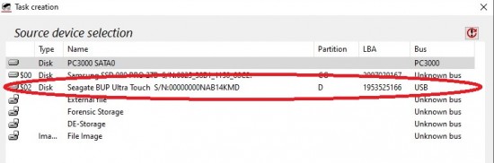

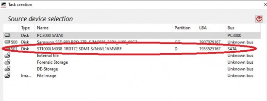

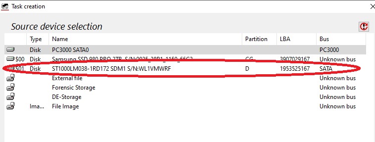

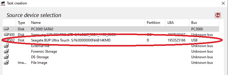

I check sector counts with unlocked over USB-adapter and on SATA direct (locked),
only one is the different (pls see attachment).
I can SA only check on SATA direct (locked) because SA reading is only possible in "Tech Mode" (Patch) and what do you mean with "USB flash memory"?

Sorry, I meant the 8-pin serial flash memory ("ROM") on the USB-SATA bridge PCB.
It looks like the bridge firmware is reporting one less sector, so perhaps there is something in that last sector.
