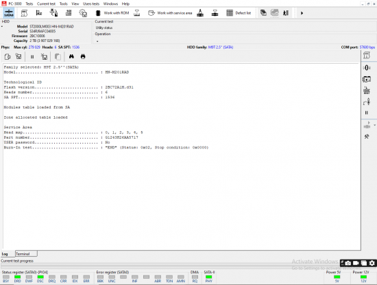

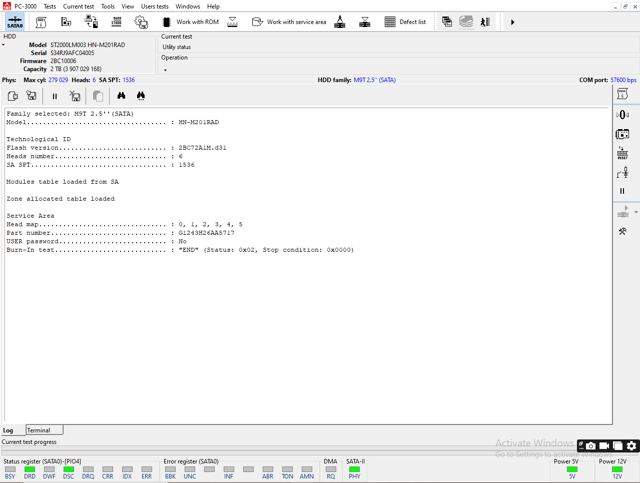

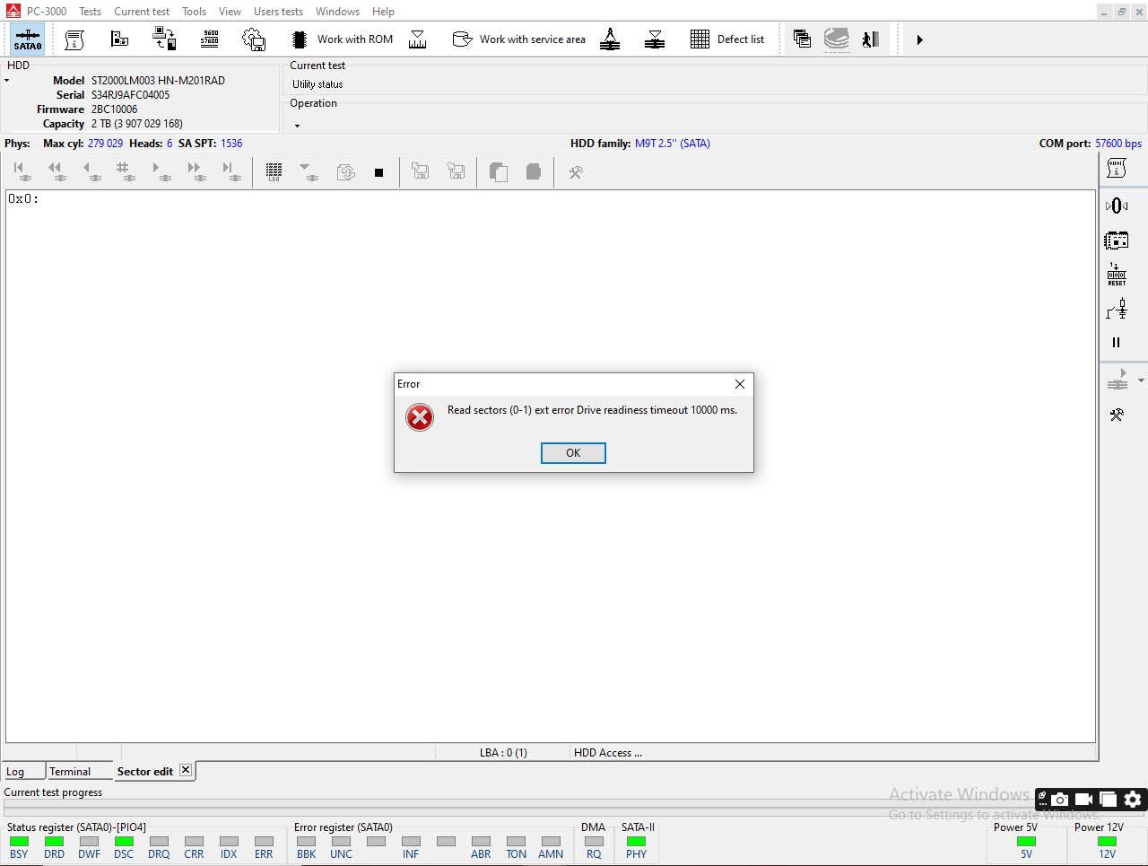

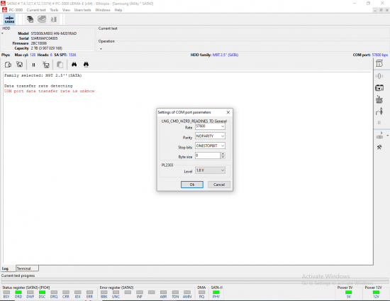

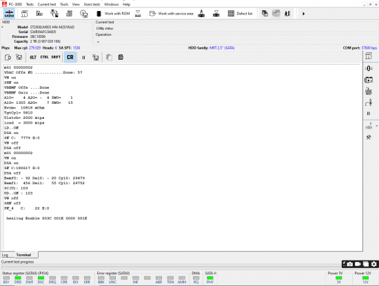

Hello everyone, I Received Samsung spin point drive, So in PC300k it gets to DRD DSC, Keeps spinning but when i tried to access the sectors it shows error, I attached the screenshot, please advise.
Thanks.

Hi ,
Please share Terminal report connect com port to hdd ,This is a 3 platter 6 heads hdd little fatter side

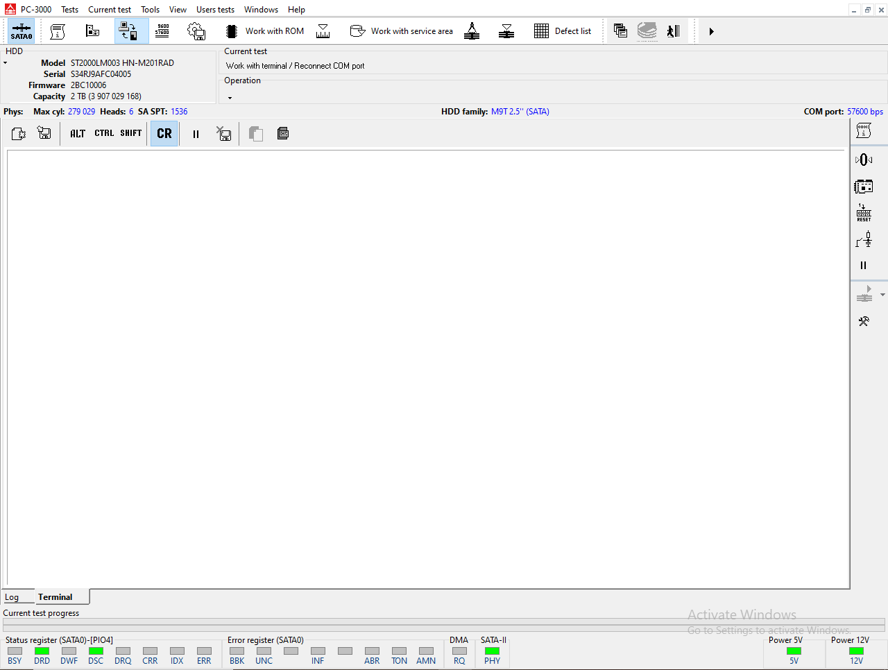

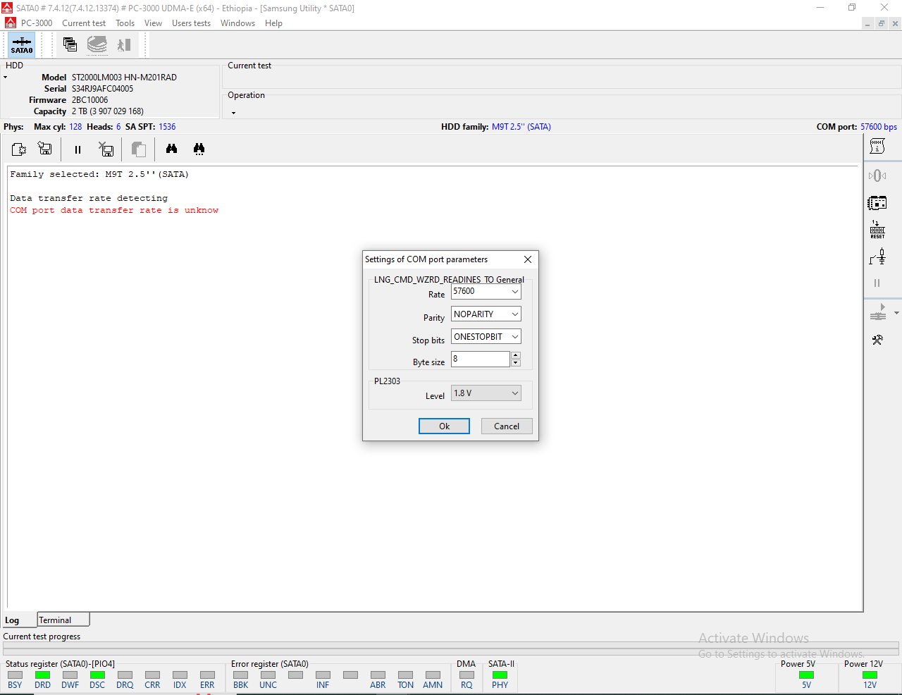

Thanks for your support Amarbir, In terminal report there is no information. Screenshot attached.
 Post subject: Re: Sector edit doesn't Access
PostPosted: December 18th, 2024, 2:35
Well,
this means something is wrong in your connection to hdd

hi Amarbir, I checked the connection in other drives, and they worked well, but this drive gets to utility in Samsung family, any advise please?

What voltage did you select for your terminal adaptor?

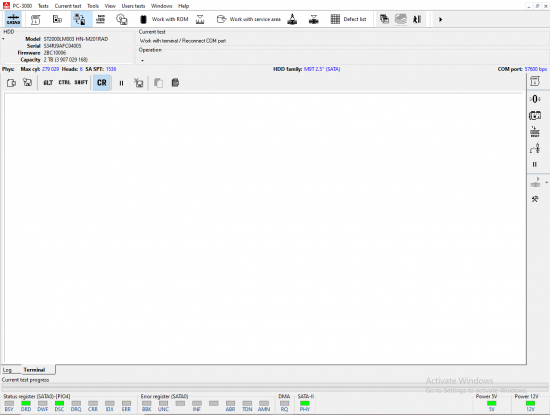

Sadly I don't know the Voltage, but when I tried to access the family automatically, it detected in Samsung spin point family, I used Seagate terminal adaptor, I attached the screenshot if it helps, thank you for your support guys
PostPosted: December 20th, 2024, 9:20
Joined: November 3rd, 2023, 7:57
Posts: 53
Try your Samsung adaptor instead of the Seagate one. The drive you are using is a Samsung with a Seagate badge.

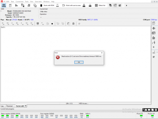

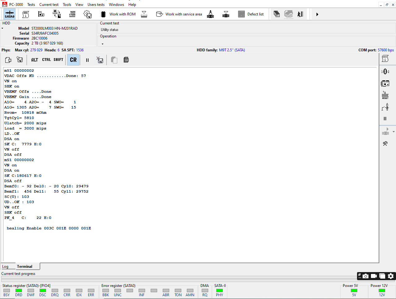

Hi everyone, I used Samsung adaptor, and now the Terminal report is shown, screenshot attached. Please advise.
Thanks.
PostPosted: December 21st, 2024, 4:55
Posts: 4816
:) yeah, the samsung adaptor of course :)
pls save the terminal data to a txt right from powerup up to reading the sectors and attach here.

Doesn't "healing" suggest that the drive is having trouble reading the SA? Would a resource dump or SMART report reveal anything?

that msg is pretty much usual as far as i recall.
Smart report would be definitely useful, but in the initial post we see the drive goes bsy, i wonder if it stays like that forever or gets ready after some time and mainly, WHAT'S ON TERMINAL in the meantime.

X32:01441.4.000|0001 2A00 L000000000 r:3340 p0001 s0000 l0000 0000/0001
AP:2 C: 7691-> 7691 H:4->4 AP Cnt: 6
UF4 1VE
SK C: 8468 H:5
SR:0
AP:1 C: 8468-> 7691 H:4->4 AP Cnt: 6
SK C: 7277 H:4
ExTm4SR: 13
X42:01441.4.000|0001 2A00 L000000000 r:3340 p0001 s0000 l0000 0000/0001
DFF___
FSA___
id:0, st:1_itic,9,266,-100
id:0, st:1_itic,21,264,100AP:2 C: 7691-> 7691 H:4->4 AP Cnt: 6
UF4 1VE
SK C: 8084 H:5
SR:0
AP:1 C: 8084-> 7691 H:4->4 AP Cnt: 6
SO_1
DSA off
UD..OK : 12
VN off
SHK off
PK_4 C: 0 H:4
VDAC Offs K0 ............Done: 49
VN on
SHK on
VBEMF Offs ....Done
VBEMF Gain ....Done
A1O= 5 A2O= - 4 SWO= - 7
A1G= 1327 A2G= 7 SWG= 28
Rvcm= 10960 mOhm
TgtCyl= 5810
Ulatch= 2000 mips
Load = 3000 mips
LD..OK
DSA on
UF 3 1stGrayErr Hd:4
DSA off
UD..OK : 28
VN off
SHK off
PK_3 C:262103 H:4
VN on
SHK on
VBEMF Offs ....Done
VBEMF Gain ....Done
A1O= 4 A2O= - 4 SWO= 9
A1G= 1332 A2G= 7 SWG= 2
Rvcm= 10993 mOhm
TgtCyl= 5810
Ulatch= 2000 mips
Load = 3000 mips
LD..OK
DSA on
SK C: 7790 H:5
SR:1
AP:2 C: 7790-> 7691 H:4->4 AP Cnt: 7
UF4 1VE
SK C: 8635 H:5
ExTm4SR: 1003
X5B:01441.4.000|0001 2A00 L000000000 r:3340 p0001 s0000 l0000 0000/0001
SR:0
AP:1 C: 7691-> 7691 H:4->4 AP Cnt: 7
UF4 1VE
SK C: 9848 H:5
ExTm4SR: 18
X5C:01441.4.000|0001 2A00 L000000000 r:3340 p0001 s0000 l0000 0000/0001
AP:2 C: 9848-> 7691 H:4->4 AP Cnt: 7
SK C: 10868 H:5
SR:0
AP:2 C: 10868-> 7691 H:4->4 AP Cnt: 7
UF4 1VE
UF 3 1stGrayErr Hd:5
SK C: 7398 H:0
ExTm4SR: 23
X5D:01441.4.000|0001 2A00 L000000000 r:3340 p0001 s0000 l0000 0000/0001
SR:0
UF4 1VE
SK C: 7949 H:5
ExTm4SR: 13
X61:01441.4.000|0001 2A00 L000000000 r:3340 p0001 s0000 l0000 0000/0001
SR:0
AP:2 C: 7180-> 81457 H:4->4 AP Cnt: 7
SK C: 27317 H:4
SR:1
AP:2 C: 27317-> 81457 H:4->4 AP Cnt: 7
SO_1
DSA off
UD..OK : 2
SHK off
PK_4 C: 119 H:4
SHK on
VBEMF Offs ....Done
VBEMF Gain ....Done
A1O= 4 A2O= - 4 SWO= 6
A1G= 1329 A2G= 7 SWG= 19
Rvcm= 10973 mOhm
TgtCyl= 5810
Ulatch= 2000 mips
Load = 3000 mips
LD..OK
DSA on
UF4 1VE
SK C: 6051 H:5
SR:2
AP:2 C: 6051-> 81457 H:4->4 AP Cnt: 8
SK C: 78392 H:4
SR:3
AP:1 C: 78392-> 81457 H:4->4 AP Cnt: 8
DSA off
UD..OK : 19
SHK off
PK_1 C: 4040 H:4
SHK on
VBEMF Offs ....Done
VBEMF Gain ....Done
A1O= 4 A2O= - 4 SWO= 10
A1G= 1331 A2G= 7 SWG= 13
Rvcm= 10986 mOhm
TgtCyl= 5810
Ulatch= 2000 mips
Load = 3000 mips
LD..OK
DSA on
UF4 1VE
DSA off
UD..OK : 13
SHK off
PK_3 C: 6 H:4
SHK on
VBEMF Offs ....Done
VBEMF Gain ....Done
A1O= 4 A2O= - 4 SWO= 4
A1G= 1330 A2G= 7 SWG= 20
Rvcm= 10980 mOhm
TgtCyl= 5810
Ulatch= 2000 mips
Load = 3000 mips
LD..OK
DSA on
SK C: 7419 H:5
ExTm4SR: 1566
AP:2 C: 7419-> 81457 H:4->4 AP Cnt: 9
UF4 1VE
UF4 1VE
SK C: 63897 H:0
SR:0
AP:2 C: 63897->159041 H:4->4 AP Cnt: 9
UF4 1VE
SK C: 78736 H:5
SR:1
AP:1 C: 78736->159041 H:4->4 AP Cnt: 9
UF4 1VE
SO_1
AP:3 C: 78736-> 86786 H:4->4 AP Cnt: 9
DSA off
UD..OK : 20
SHK off
PK_4 C: 56 H:5
SHK on
VBEMF Offs ....Done
VBEMF Gain ....Done
A1G= 1331 A2G= 7 SWG= 22
Rvcm= 10986 mOhm
TgtCyl= 5810
Ulatch= 2000 mips
Load = 3000 mips
LD..OK
DSA on
SK C: 7988 H:5
SR:2
AP:2 C: 7988->159041 H:4->4 AP Cnt: 10
UF4 1VE
SK C: 37303 H:5
SR:3
AP:2 C: 37303->159041 H:4->4 AP Cnt: 10
DSA off
UD..OK : 22
SHK off
PK_1 C: 14 H:4
VDAC Offs K0 ............Done: 51
SHK on
VBEMF Offs ....Done
VBEMF Gain ....Done
A1O= 4 A2O= - 4 SWO= 14
A1G= 1336 A2G= 7 SWG= - 11
Rvcm= 11019 mOhm
TgtCyl= 5810
Ulatch= 2000 mips
Load = 3000 mips
LD..OK
DSA on
UF4 1VE
SK C: 7339 H:5
ExTm4SR: 1130
AP:1 C: 7338->159041 H:4->4 AP Cnt: 11
UF4 1VE
SK C: 72163 H:5
SR:0
AP:1 C: 72162->248114 H:4->4 AP Cnt: 11
UF4 1VE
UF4 1VE
UF4 1VE
UF4 1VE
UF4 1VE
UF4 1VE
UF4 1VE
UF4 1VE
SK C:144523 H:0
SR:1
AP:1 C:144523->248114 H:4->4 AP Cnt: 11
SK C:140560 H:5
SR:2
AP:1 C:140560->248114 H:4->4 AP Cnt: 11
UF4 1VE
SO_1
AP:2 C:140560->140027 H:4->4 AP Cnt: 11
DSA off
UD..OK : -11
SHK off
PK_4 C: 70 H:5
SHK on
VBEMF Offs ....Done
VBEMF Gain ....Done
A1G= 1333 A2G= 7 SWG= 17
Rvcm= 10999 mOhm
TgtCyl= 5810
Ulatch= 2000 mips
Load = 3000 mips
LD..OK
DSA on
SK C: 8565 H:5
SR:3
AP:2 C: 8565->248114 H:4->4 AP Cnt: 12
DSA off
UD..OK : 17
SHK off
PK_1 C: 49 H:4
VDAC Offs K0 ............Done: 57
SHK on
VBEMF Offs ....Done
VBEMF Gain ....Done
A1O= 5 A2O= - 4 SWO= - 12
A1G= 1336 A2G= 7 SWG= - 10
Rvcm= 11019 mOhm
TgtCyl= 5810
Ulatch= 2000 mips
Load = 3000 mips
LD..OK
DSA on
SK C: 1134 H:4
ExTm4SR: 1233
AP:2 C: 1134->248114 H:4->4 AP Cnt: 13
SK C: 1942 H:4
SR:0
AP:2 C: 1942->318333 H:4->4 AP Cnt: 13
UF4 1VE
SK C: 31473 H:5
SR:1
AP:2 C: 31474->318333 H:4->4 AP Cnt: 13
SK C: 32663 H:4
SR:2
AP:2 C: 32663->318333 H:4->4 AP Cnt: 13
UF4 1VE
SK C: 89192 H:5
SR:3
AP:2 C: 89192->318333 H:4->4 AP Cnt: 13
DSA off
UD..OK : -10
SHK off
PK_1 C: 54 H:4
SHK on
VBEMF Offs ....Done
VBEMF Gain ....Done
A1O= 4 A2O= - 4 SWO= 11
A1G= 1336 A2G= 7 SWG= - 6
Rvcm= 11019 mOhm
TgtCyl= 5810
Ulatch= 2000 mips
Load = 3000 mips
LD..OK
DSA on
SK C: 8487 H:4
ExTm4SR: 685
Time(Measure) 4714985
AP:1 C: 8488->318333 H:4->4 AP Cnt: 14
SK C: 17740 H:4
SR:0
AP:1 C: 7591-> 7691 H:2->4 AP Cnt: 14
SK C: 9614 H:4
SR:1
AP:2 C: 9614-> 7691 H:4->4 AP Cnt: 14
SK C: 6464 H:4
SR:2
AP:2 C: 6463-> 7691 H:4->4 AP Cnt: 14
SO_1
DSA off
UD..OK : -6
VN off
SHK off
PK_4 C: 49 H:4
VN on
SHK on
VBEMF Offs ....Done
VBEMF Gain ....Done
A1O= 5 A2O= - 4 SWO= - 4
A1G= 1331 A2G= 7 SWG= 41
Rvcm= 10986 mOhm
TgtCyl= 5810
Ulatch= 2000 mips
Load = 3000 mips
LD..OK
DSA on
DSA off
UD..OK : 41
VN off
SHK off
PK_3 C: 492 H:4
Fault Status : 0004 0000
VN on
SHK on
VBEMF Offs ....Done
VBEMF Gain ....Done
A1O= 4 A2O= - 4 SWO= 13
A1G= 1336 A2G= 7 SWG= - 4
Rvcm= 11019 mOhm
TgtCyl= 5810
Ulatch= 2000 mips
Load = 3000 mips
LD..OK
DSA on
SK C: 9172 H:5
SR:3
AP:1 C: 9172-> 7691 H:4->4 AP Cnt: 15
DSA off
UD..OK : -4
VN off
SHK off
PK_1 C:416153 H:4
VN on
SHK on
VBEMF Offs ....Done
VBEMF Gain ....Done
A1O= 4 A2O= - 4 SWO= 7
A1G= 1335 A2G= 7 SWG= 15
Rvcm= 11012 mOhm
TgtCyl= 5810
Ulatch= 2000 mips
Load = 3000 mips
LD..OK
DSA on
DSA off
UD..OK : 15
VN off
SHK off
PK_3 C: 27 H:4
VN on
SHK on
VBEMF Offs ....Done
VBEMF Gain ....Done
A1G= 1335 A2G= 7 SWG= 18
Rvcm= 11012 mOhm
TgtCyl= 5810
Ulatch= 2000 mips
Load = 3000 mips
LD..OK
DSA on
SK C: 8185 H:5
ExTm4SR: 1985
X63:01441.4.000|0001 2A00 L000000000 r:3340 p0000 s0000 l0000 0000/0001
SR:0
AP:1 C: 7180-> 81457 H:4->4 AP Cnt: 16
SK C: 19118 H:4
ExTm4SR: 15
[DF_TMOUT0:0000:0000]
SR:0
AP:1 C: 81457->159041 H:4->4 AP Cnt: 16
UF4 1VE
SK C: 82919 H:5
SR:1
AP:2 C: 82919->159041 H:4->4 AP Cnt: 16
UF4 1VE
SK C: 81733 H:5
SR:2
AP:2 C: 81733->159041 H:4->4 AP Cnt: 16
SK C: 94638 H:4
SR:3
AP:1 C: 94638->159041 H:4->4 AP Cnt: 16
DSA off
UD..OK : 18
SHK off
PK_1 C:152430 H:4
SHK on
VBEMF Offs ....Done
VBEMF Gain ....Done
A1G= 1336 A2G= 7 SWG= 9
Rvcm= 11019 mOhm
TgtCyl= 5810
Ulatch= 2000 mips
Load = 3000 mips
LD..OK
DSA on
SK C: 3687 H:4
ExTm4SR: 742
SR:0
AP:2 C:159041->248114 H:4->4 AP Cnt: 17
UF4 1VE
UF4 1VE
SK C:229341 H:0
SR:1
AP:2 C:229341->248114 H:4->4 AP Cnt: 17
UF4 1VE
SK C:227644 H:5
ExTm4SR: 47
SR:0
AP:1 C:248114->318333 H:4->4 AP Cnt: 17
SK C:251597 H:4
SR:1
AP:2 C:251597->318333 H:4->4 AP Cnt: 17
SK C:244836 H:4
SR:2
AP:2 C:244836->318333 H:4->4 AP Cnt: 17
SO_1
DSA off
UD..OK : 9
SHK off
PK_4 C: 198 H:4
SHK on
VBEMF Offs ....Done
VBEMF Gain ....Done
A1O= 5 A2O= - 4 SWO= - 5
A1G= 1336 A2G= 7 SWG= 7
Rvcm= 11019 mOhm
TgtCyl= 5810
Ulatch= 2000 mips
Load = 3000 mips
LD..OK
DSA on
DSA off
UD..OK : 7
SHK off
PK_3 C: 73 H:4
SHK on
VBEMF Offs ....Done
VBEMF Gain ....Done
A1O= 4 A2O= - 4 SWO= 15
A1G= 1335 A2G= 7 SWG= 17
Rvcm= 11012 mOhm
TgtCyl= 5810
Ulatch= 2000 mips
Load = 3000 mips
LD..OK
DSA on
SK C: 8056 H:5
SR:3
AP:2 C: 8056->318333 H:4->4 AP Cnt: 18
DSA off
UD..OK : 17
SHK off
PK_1 C: 55 H:4
SHK on
VBEMF Offs ....Done
VBEMF Gain ....Done
A1G= 1337 A2G= 7 SWG= 7
Rvcm= 11025 mOhm
TgtCyl= 5810
Ulatch= 2000 mips
Load = 3000 mips
LD..OK
DSA on
UF4 1VE
UF 3 1stGrayErr Hd:0
UF 3 1stGrayErr Hd:1
UF 3 1stGrayErr Hd:2
UF 3 1stGrayErr Hd:3
AP:2 C: 8056-> 2654 H:4->4 AP Cnt: 19
DSA off
UD..OK : 7
SHK off
PK_3 C: 287 H:0
SHK on
VBEMF Offs ....Done
VBEMF Gain ....Done
A1G= 1340 A2G= 7 SWG= - 18
Rvcm= 11044 mOhm
TgtCyl= 5810
Ulatch= 2000 mips
Load = 3000 mips
LD..OK
DSA on
SK C: 8296 H:1
ExTm4SR: 2212
Time(Measure) 3075333
AP:2 C: 8296->318333 H:4->4 AP Cnt: 20
UF4 1VE
SK C: 42898 H:5
[GL][ADD:000000000][C:0008][E:1140]
[CACH_ER:1140 @LBA:000000000]
Successful writeRList
[GL][SAVE]
VN off
DSA off
mS1 00000002
VN on
DSA on
SK C:178397 H:0
DSA off
Bemf0: - 76 Del0: - 11 Cyl0: 29611
Bemf1: 374 Del1: 71 Cyl1: 30537
SC(U): -82
UD..OK : -82
VN off
SHK off
PK_4 C: 2 H:0
Here are all the terminal report, resource dump or SMART report doesn't reveal anything, it stays ready after some time after traying to read the sectors. So is there any chance to get the user data on this case?
