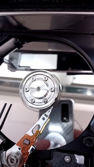

 Post subject: Seagate ST340014A plattar scratches ..advices please
PostPosted: December 19th, 2024, 21:17
Joined: November 28th, 2021, 22:35
Posts: 162
Location: japan
hello iv got this drive with scratch on the platter is that scratch the service are? is there any head comp for it? does someone had the same situation?
 Post subject: Re: Seagate ST340014A plattar scratches ..advices please
PostPosted: December 19th, 2024, 23:34
Posts: 487
Common problem and the service area does looked scratched. Ofcourse there is head tools for it. Looks like old .7 Seagate will depend on condition of all SA regions.

sorry for my bad english Sir... i mean a tool to skip the scratches
PostPosted: December 20th, 2024, 4:18
Posts: 4850
the ring at ID could be skipped, but the other one is very probably at the SA, which would make it no-go...
